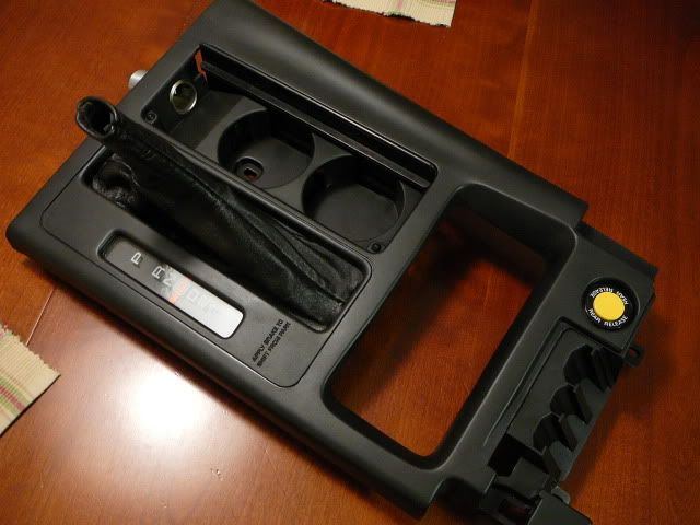

yes, by natural, I mean no finish at all. I did a couple threads a few years ago about stripping dulso, and I refinished with no finish. here's a pic of the finished console in my 96 coupe -
it was not a 100% perfect match to the dulso, but pretty damn close. as far as peeling, chipping, scratching, etc., there was nothing to worry about. if it ever took a beating, a quick once over, and it would be good as new.
