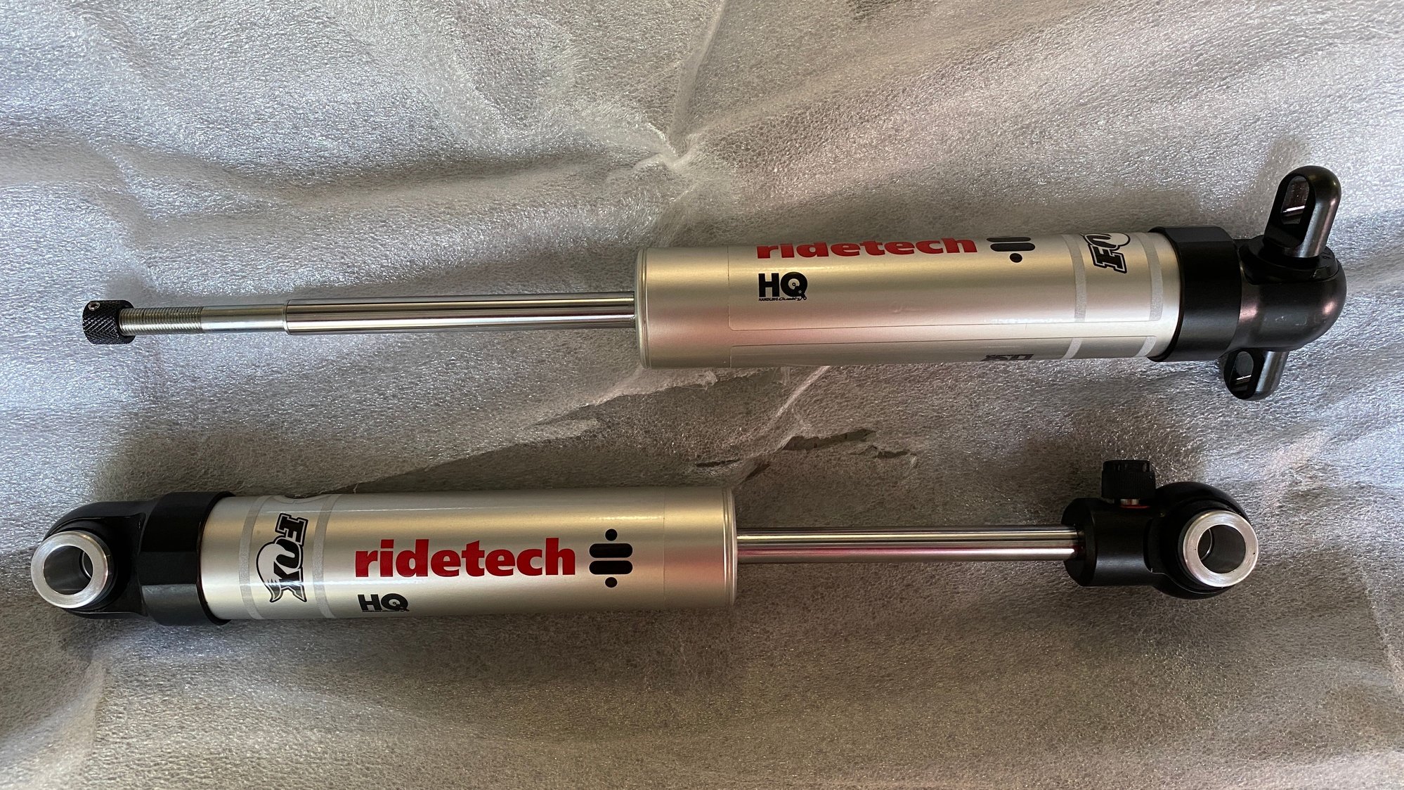

So I did a pretty big thing, new Ridetech HQ shocks should arrive tomorrow and I'll hopefully have them installed quickly. Its about time the 136,000 mile original Bilsteins get replaced. I'll update when they're on and let everyone know how they are for the early C4

So I probably have around 500 miles on the new Ridetech HQs. I began with their suggested setting which was firm but not too crazy. It handled bumps in the road and cornering great, no drama involved. Two weeks ago I adjusted them for a softer ride. Accessing the fronts to do so is not an issues, however the rears take a little more work. Jacking the car up gives more room to reach in but removing the rear wheels is certainly the easiest. The adjustment was 4 clicks and makes a huge difference. It still corners great as a corvette should and rides very nicely. I would definitely recommend the HQs for someone looking to replace or upgrade shocks. When I autocross next year I will post more on them.
Next project to tackles is the glass top. The frame and plastic separated on the passenger's side so I bought SikaFlex as recommended on other threads and will try to fix it myself. As of now the plan is to separate it fully, clean, then reattach and hope for the best. I've got the fiberglass top on now.
I have been very happy with the Ridetech shocks so far. I have an 85 Z51 and I went one click firmer than recommended. It is a firm ride but I no longer scrape the front spoiler in large dips at speed. My Bilsteins were still usable and still had some gas in them, but these Ridetech shocks were a night and day change. I have a set of aftermarket 5 spoke wheels so I can make adjustments on the side of the road without much effort.

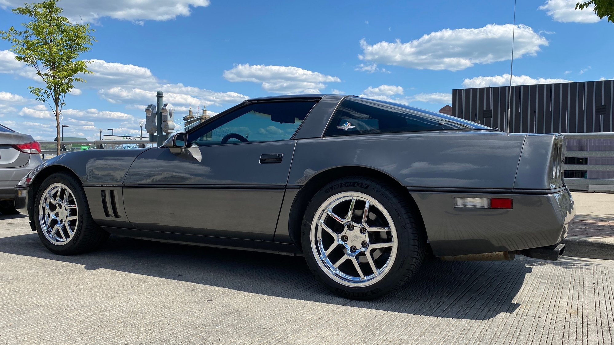

The car now has new injectors, wheels and tires. I found Z06 Speelines and put Michelin Pilot Sport All Seasons on them. The car runs better than ever and looks better than ever. Next step is to put the new seat cushions/mounted covers in
