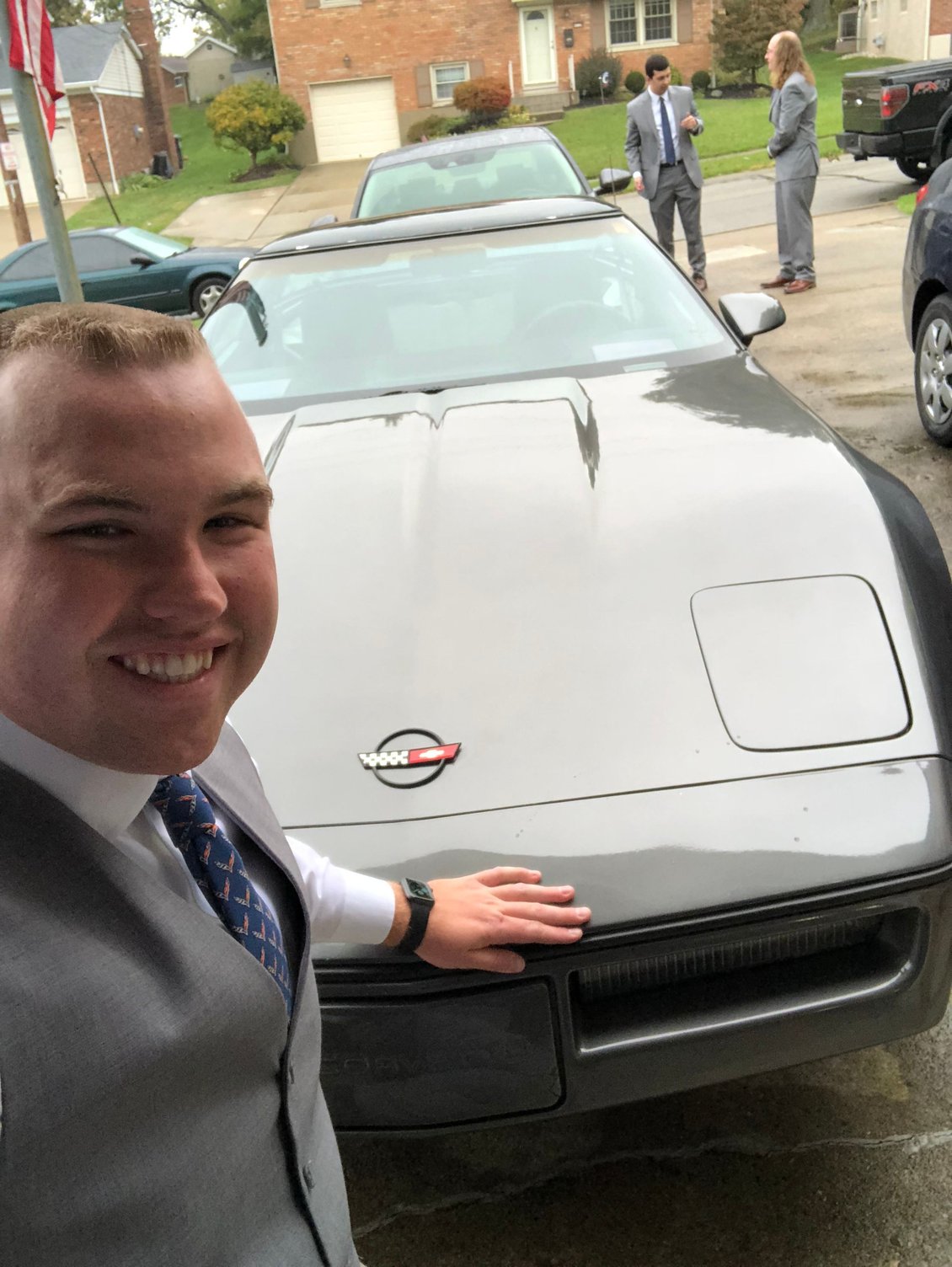

So luckily the car was finished in time to use in my wedding as the getaway car. It was a little chilly with the heater core bypassed and rainy out, but it ran perfectly.
