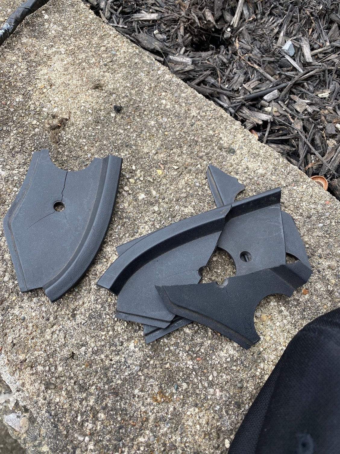

So I've managed to knock a few things off my 2019 list above. The acrylic top has been resealed to the best of my ability without separating the frame from it. It works a little bit better, less wind noise for sure. Dash pad and speakers were installed. During this process while unhooking the battery, I managed to contact the wrench with the frame brace coming from the cowl. End result: a new MAF, PCM, and fuel pump. Columbia Chev was helpful with this because I did not have the ability or patience to diagnose it correctly at the time. The speaker covers are a little disappointing in how they warp with heat. But the dash pad with the speakers was so hard to install that they're staying nice and warped for the foreseeable future. I've got the A/C blowing cold and the parts to fix the door locks and window motor on that driver side. But...that will have to wait because this past friday, the water pump locked up on my 12 minute drive to work. Temps hit 265 when I both realized it and shut it down. Since then, it has been towed to Brogan & Folz who installed the engine to replace the part under warranty.
Some positives: In the last couple months, I took it on a stage of Power Tour and drove to Indianapolis Motor Speedway for cars and coffee. I had no issues each time during those trips. I've been cruising all over with it and having a blast. I also just got a fiberglass top for it. It will need seals, paint, and a headliner. If anyone is around at the Cincinnati Cars and Coffee events, feel free to check it out or say hey.
