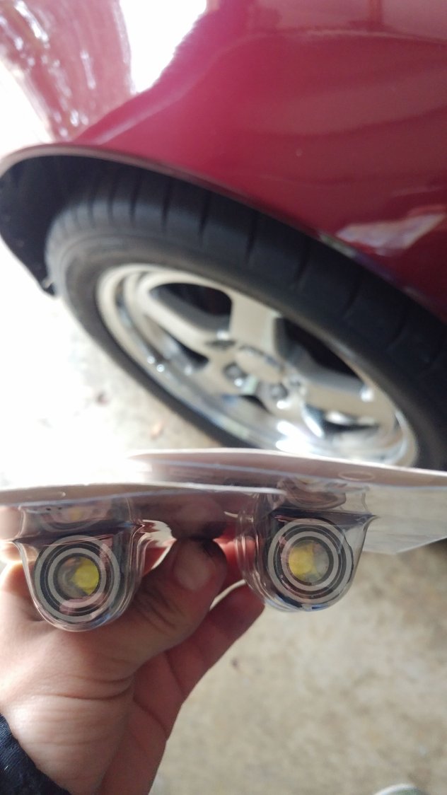

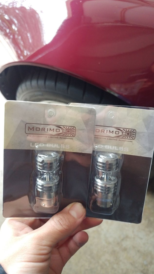

I would install HID's if you actually want them to be bright. Bought these for the cornering lights, and they don't light up. I twist them into place and all, no worky.
