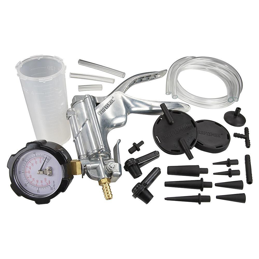

the Craftman 20930 in particular!!! one man vacuum & bleed kit. is bar NON...

I did the one man process and then used a vacuum pump.
