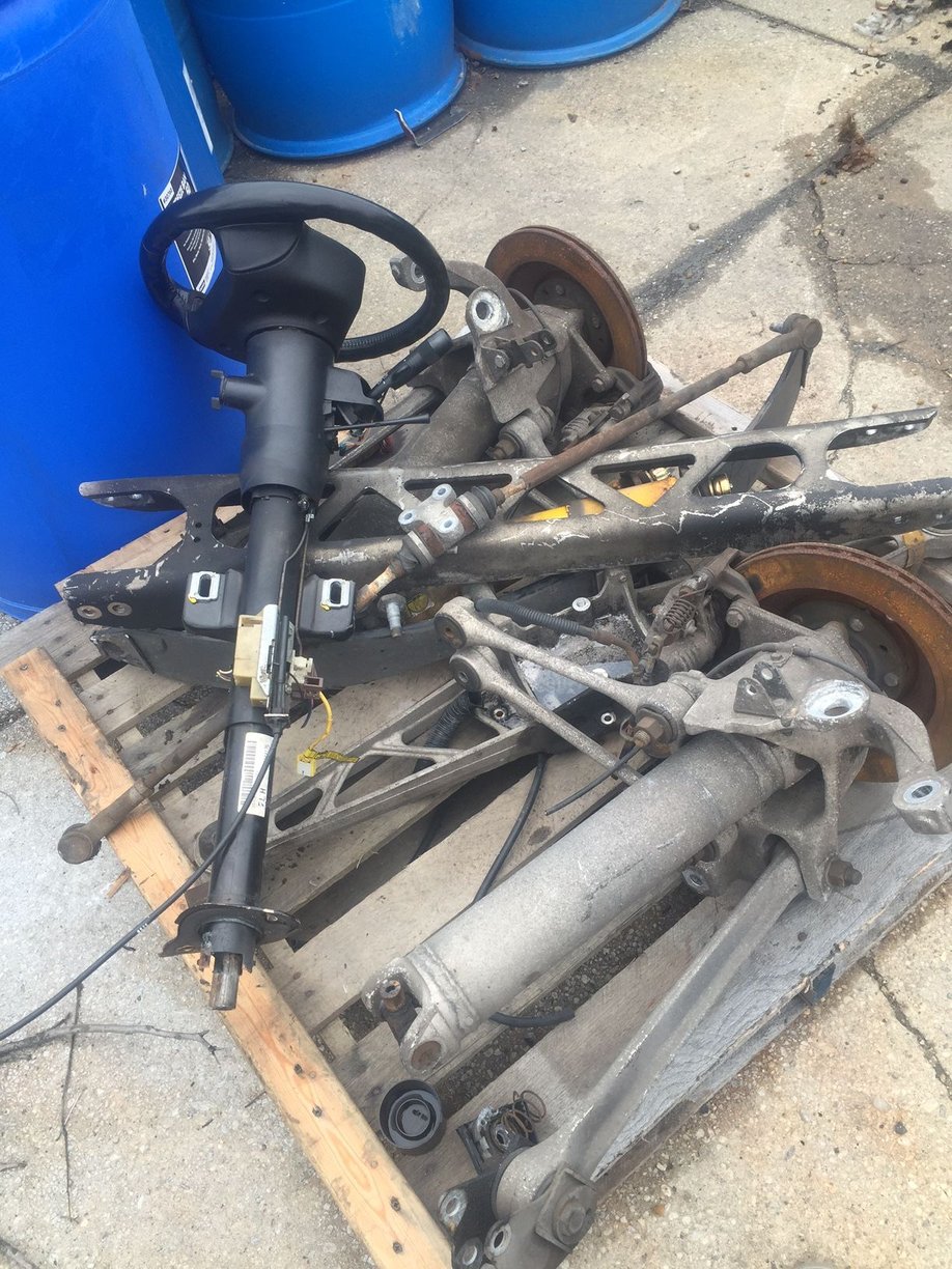

new MT steering column b4 it went in

Why did you switch the steering column?

Nice build thread. What flywheel/clutch setup are you going to go with? BTW I changed the column also when I did the swap, figured with everything else out of the car it was it was easier to swap it than redoing the ignition switch for the manual's lock out.

I Changed the column due to wear and VATS being inoperable. Down the Line it will just act as a wheel unlock and will be a push button start. My choice of clutch will be a Hays Dragon Claw Twin Disc Most Likely. Will decide that last. Would Like to have a high Revving stroker motor.
