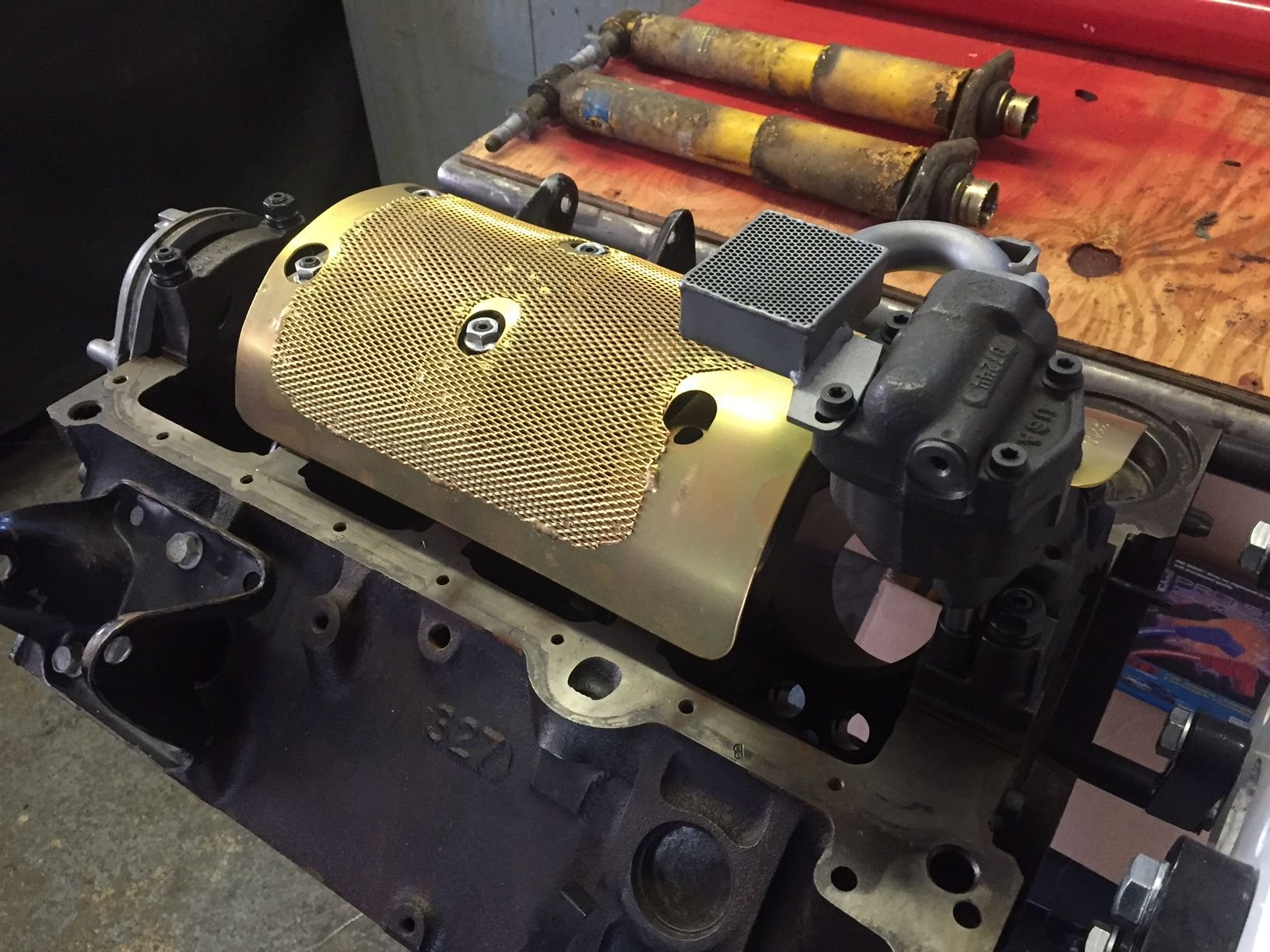

heres the engine in the my shop. Just test fitting a few minor things. Got a Melling 10552HV and a Kevko pickup tube. Waiting for the Kevko 1092RR pan to come. Also pictured is the Miloden crank scraper.
I used that Milodon Diamond Stripper windage tray in my 96; it's a huge improvement over the OEM windage tray which was the same as the one in my 61. Nice upgrade.

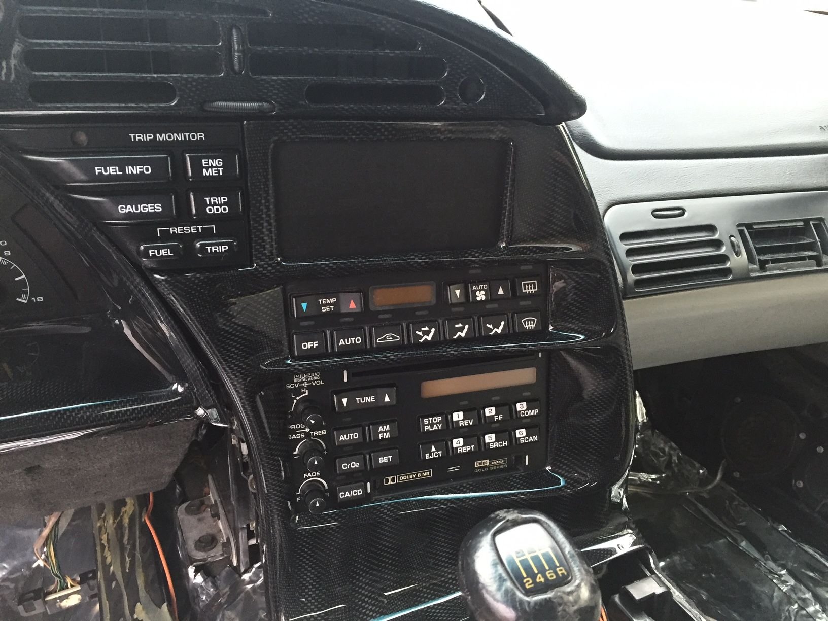

radio bezel on and back from american hydrocarbon. Radio will be eventually pulled and sold and replaced with gauges
That looks great. What did it cost you. Forum vendor does that also but way to price for me. Maybe they are a little more reasonable.
The bezel was 209 i believe, but that includes the price of a brand new bezel and return shipping cost.
