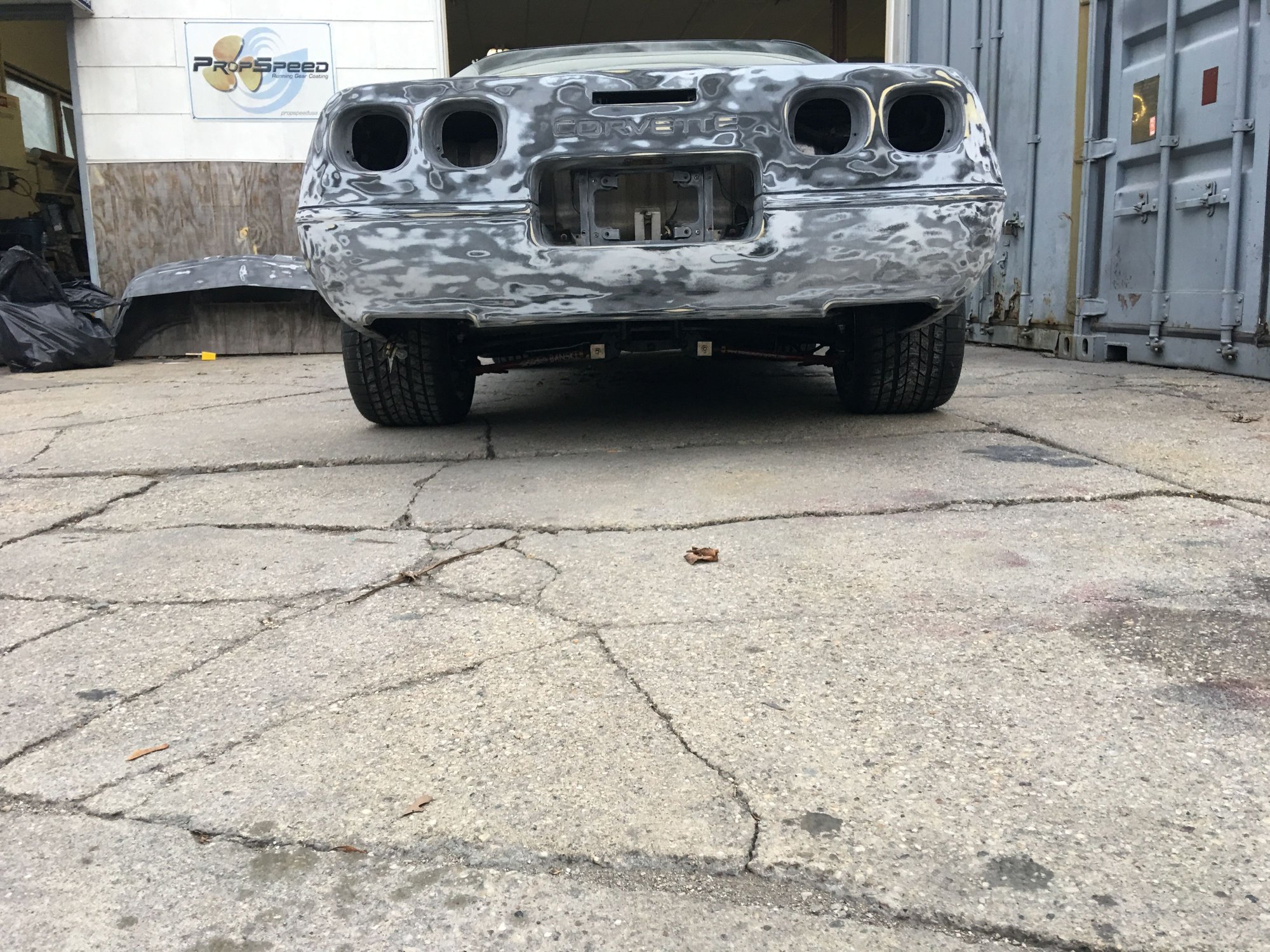

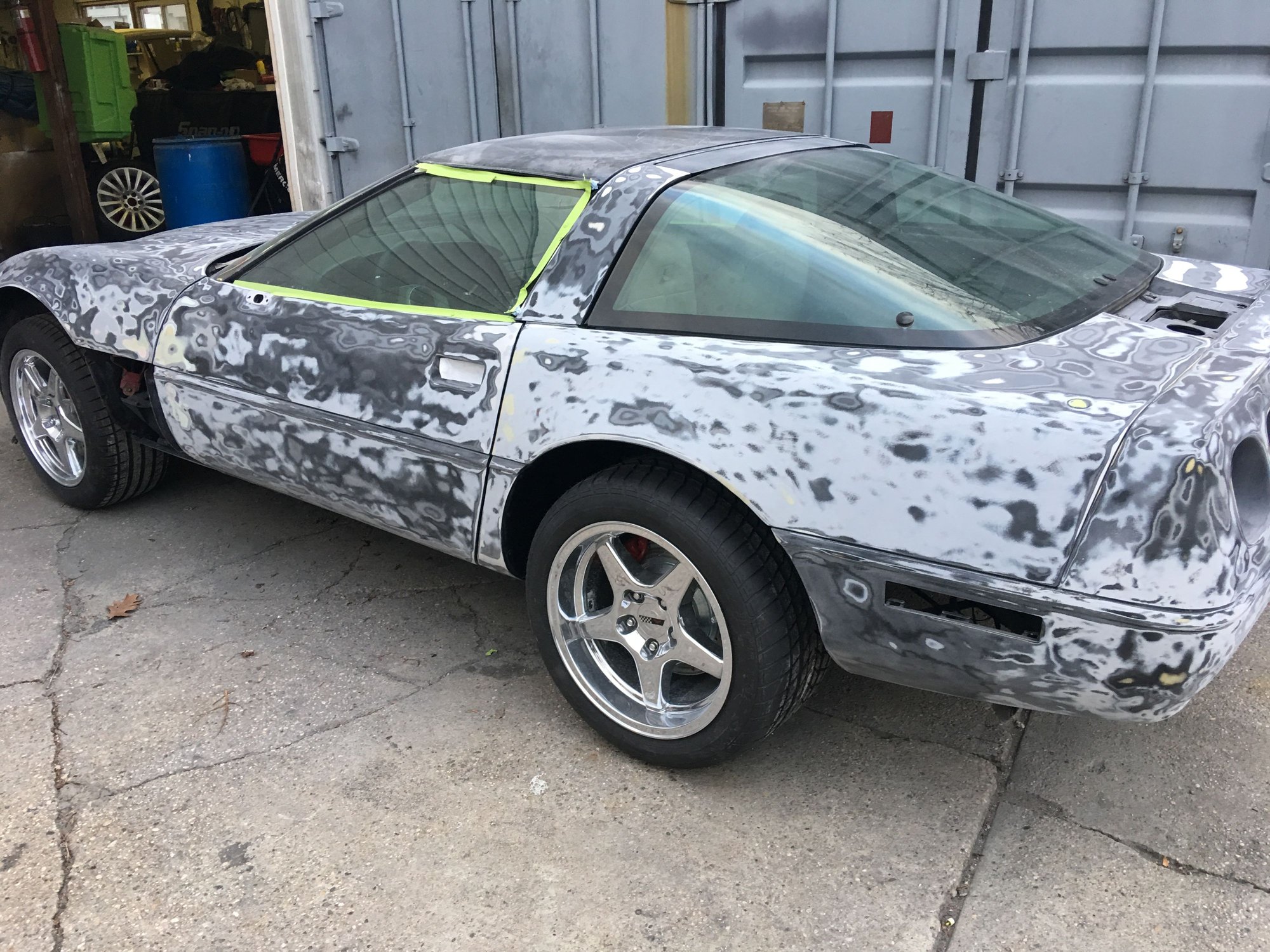

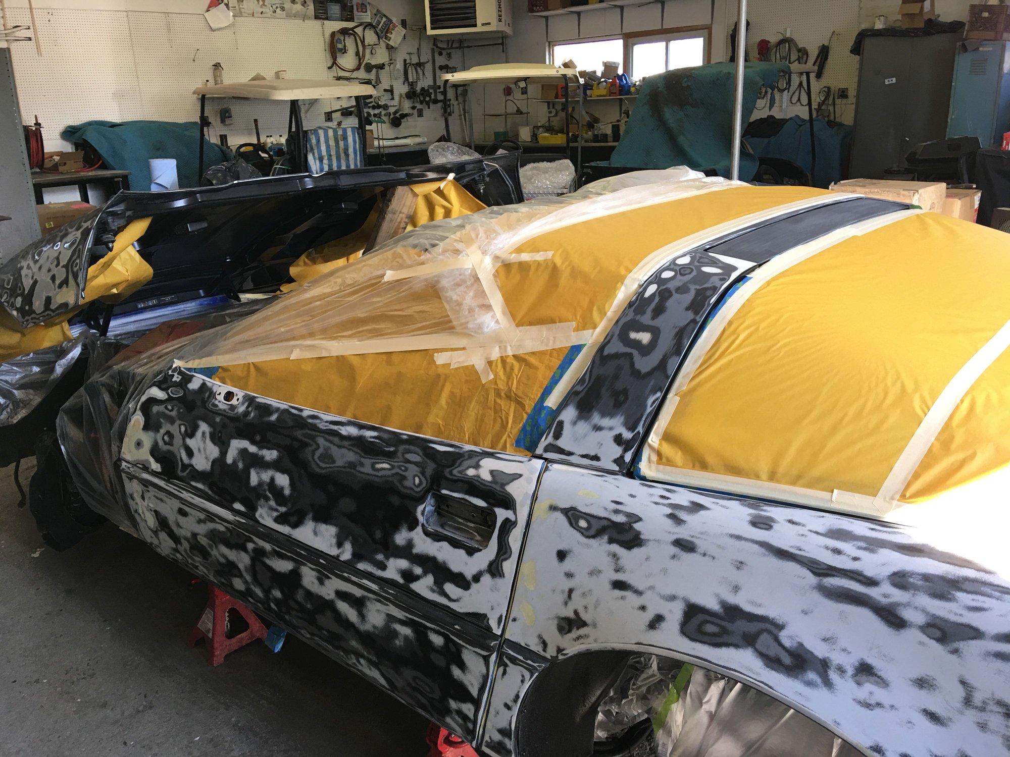

well Friday and Saturday I've spent sanding the car and fixing up a couple of rough spots with the fiberglass/paint tech at the marina I work at. Car had a botched paint job underneath and was causing a few spots to bubble. When it's done the car is going to look great I can't wait .
Glass repair

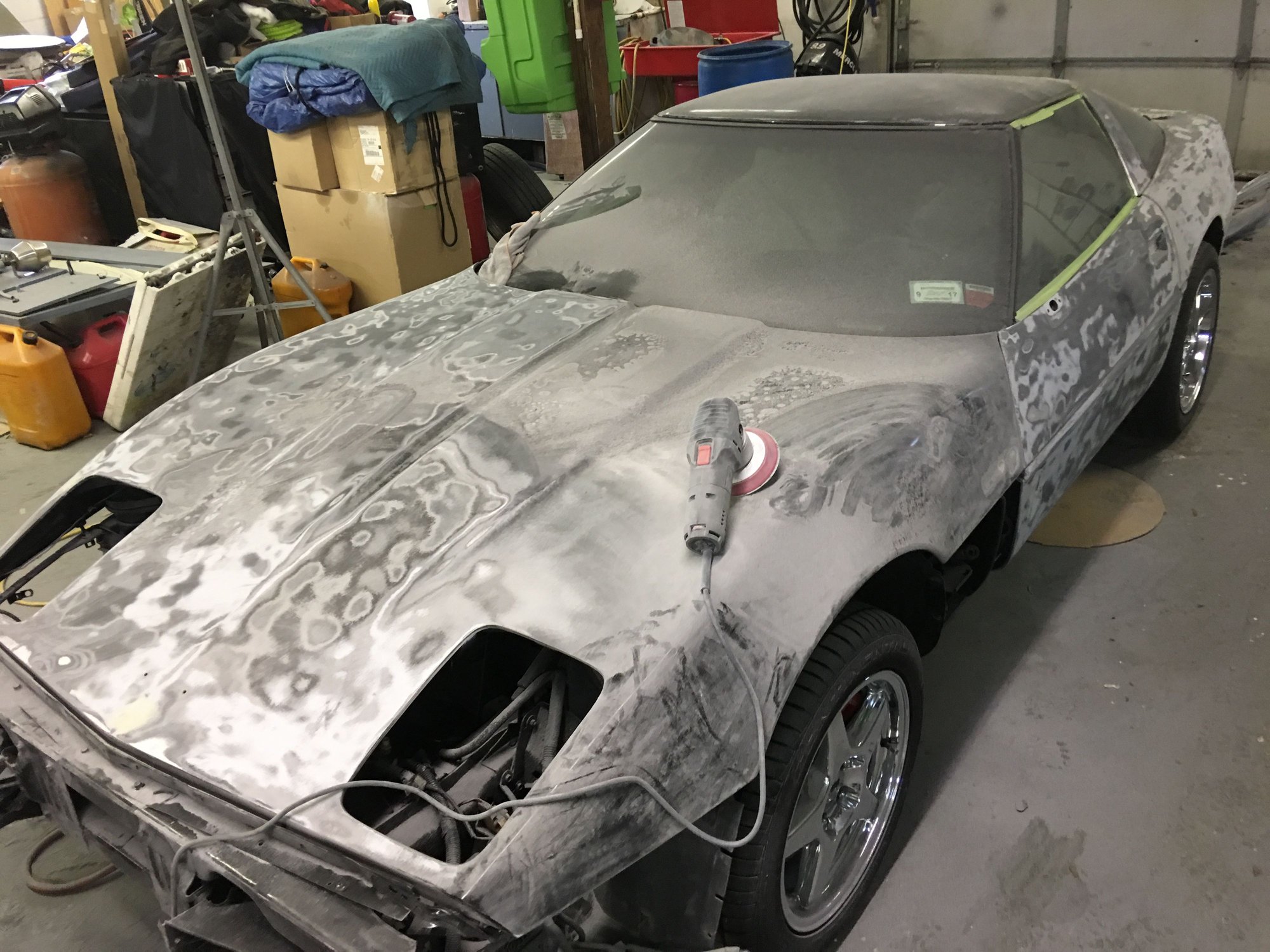

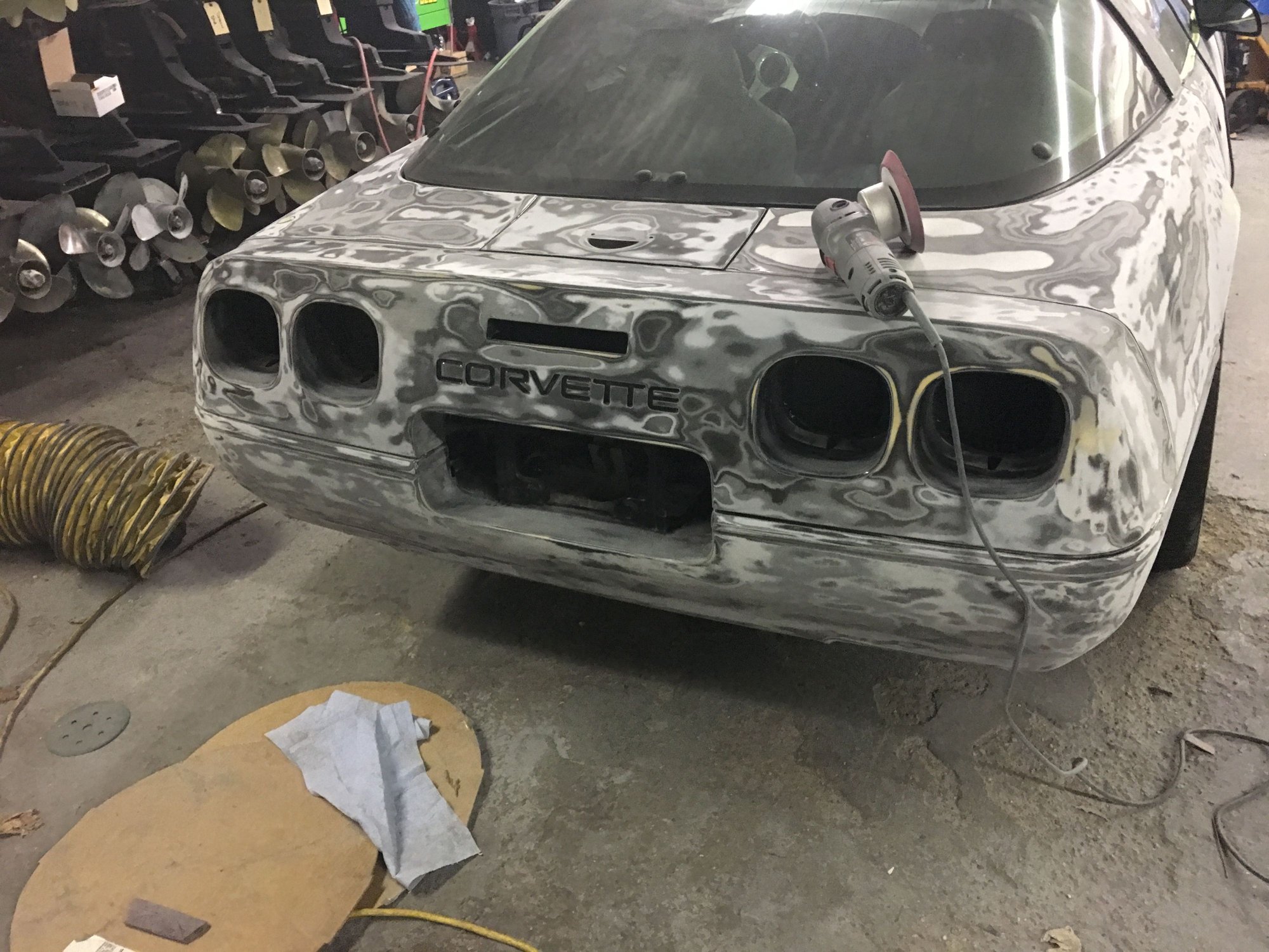

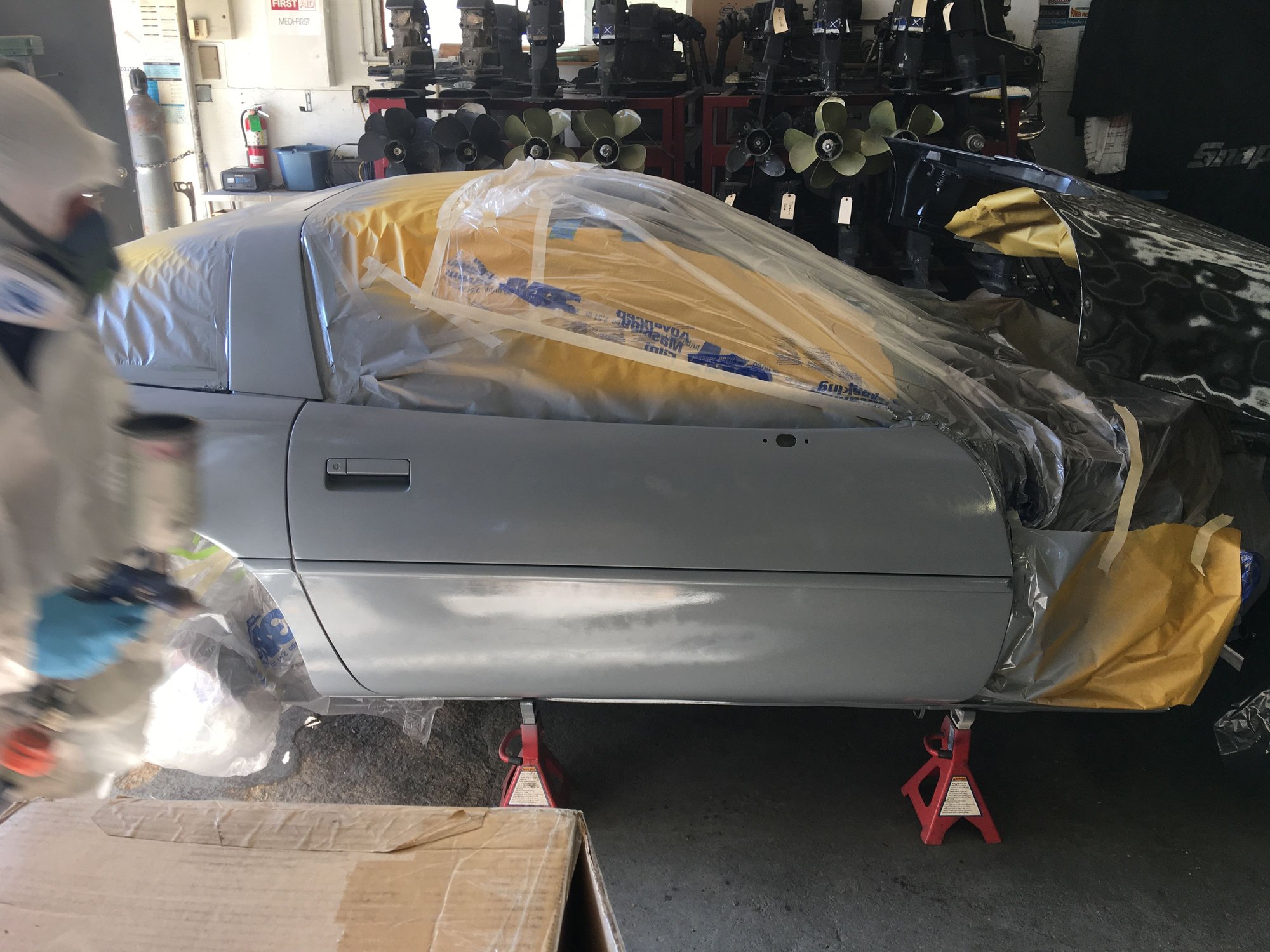

Couple of more photos of yesterday and today sanding and priming stage 1.

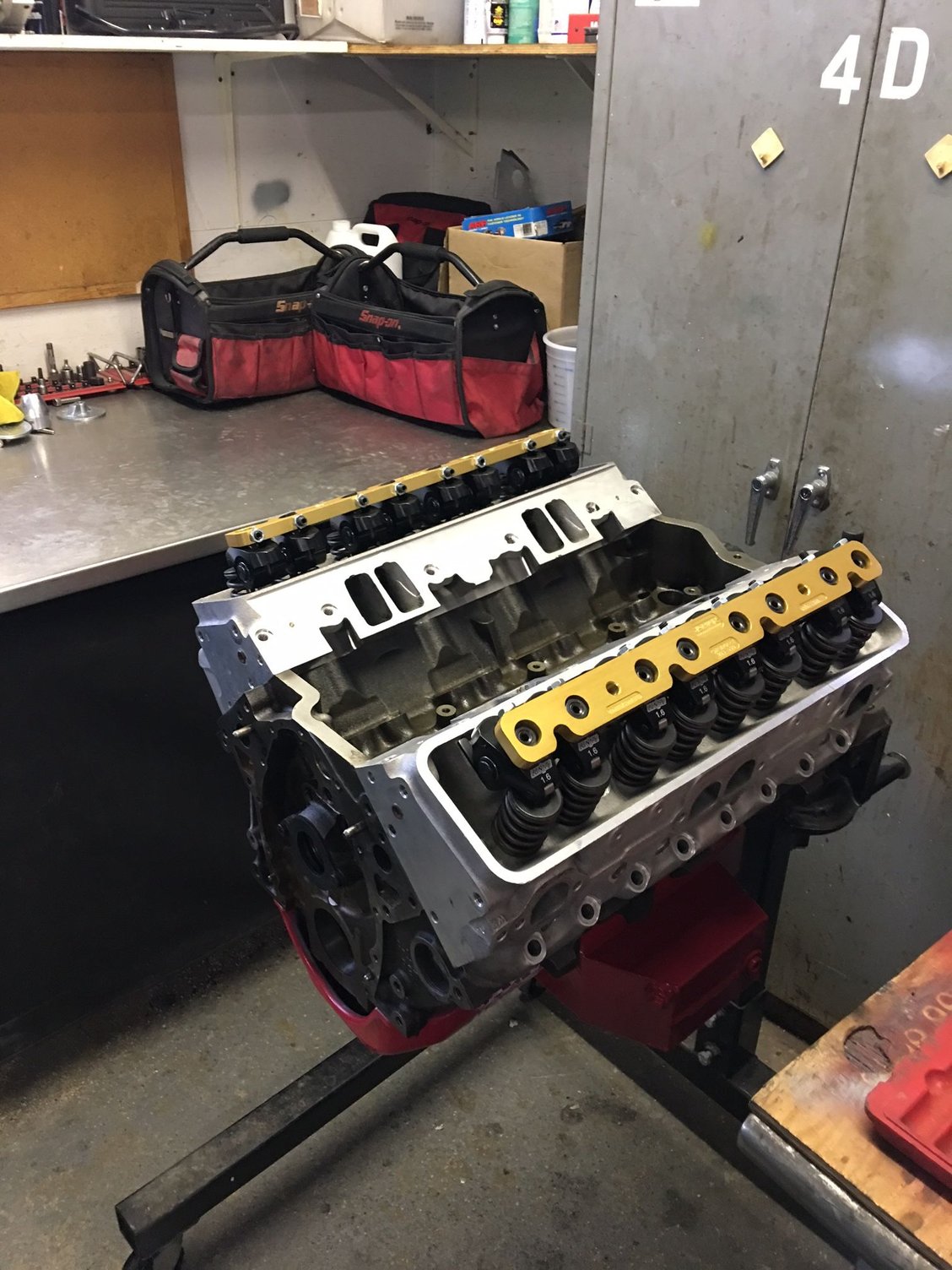

Got My Block Back Today, Will be doing some checking!

Are you using the factory block? Not to sound dumb, but what is gold thing on the roller rockers?

Yes stock engine block, They are stud girdles, which at the moment will be using if i keep these heads. I may go AFR or DART.

Originally Posted by 94VenomVette
Yes stock engine block, solid roller 383 build up. Milodon Main Caps will be installed and Callies Magnum XL, XD rods & JE pistons. SCR (static Compression Ratio) will be 12:1. The gold thing is a Rocker Stud Girdle. Even though i have 7/16 rockers & studs and will be using 3/8 pushrods and guide plates i wanted a little extra insurance. Wasn't that much $$ for the girdle anyway. Wanting to spin this stroker to 6800-7200 RPMs make around 525-550BHP..maybe more... Going with a lightweight rotating assy and fully ported LT4 heads.
Thanks of the info! And sounds pretty kickass

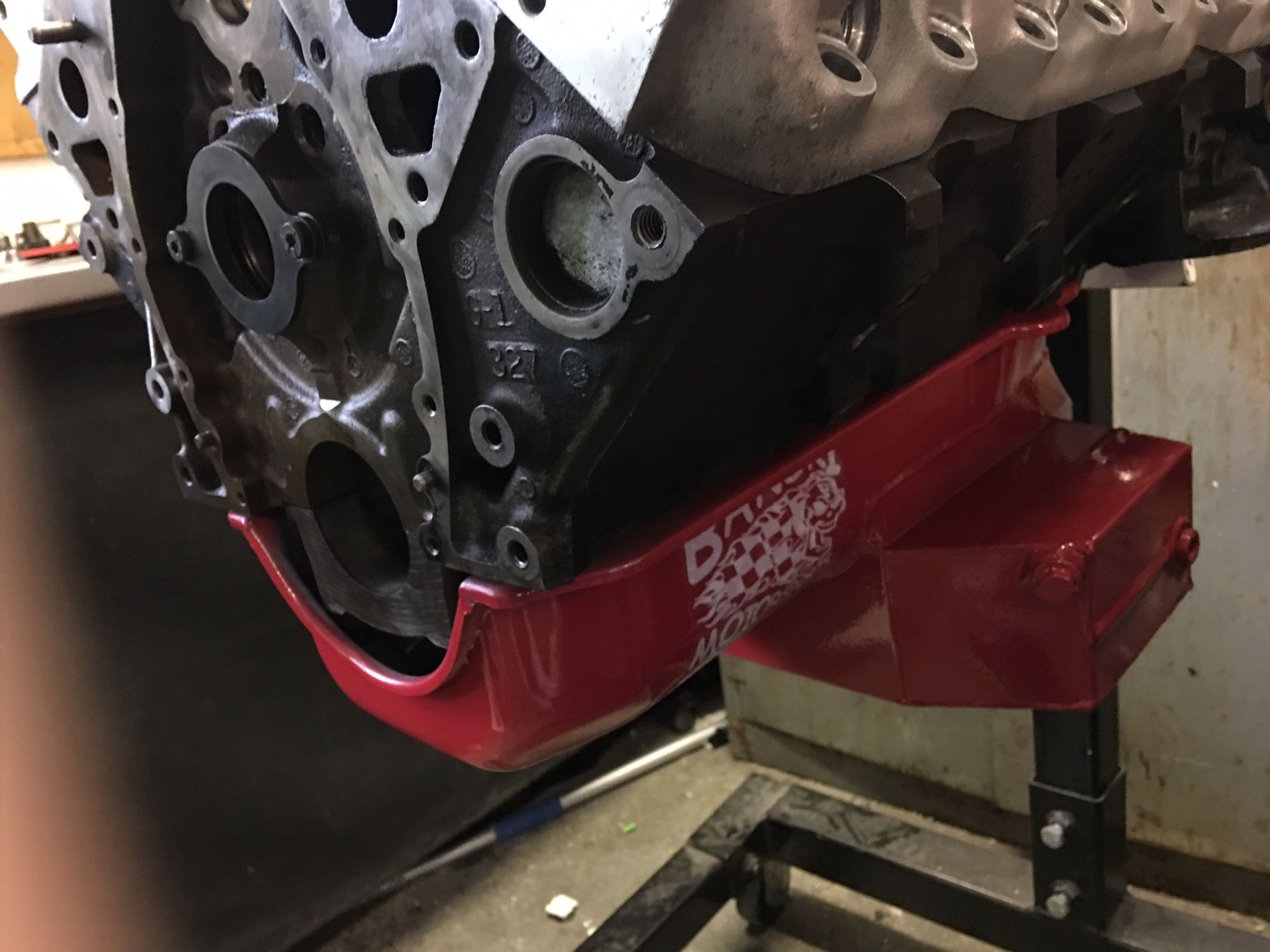

Custom Cam =)

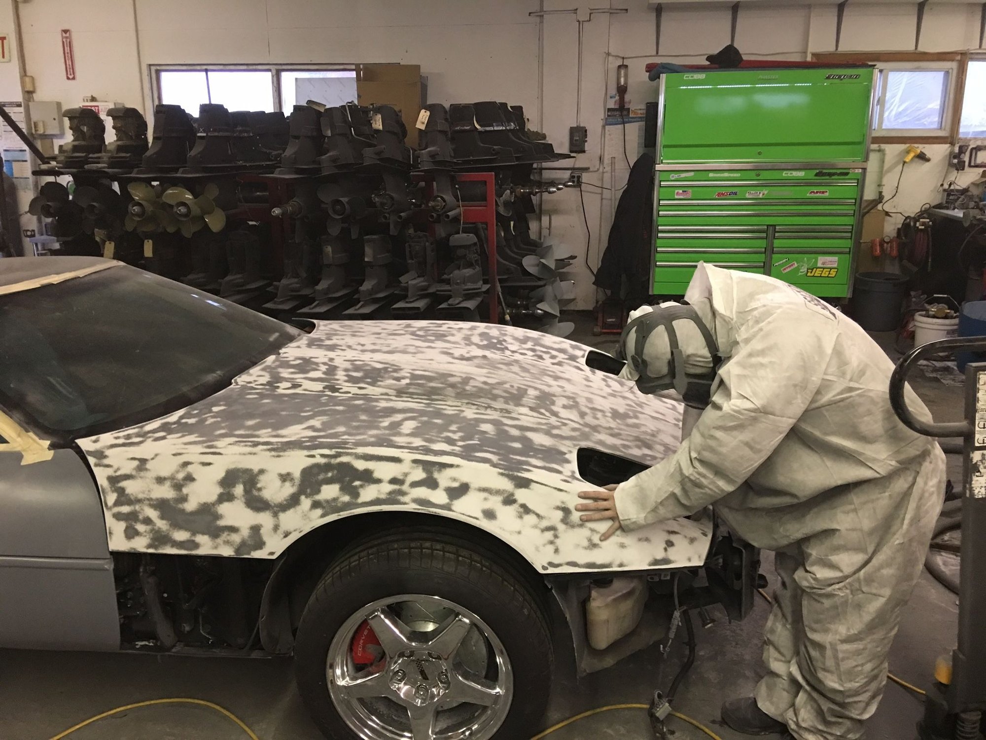

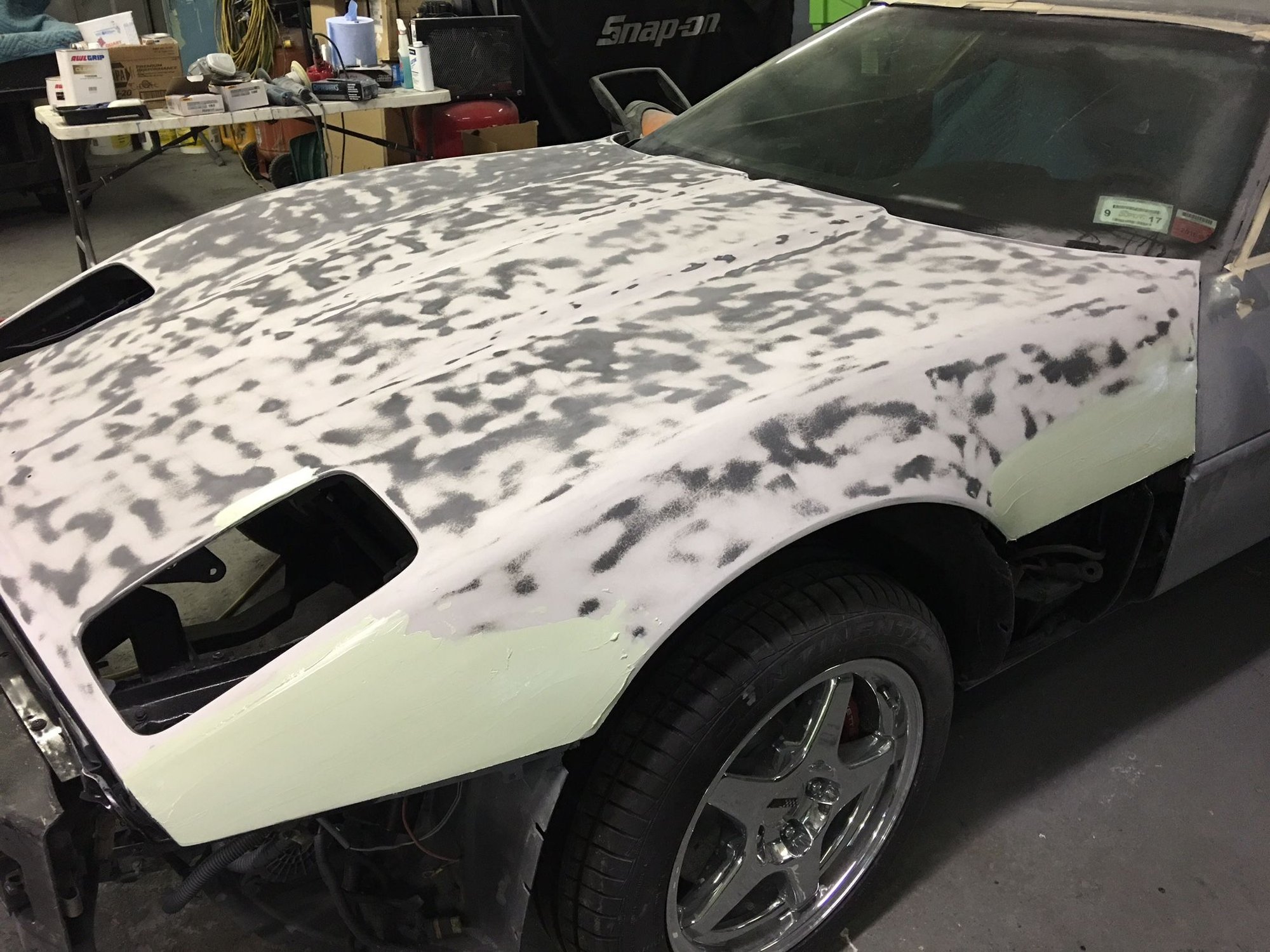

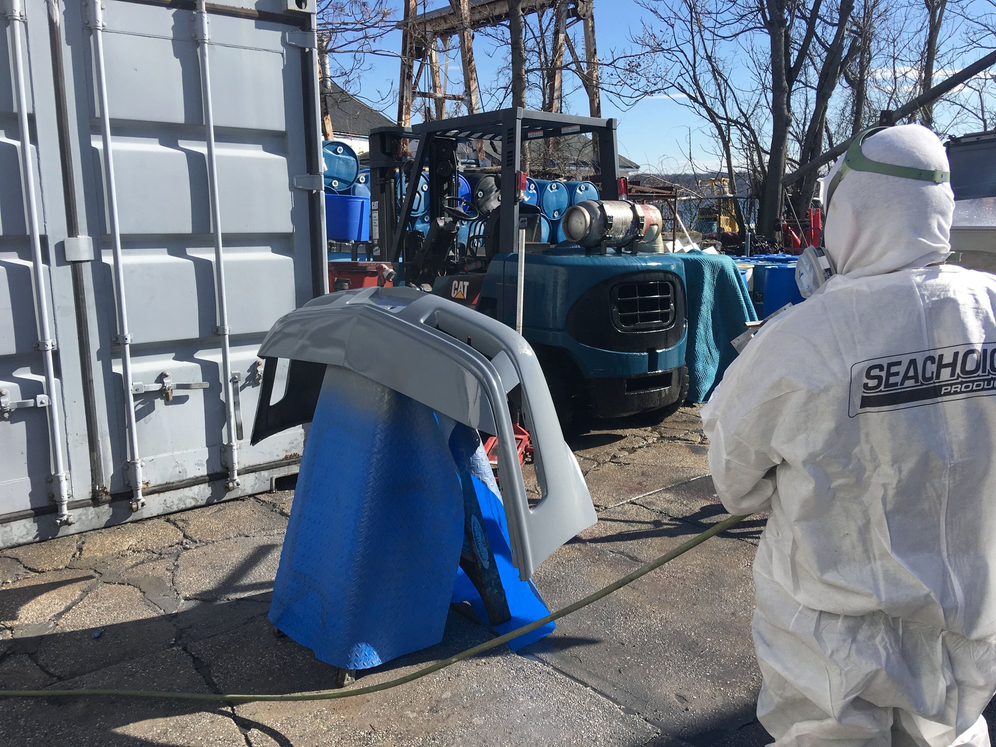

Prepping the Hood
Some High Density filler to fix the low spots. Primed later on.

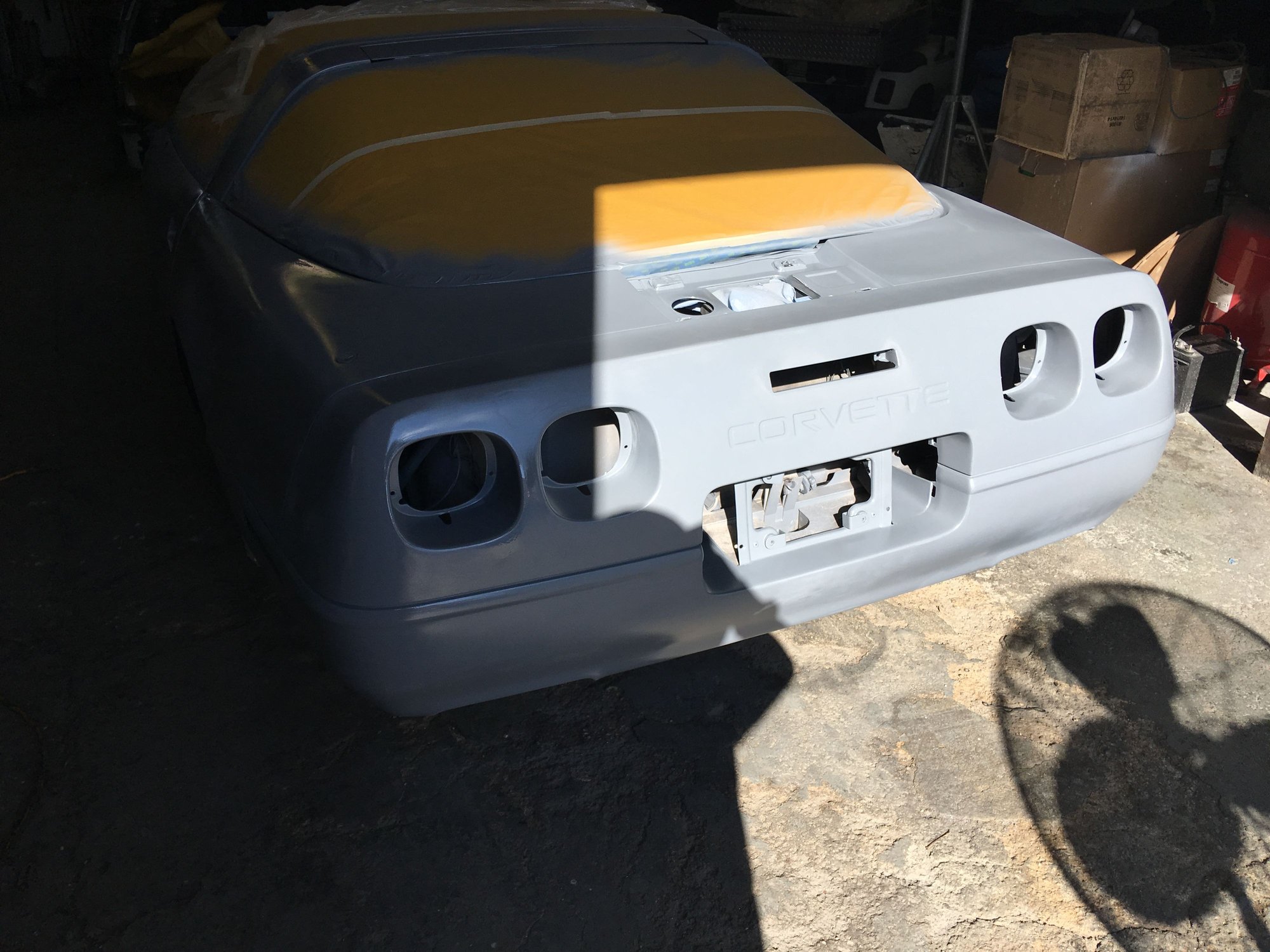

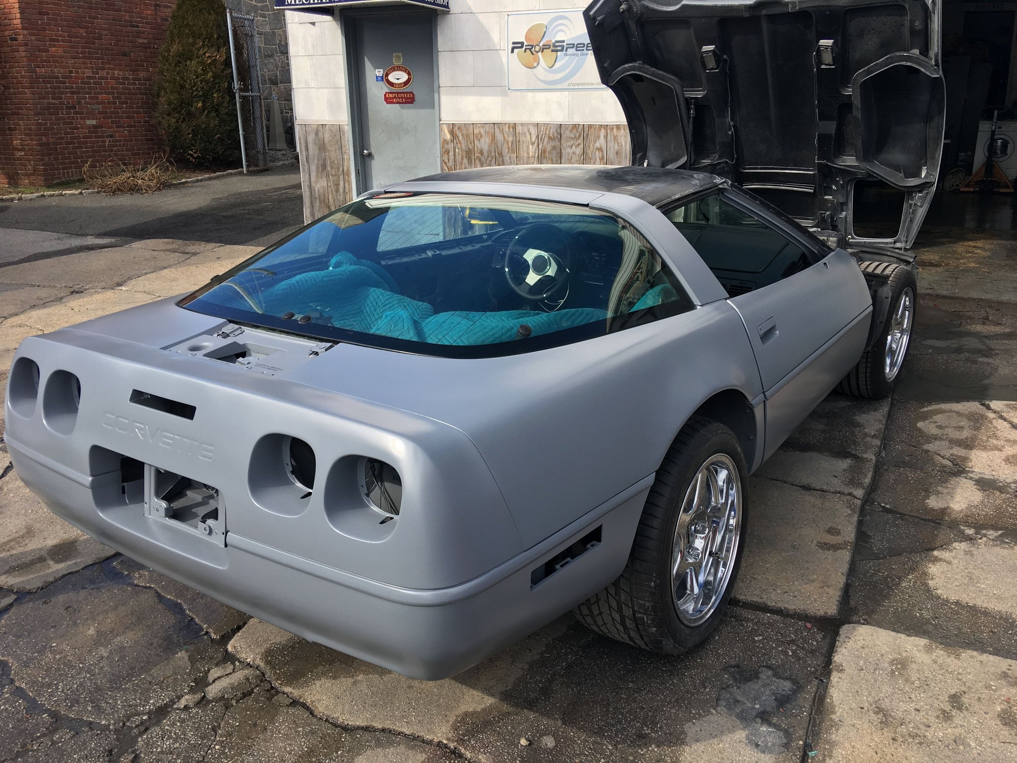

Well final prime is on. Ordered new side lights and looking for a new bumper and side mirrors due to the fact the old ones are too messed up.
