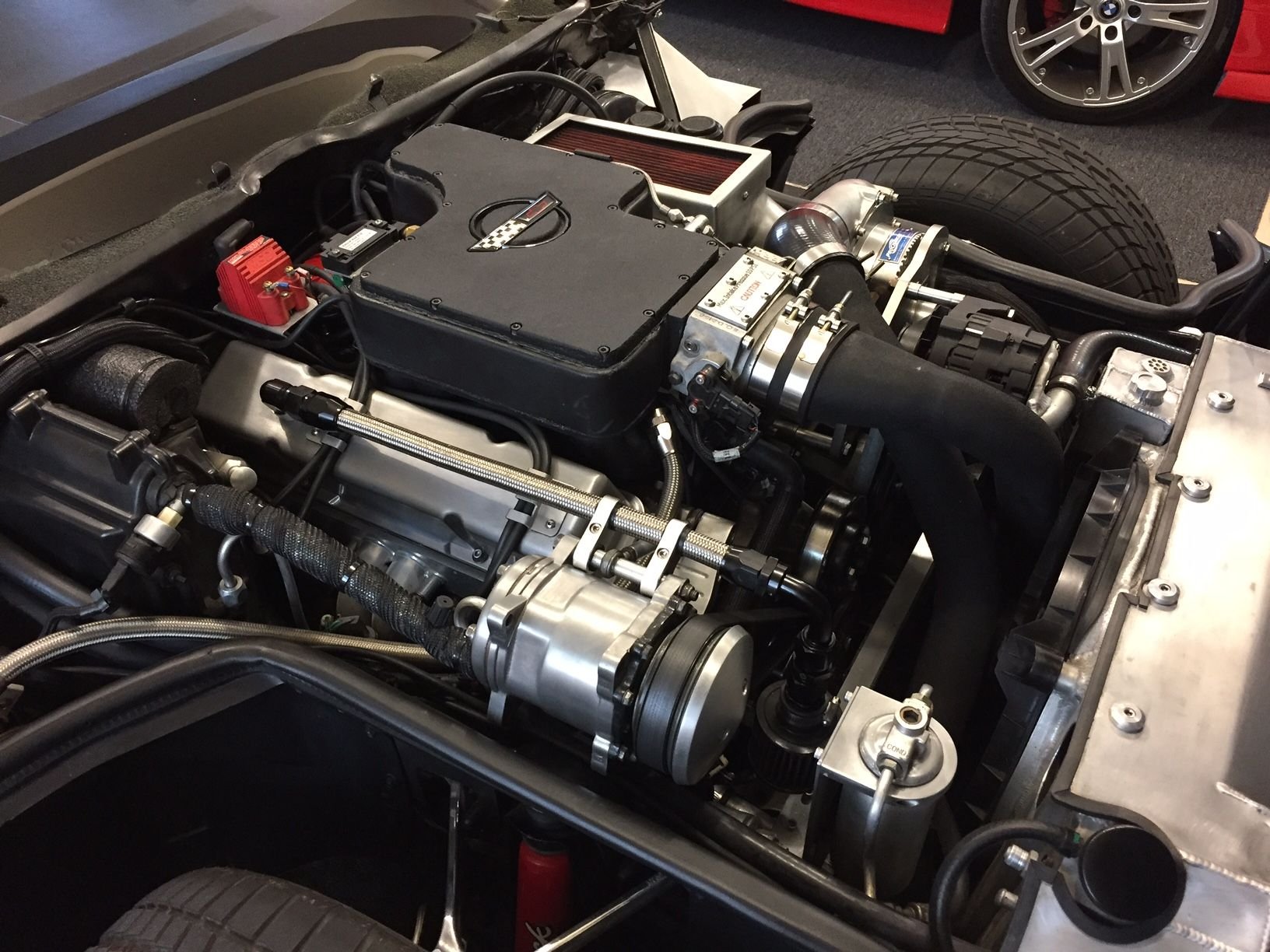

We made a casting for my SR with an embedded C4 emblem. The casting was based off the original finned lid which does not have as many fasteners as yours.
That is one sharp looking super ram and one beautiful engine you have.
My lid just seems to be a piece of flat 1/8th aluminum, I might make a nicer looking lid. Still wonder why mine has more bolts in a different pattern than the other super ram's i've seen? maybe mine is an early production batch?
Sounds like the previous owner cut his own lid and tapped extra holes to get it to seal.

Originally Posted by confab
Very nice. What did it take to make a casting like that?
Anything a DIY'er could reproduce?
Eleo Martin made this aluminum casting - a one of one. It was a boatload of work to do it, he bought a furnace to do this one.
I asked if he was willing to do more and he wouldn't because of the hours it takes.
But I would think someone could cut a nice lid with a waterjet from a billet sheet....

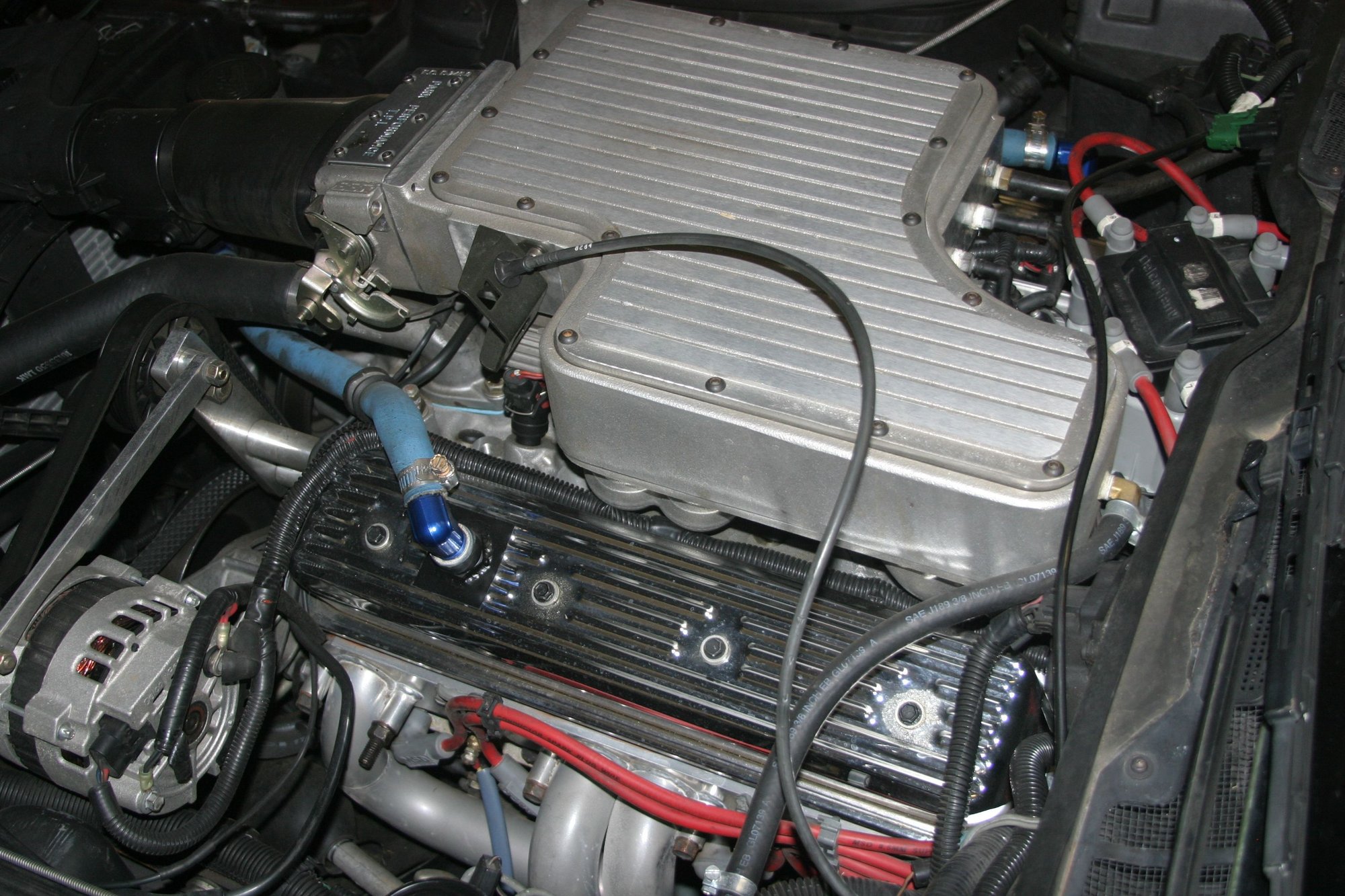

This is the original top cover.
