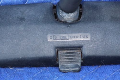

I changed my old school mirror with the flip switch. Now it is electronic, has compass bearing (not that I use it) AND it allows me to program 3 rolling code openers. No more box on the shade or clunky stuff rolling around. Best of all, it dims electronically.
Can you point me in the right direction for a "flip switch"? Thanks in advance.
There is that flip thingy in the mirror. IIRC it is for bright lights in the rear.
I have a Gentex self dimming unit with Homelink
