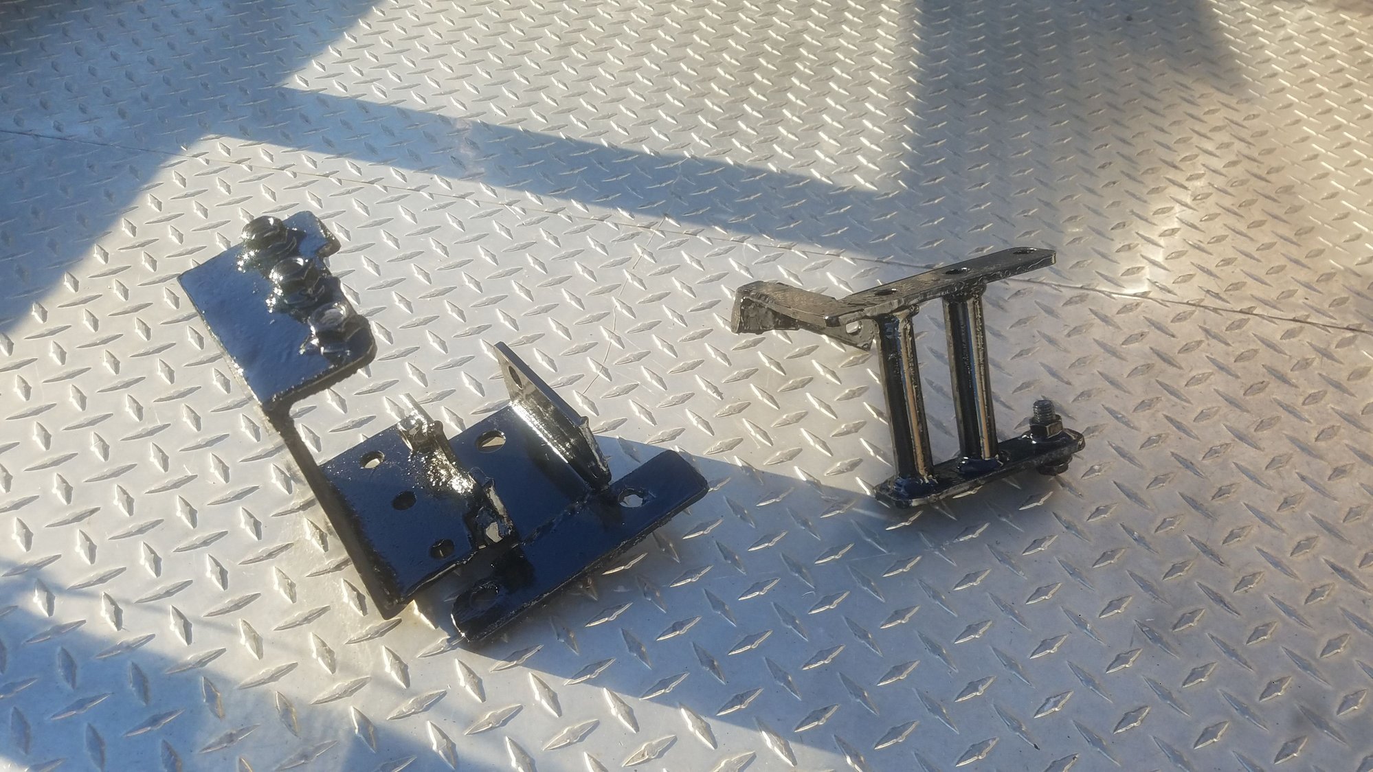

New heater core (PIA), 3 aluminun core radiator, t56, red epoxy bushings, super ram, 21lb injectors, hot cam, edelbrock heads.
Same 700r4 eprom (for now)
Sandblasted the bracket, the super ram
and ospho rust prevented the bracket, tomorrow ill por15 or maybe buy some epoxy paint from home depot? What do you think would be better for newly sandblasted/ospho metal?

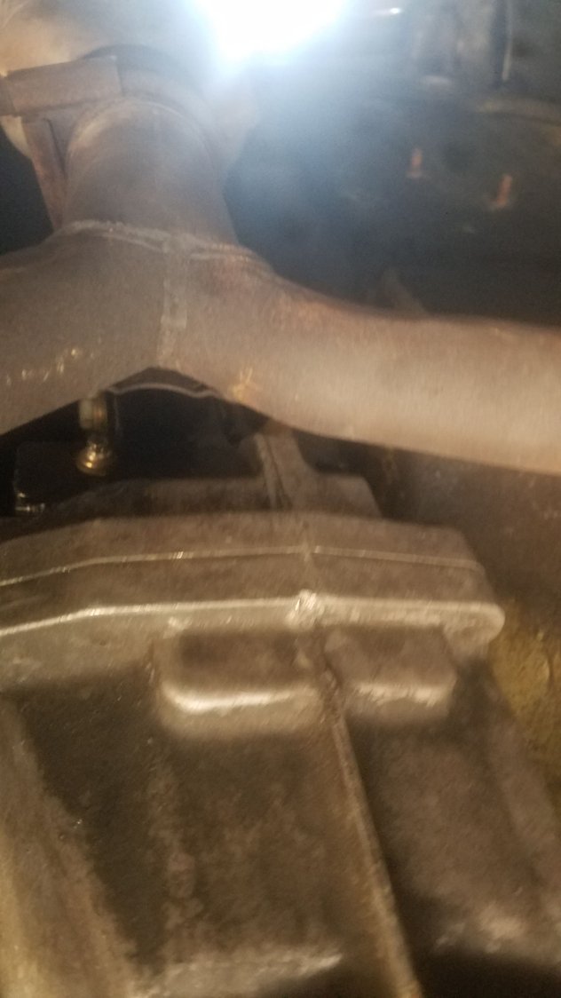

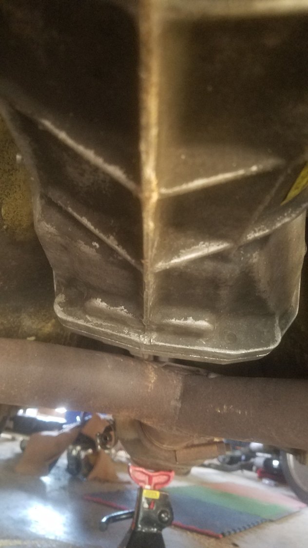

Put the exhaust original manifolds back on, due to the headers wouldn't fit with the T56 and I couldn't mod them. I put the original lead pipes on and they hit the bottom of the tranny. On the passenger side of the pipes. Thinking of extending them a few inches back, until i get it running, then get custom exhaust. Did anyone else have this issue or did I mess up somewhere?
Old Apr 6, 2019 | 01:50 AM
Karp's Avatar
Karp
Joined: Sep 2015
Posts: 277
Likes: 59
From: Haymarket, Virginia
I ended up cutting and extending the exhaust 1", mocks up great. I also took a piece of 2" x 1" tubing drilled holes, cut in half and welded nuts on it for the rear Cbeam bracket. Tomorrow i get a rare kitchen pass to go and work on the vette. Ill update later this weekend too.

Didn't see your post originally but I just hammered my exhaust to get the clearance I needed.

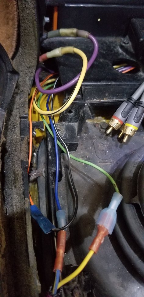

this weekend I rewired the center console auto switch
Purple and Yellow with black stripe wired to clutch pedal
Orange with black stripe and Black with white stripe wired together to allow power to the convertible hatch.
Light Green and Blue wired to reverse switch on T56.
