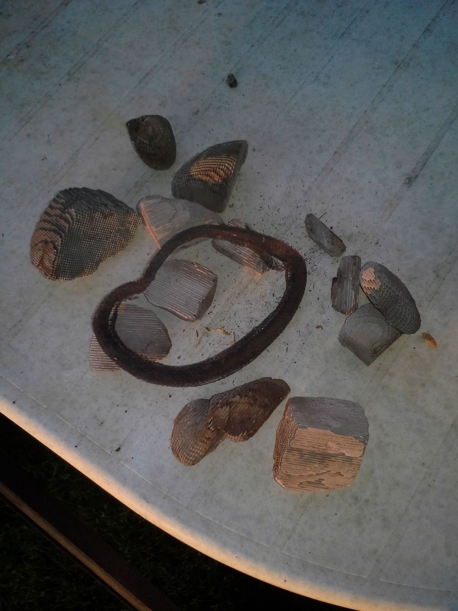

Junk out of pre CAT
Inlet
Pulled the whole system off. Chunks laying in front of Main converter on my 86. 1 Pre cat toast.Other OK, Gutting the whole system, No smog checks in WV......Straight down pipe before main CAT sounded good ...Gutting my main CAT, reinstalling with Magnaflow rear pipes. Got my motor back....Been running like crap couple of years....Got my Problem solved

Good to hear, was your muffler full of that material?
Those old cats were really bad compared to whats out today!

78000 miles on my 86. The main cat was changed before I bought it. ( it looked newer) The front screen on the main cat caught all the debris luckily. But I have material loose in the main cat, nothing got past the rear screen into the mufflers

Gutted the precats. Gutted CAT on stock system. Flowmaster mufflers. Got my motor back.
