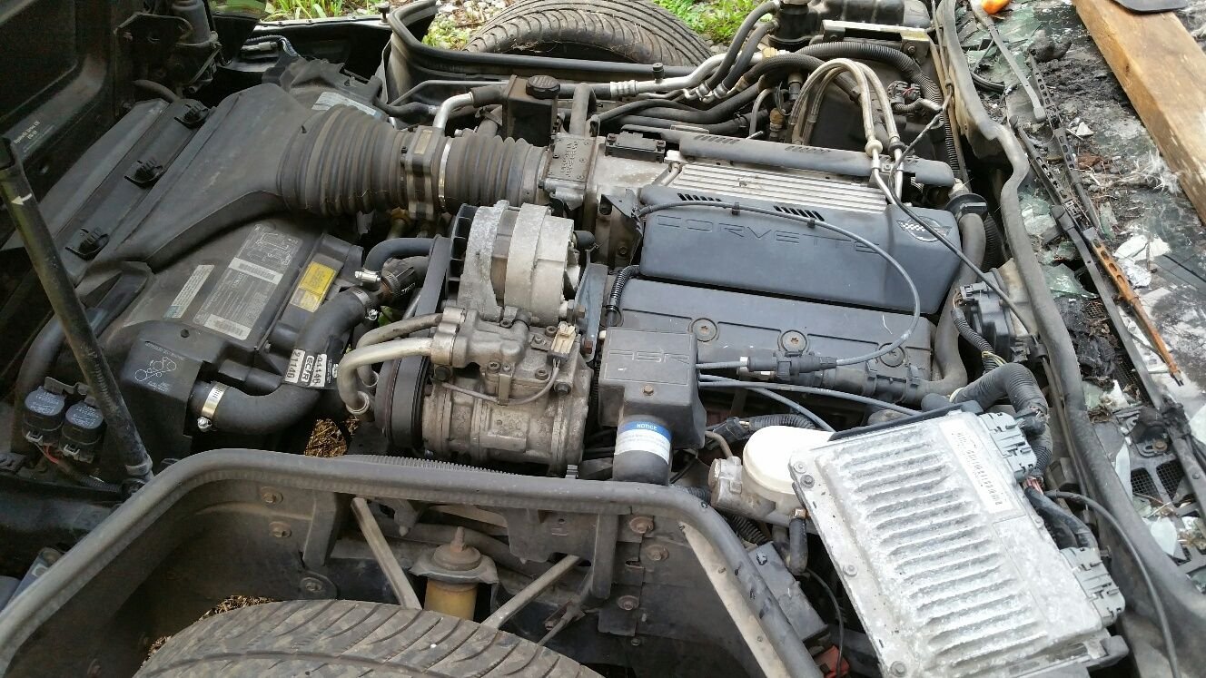

1994 c4 I just bought a burnt vette for suspension and was thinking about using the engine in my 52. Is there anyway to start it to check it's condition since the interior is toasted

Pull the engine, find some place that typically builds performance engines and see if they'll put it on their engine dyno. That's the only way I can think of.
Know if the interior is burnt, you likely won't have an ecm or had you planned on that assuming you're keeping the TPI.

Yeah, don't see it running. Might be able to apply power to the starter. Then you could pull plugs and check compression. Might give you some insight into the engine condition.

ECM is under the hood and intack. If that makes a difference I was thinking it has a vats system or pass key lock and needs the right key to run but thought maybe an msd system might work on it?? How do people normally get these to run in a different application?

Yes I can know I can do that. But I know these engines are put in not corvettes and they start them somehow. I got a reply that the engine should be torn down and completely rebuilt before putting it in anything , Really. Don't know were the comment went but that's just crazy.

With as bad as the rest of the car looks, I'm surprised everything in the engine bay survived as well as it did. If you cropped the burnt interior out of the photo and didn't show the hood, you probably couldn't tell the car was on fire at some point. I *Think* you can have the ECM reprogrammed to bypass VATS but I'm not 100% on that.
This (click here) is a link to a thread that talks about it, 2nd post has a link to a little module by Baker that you connect into some of the wires coming from the ECM - it basically simulates the same signal the VATS system uses to tell the ECM this key is the right key. IF you're keeping the ECM but you don't want it reprogrammed, you could go with this. But since you're putting it in a 52 something, if you're going to have it tuned or reprogrammed anyways, I'd probably just have them bypass it that way.
If you're intent on checking it without removing it from the car, one thing you could do is get something to rotate the flywheel or crank somehow and see if she turns - if she does then good sign. I don't see it running while in that car though - in a different car sure, but not in this one. Depending on how long it sat like that it's probably not the worst idea to take a look inside before you put it in anything you want running.
Don't forget that these engines also came in the Camaro and Firebird too, as well as the Roadmaster and Caprice - albeit slightly different or detuned, but you can probably scrounge a harness or a different ECM (if you wanted to) from a junked one of those to get it running in something else.

Oil is clean and the engine turns free and the only damage to the hood is they knocked a hole in it at the sale to see if the engine was still in it. 52 chevy fleetline 2 dr. is what it might be destined to. Been doing a little research tonight and found 2 running on an engine stand. Post was several years old but I'll email the guy and see how he did it. If he can get it to run on an engine stand surly i can get it to go in the car. Thanks for the comment.
running on the stand.

If it was me playing with this, even though I know junk yard motor is cheaper that runs...
This has an optispark.. So IMO forget it, not because of that, but because the computer crap is shot more than likely.
If it was a gen1 it would be easier with a conventional distributor.
So, remove all fluids, disconnect any trans stuff, remove plugs, put ATF or something in the plug holes and put straight power to the starter from a battery to get it turning over.
Then begin the chase in the engine for it to run.
Air, spark, fuel, compression.
Walk away! unless you want a project, and no it won't be cheaper to use this unless you went carb etc. L98 is the answer or LS.

So, IF the computer us not toast in some way...Do what I said above, because heat boils and can seize things. A car fire or house fire is not regular fire.
Pu 12volts to the system and it should turn over, if you add a combustible to the intake after adding oil and plugs, it should fire. Running is another story.

You e actually got a lot of options for it.
first off, you could disable the vats system entirely with a custom chip. About 100 bucks from PCm of NC.
option two is a mega or minisquirt. This would totally replace the ecu, but would be a bit more expensive.
option 3 is to do very to an ls motor ecu. There are lots out there, the perk of this or the squirt is if you modify the engine, turning is easy.
Before going down any of these paths I'd check compression on all cylinders, and rotate the crank by hand to make sure it moves. The engine bay looks intact, I wouldn't be surprised if it ran fine.
don't let some get you discouraged. The option isn't that bad, just the bane of those who don't do regular upkeep (like water pumps). Mine made it to 135k before I changed it because I was chasing an issue that was actually a different part. Poor troubleshooting on my part, but I at least got fresh parts in my old car.
