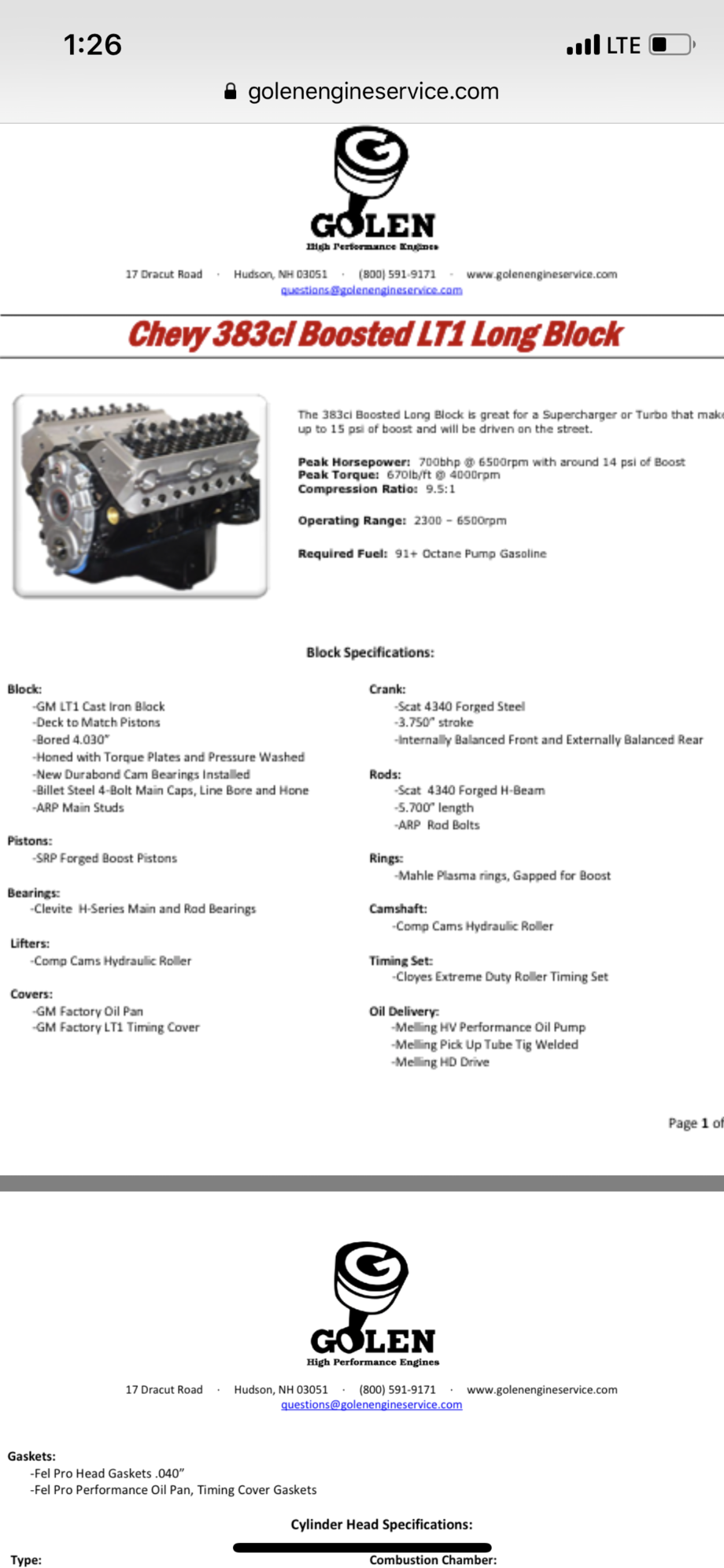

Default New engine
Originally Posted by CVG323
that sounds reasonable. how much was the engine (if you don't mind me asking)
PICS?
the engine came came out to 7.5k but I still need to buy the d1sc Procharger so I’m not done yet

Default New engine
He’s a popular builder and this is one of his more popular builds that has been featured in a few magazines. I’ve talked to a lot of people and they say golen is a real good builder so we will see.

Default Pics
PICS?
sorry for for the pictures. I bought the engine Thursday so it’s just being built!! Will arrive in the beginningof September
