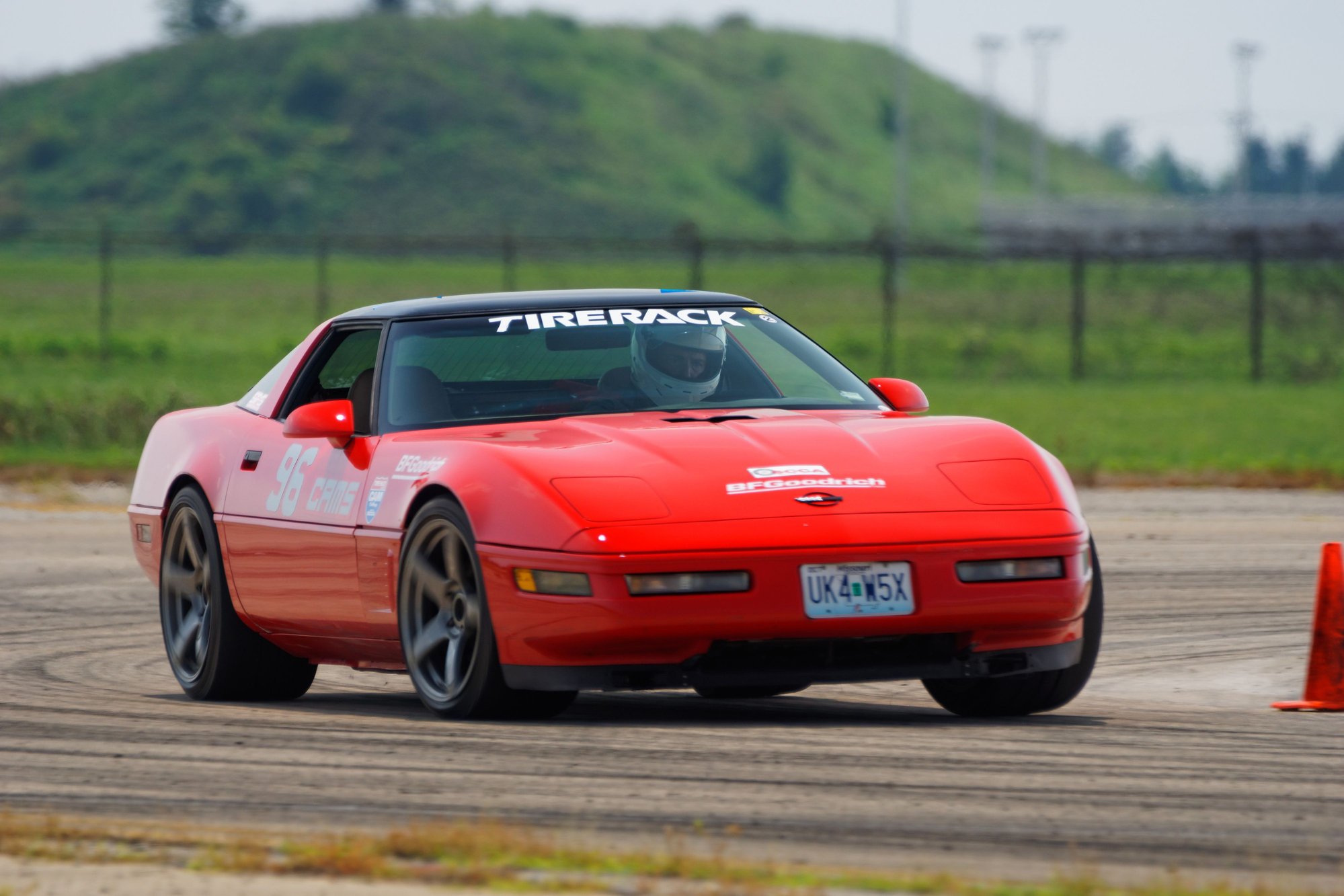

By the way, your red Corvette in your avatar looks great. Do you have larger pictures?
Okay, just one, because I don't want to hijack this thread:
That's with VBP Xtreme leaf springs front and rear (1125f/550r), urethane front control arm bushings, Banski rear suspension links, an assortment of OE sway bars, a mashup of custom-valved Bilsteins and Koni sports (would like to try the Ridetech offerings someday), and 18x11 wheels with 315/30 Rival S tires at all four corners. It's close to full weight - only the a/c is missing and it probably still weighs over 3200lbs.
There are a few others on the forum that are at least as heavily modified. Here's Chris Ramey's Optima-winning 84:
I would bet his car is 300lbs lighter than mine, with 50% more power and 335 tires at all four corners. And Chris can flat drive. Also, look for Nokones' car on this forum, among others.

Thanks Matthew. I wasn't aware of the draw back of the LT5. I thought the LT5 was the most desirable engine in a C4. So it's looking like instead of searching for a ZR-1, I should just find a nice standard C4 and do a LS1 swap instead? Or the chassis ad suspension of the ZR-1 is so much better than upgrading a standard C4 there would bring the price up to ZR-1 level?
Buy the way, your car is stunning! Where can I see more photos?

Re pics of the car, I appreciate the compliments. It's really just a stock-looking C4 except for being lower and on much wider rolling stock than the factory gave it. And it has a hole in the hood (long story). I don't totally know why, but that seems to really grab people's attention. I get compliments frequently. I guess getting any C4 lower and putting fat tires on it really highlights the great lines of the C4 (GM really hit a design home run with the C4 IMO). I don't have too many pics, but one of these days I should get a photo page going where I can link people to an album. Okay, you lit a fire under me, and it was super easy to load a few into Google Photos. So here is a collection of pics of my car. The first couple are of the previous owner tracking it (he is MSR, still lurking around this forum).
