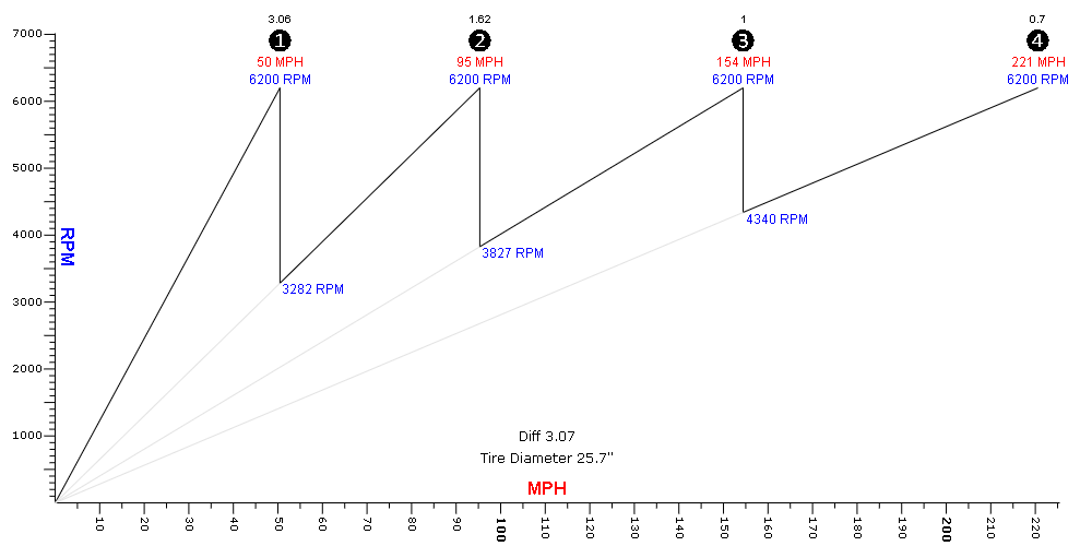

Kyle F posted this in an earlier thread, very helpful
I think I left out one portion of information you will want.
I used a 275/40R17 Tire for these calculations, 4L60E Transmission, assuming your build will make peak HP around 6200RPMs
Additional Torque Multiplication 3.07 to 3.54 is 15% by the rear gear
Total Torque Multiplication Per Gear
_____3.07___ 3.54
1st__ 9.39 __10.83
2nd__ 4.97 __5.73
3rd __3.07 __3.54
4th __2.14__ 2.48
(Sorry for crappy formatting)
What this means is at any given speed, you have more force to accelerate, but you are probably concerned about highway speeds as well.
3.54 at 70mph is about 2300 RPM (In my 6-speed I think this is about 1900 LOL)
3.07 at 70mph is about 1980. RPM.
Here is an idea of a WOT run with a 3.07 Gear:
And Now with the 3.54 Gear:
For S&G's, here is a 4.10, that would require about 2600 RPMs to run at 70mph
If you were tracking it more, we would talk about the number of shifts, anticipated trap speed, traction and a whole host of other things. If you were a weekend warrior I would be all over that 4.10 until you had a trap speed over 115mph (Roughly 425hp to the wheels). I have a supercharged LT4 and don't put that much power down.... yet!
