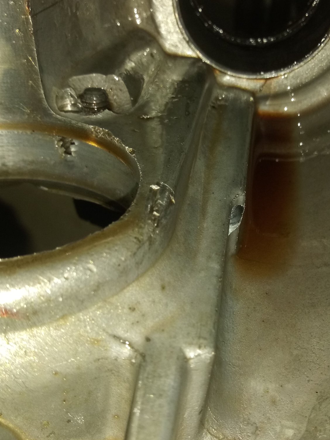

Ive been struggling all day tring to get this stupid tranny to go in.
I can get the yoke on. And get it inside the cbeam. But what i cant do is get the yoke to actually go into the rear seal while everything is inside the Cbeam.
Im trying to drop the cbeam entirely but so far even the impact wont budge the rear bolts. And then if I do get the cbeam off will it go back in with the driveshaft i stalled ?

I ran into that same problem yesterday. The tailshaft seal on my trans isn't the right size for my yoke, so I had to replace the seal.

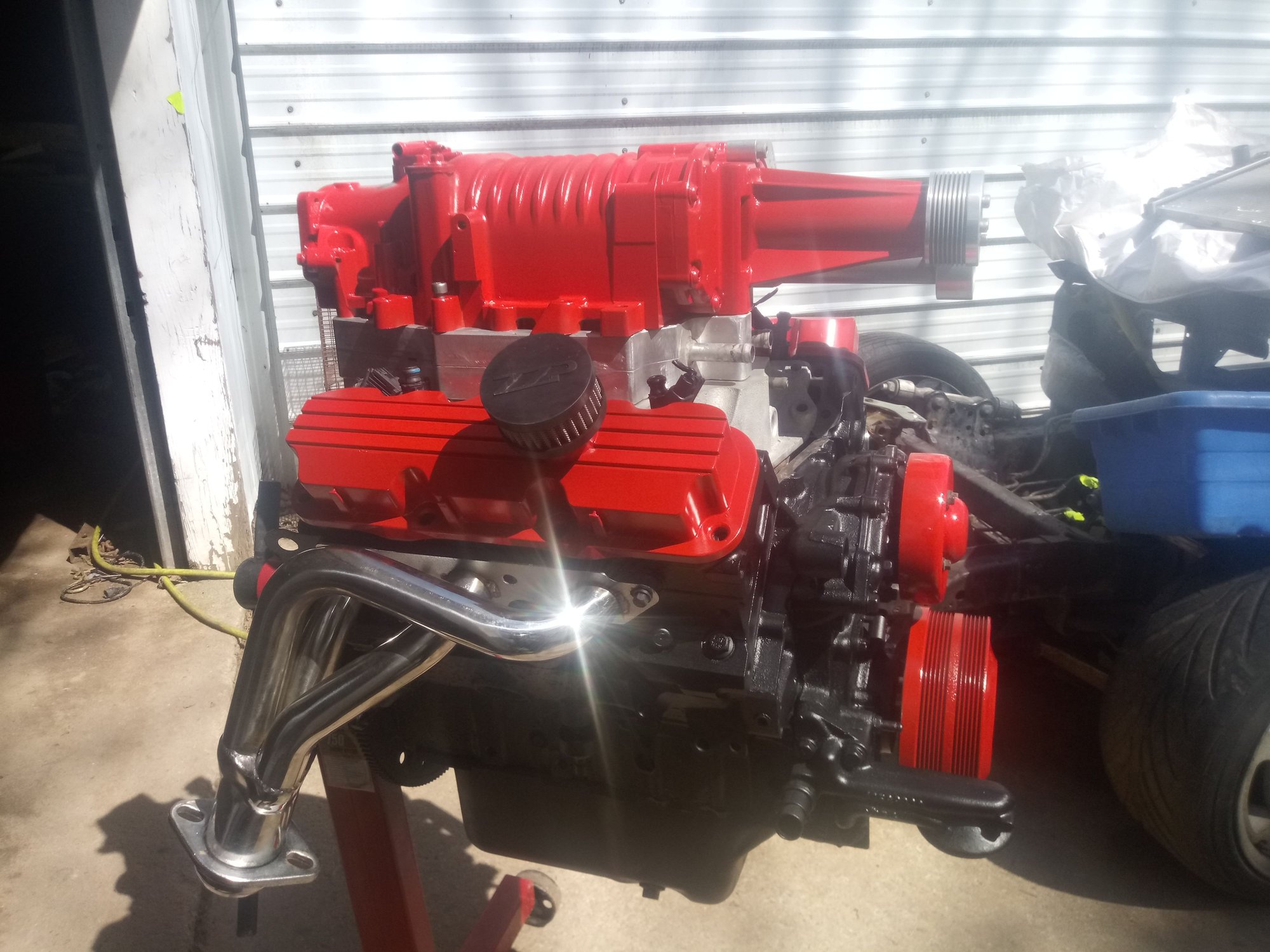

Old May 16, 2019 | 06:52 PM
  #46
rbates74's Avatar
rbates74
Joined: Sep 2011
Posts: 451
Likes: 16
From: Kalamazoo/delton MI
Originally Posted by Krusty84
That is a great deal on a 500 hp engine. Should be a lot of fun.
It had been built in 2009 but never fired. There was a big mouse nest in the intake and the mouse urine had rusted some of the valves shut.
So when I tried to roll it over by hand it appeared to be locked up.
So I was like... Ok, I will give you $500. Just needed a diy valve job and a couple valves I pulled out of a head I scrapped.
I sold the shrtblock but kept the timing chain and cam. Traded a few parts for the rockers and headers and used the shortblock from the engine I stole the valves out of.
Viola!
Useing my stock seal and yoke... Starting to question if the 700r4 and 4l60 actually do share the same shaft...
4 hours into it and I was defeated.

Many of the bushings in the front end are already "new-Ish" meaning not 30 year old 150k mile pieces. as they had been replaced sometime before 2011 when I bought the car. a couple still need to be replaced, but I think they were swaybar bushings. may be removing the swaybar.
The D44 I got came with new poly bushings and Stainless break lines as well as an adjustable sway-bar, it had a lot of high-buck pieces from that corvette touring challenge race-car, but he didnt want to use it because the C beam mount was cracked.
So, I have not investigated yet, but all I should need are the ones on the car side of the rear Diff..and maybe a couple other.
As for exhaust... I will be using the stock pipes and the existing magnaflows, with maybe a crossover and a resonator or two. I want it to be QUIET! The supercharger whine will be STUPID loud.
Spent three days trying to install the transmission before I realized that I needed to clearance the tail housing for the reluctor wheel.
A little scored...
So, may be tomorrow the trans actually goes in followed by the motor

Originally Posted by rbates74
This is Fiona, my VetteKart project. I was injured last year and had to sell the engine and my go fast parts. The project was dead, I was going to sell or scrap the remaining pieces. I bought an 04 impala daily with over 200k miles on it. This was my first glimpse into the world of the 3800, and I was impressed.
I was intending on building up a 3800 car and started looking for deals on 3800 parts. In the search for parts I discovered a website dedicated to GM V6s that had a lot of 3800 RWD projects mostly trucks, but it captured my imagination.
Fiona was spared for a 4th time...
Ive spent the last few months test-fitting, altering, planning and traveling to get deals on parts. I have a ton of fab work left to do and I have very little experience in this kind of work so its a long way to go, but I'm getting there.
Parts list
2004 naturally aspirated bottom end. (9.4 compression)
2006 GTP top swap with ported heads and LIM
ZZP modular pulley system, lowest pulley so far is a 2.9, but I will go lower
Nortstar throttle body
Ls7 lifters
105# springs
Manley retainers
Intense racing guides
Ls4 MAF
WBS belt wrap
80# injectors
Yella Terra 1.8 roller rockers
INTENSE™ Stage 1X Blower Cam, duration @ .050": 210/221, lobe lifts: .321"/.329", valve lifts with 1.60:1 rocker arms: .514"/.526", lobe separation angle: 115, intake centerline: 111 (lift 576/592, duration about 220/231 with rockers)
Rollmaster double roller timing chain.
trans is from a 97 camaro
rear end is a D44 from a 96 corvette
Ive a few ultra light peices from a "touring challenge for corvettes" race car
I have a lot of parts on hand from vettes and GTPs.
loan star performance engine harness (painless)
ZZP stage 2 IC with FMHC and Bosch pump
Z06 repop rims with 11.5x19 rear tires and 9.5x18 fronts
old RCI fuel cell converted to accept the C4 fuel pump
Hydroboost from a 95 astrovan
Varios oil/trans/PS coolers from scrap cars
Secondary electric fans from a 99 Acura Integra
New dash is the bumper from an 85 Rabbit
I am useing a lot of wireing and relays from scrap cars
And steel/aluminum from an 83 Kenworth.
I think its worth noting that almost without exception I have nothing but used parts, mostly from vehicles that were scrapped.
I have spent less than $2000 on the entire project and have traveled over 2000 miles to collect the parts.
My silly plan is a track car with 400+ HP weighing between 2200 and 2500 with interchangeable front and rear bumpers that are of varying weight and balance as well as adjustable shocks so that not only can the car be balanced for different conditions at the Auto X but also for daily driving and drag racing.
Post edited due to a valid criticism. In truth I expected to get unhelpful comments, and my original post may have contributed to that being a self fulfilling prophesy.

It's in. Minus the deiveshaft. I have to pull it later to put an SFI flywheel in. Can't afford it now but I want ti get to the fab work.
I hate that C beam.
