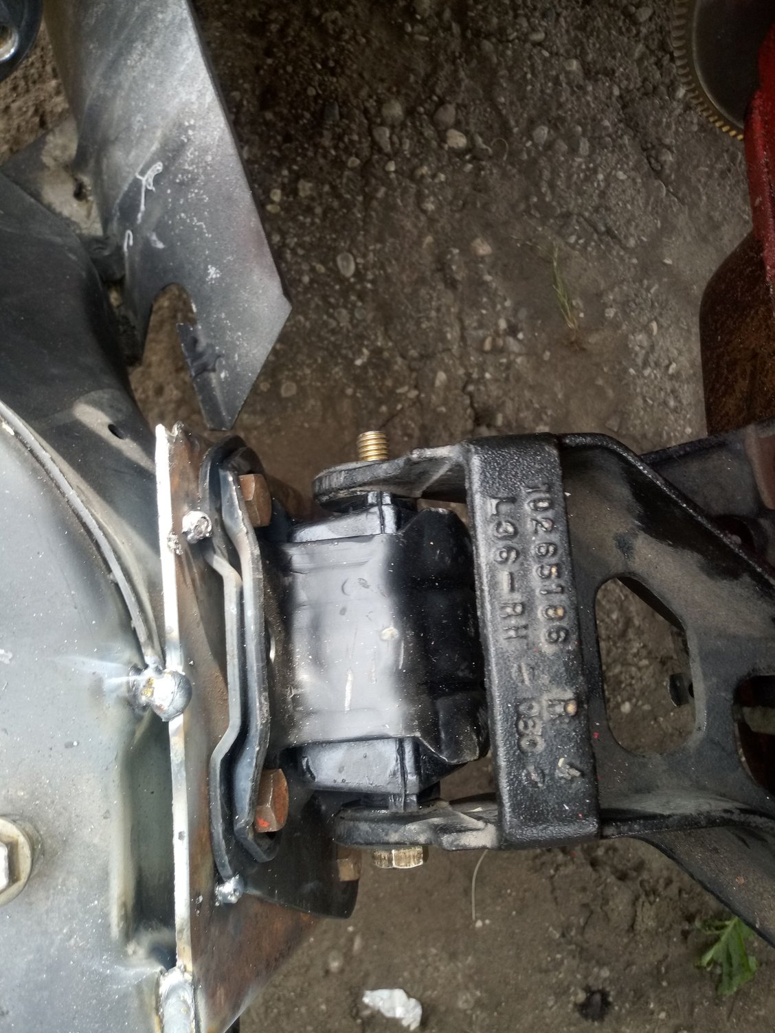

I centered the motor mounts...
Apparently C4 vetts should have the motor offset 2"
So I seem to have some cutting to do.
AC compressor won't fit, need a delete pulley. Since I habe $0 I guess I better work on other things....

Still need to build the turbo pipe but holding off till we get the front downbars in
Ditched the twins. Picked up an ebay gt45 on the cheap. Plumbing is just way easier.
Some more progress.
A few mockup pics. A few completed tasks.
The hotside pipes are a bit cobbled, may have to revisit later but they should function.
Totally ripped out the motor mounts and started over. The FWD motor mounts were going to work, but they got in the way in a couple spots.
