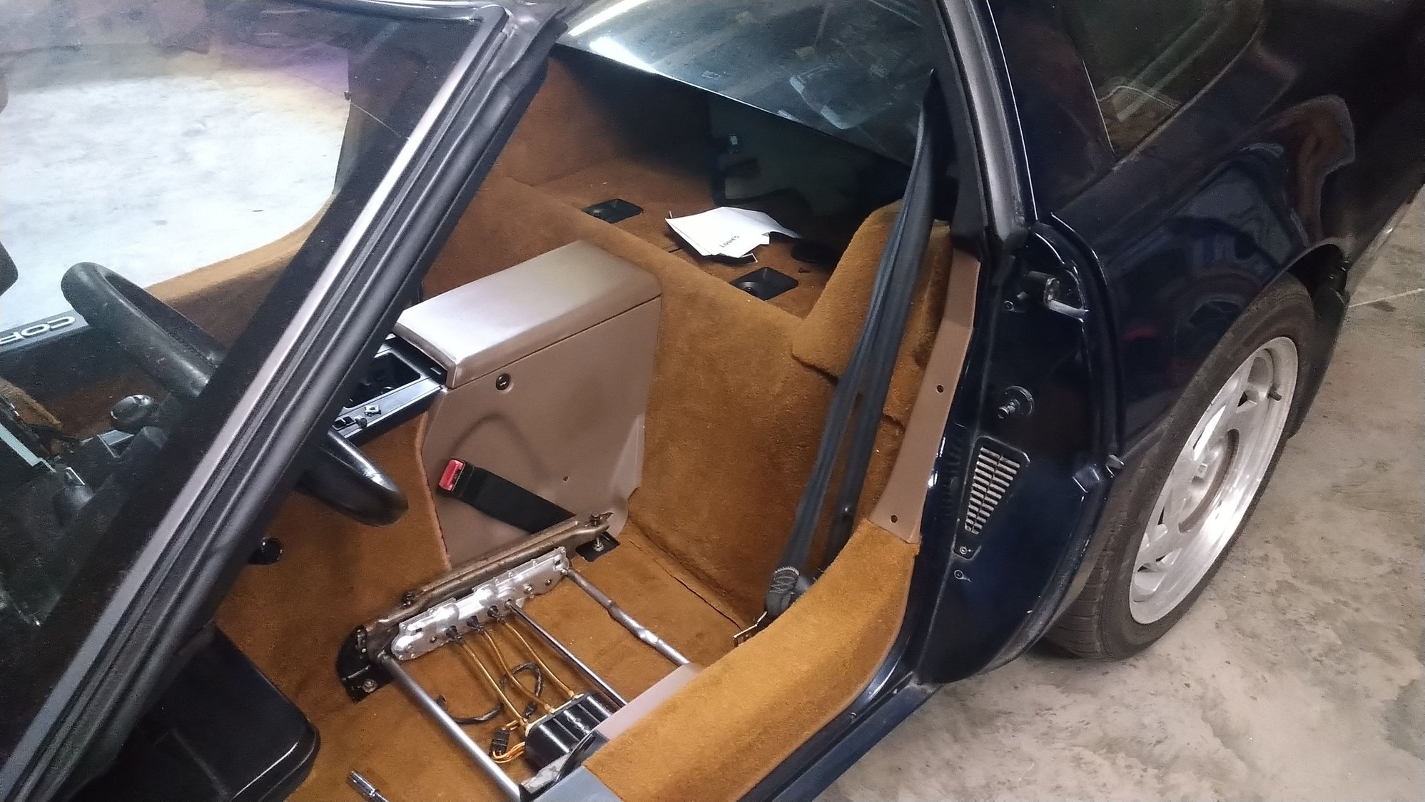

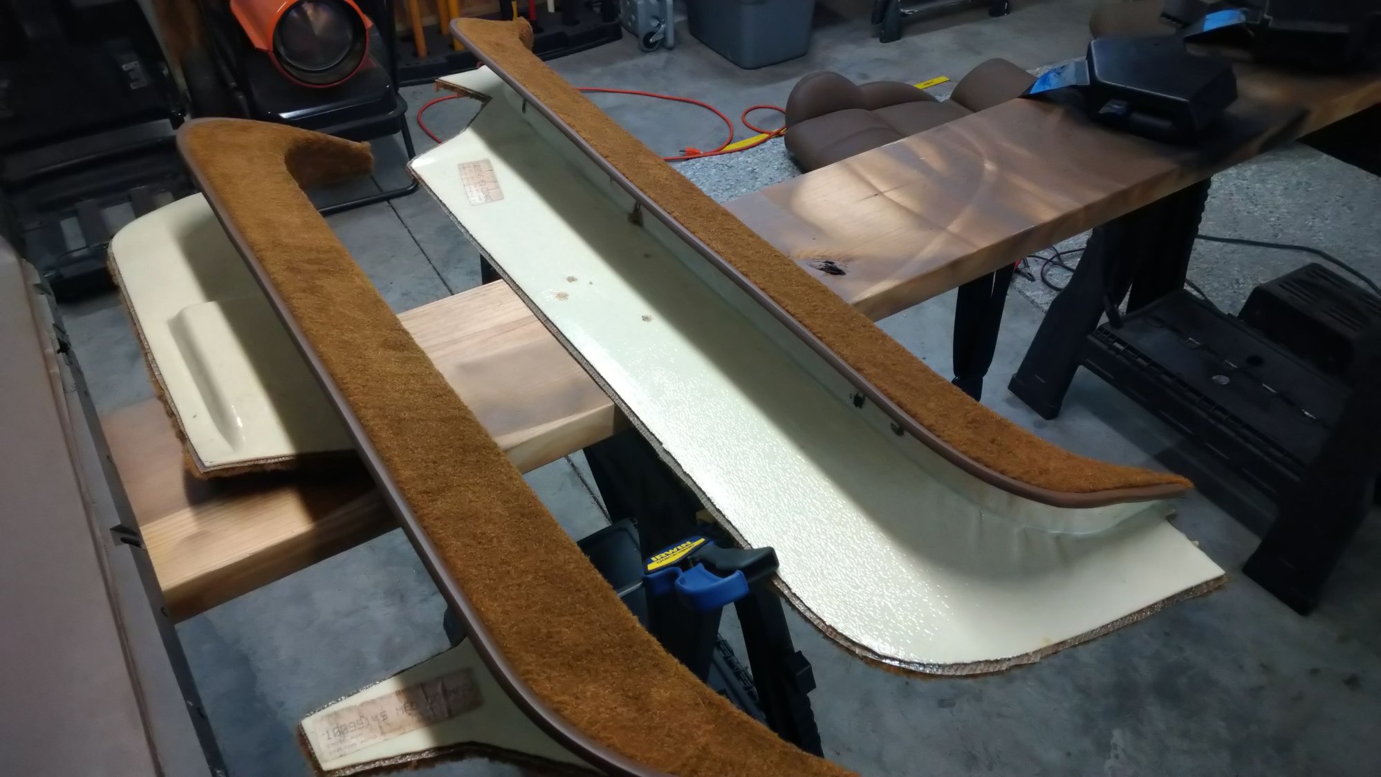

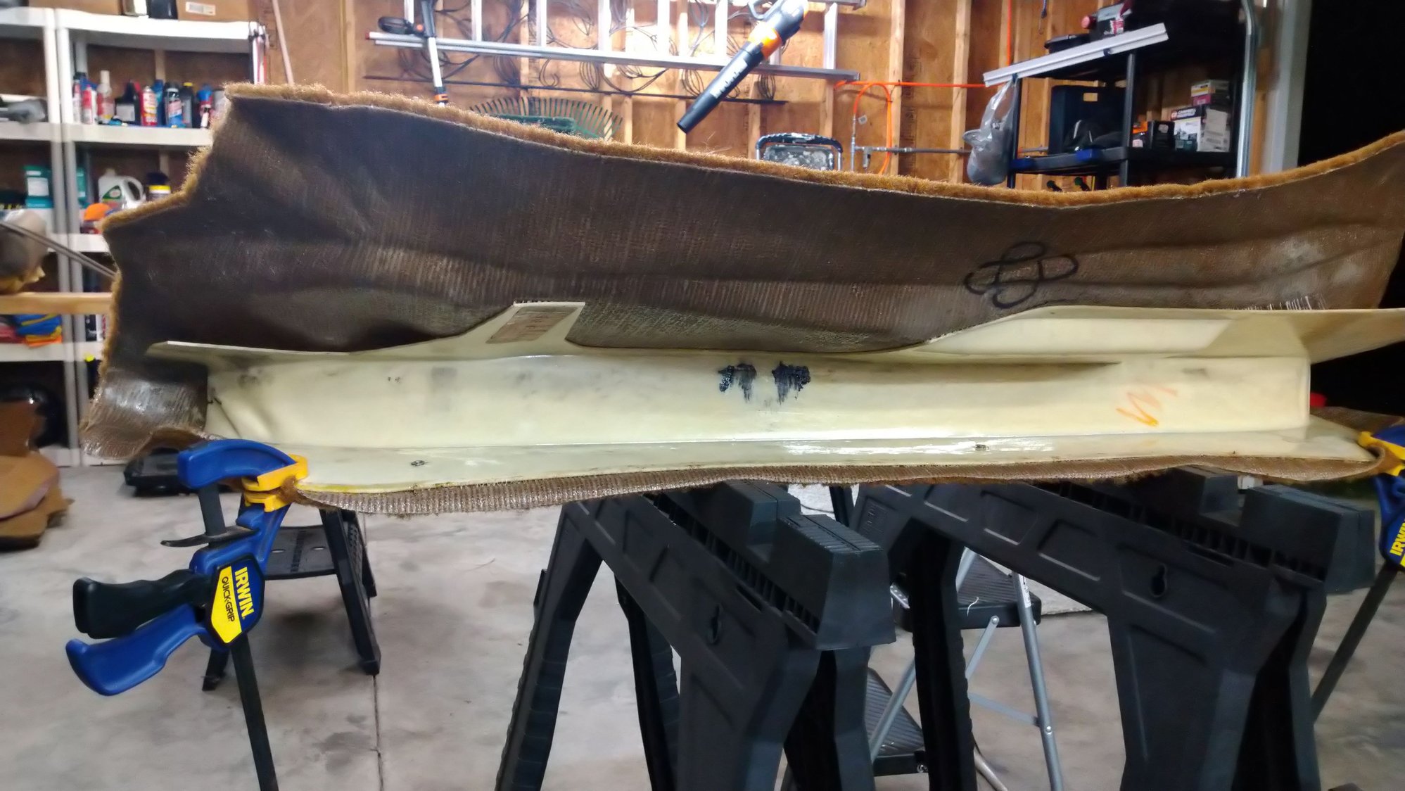

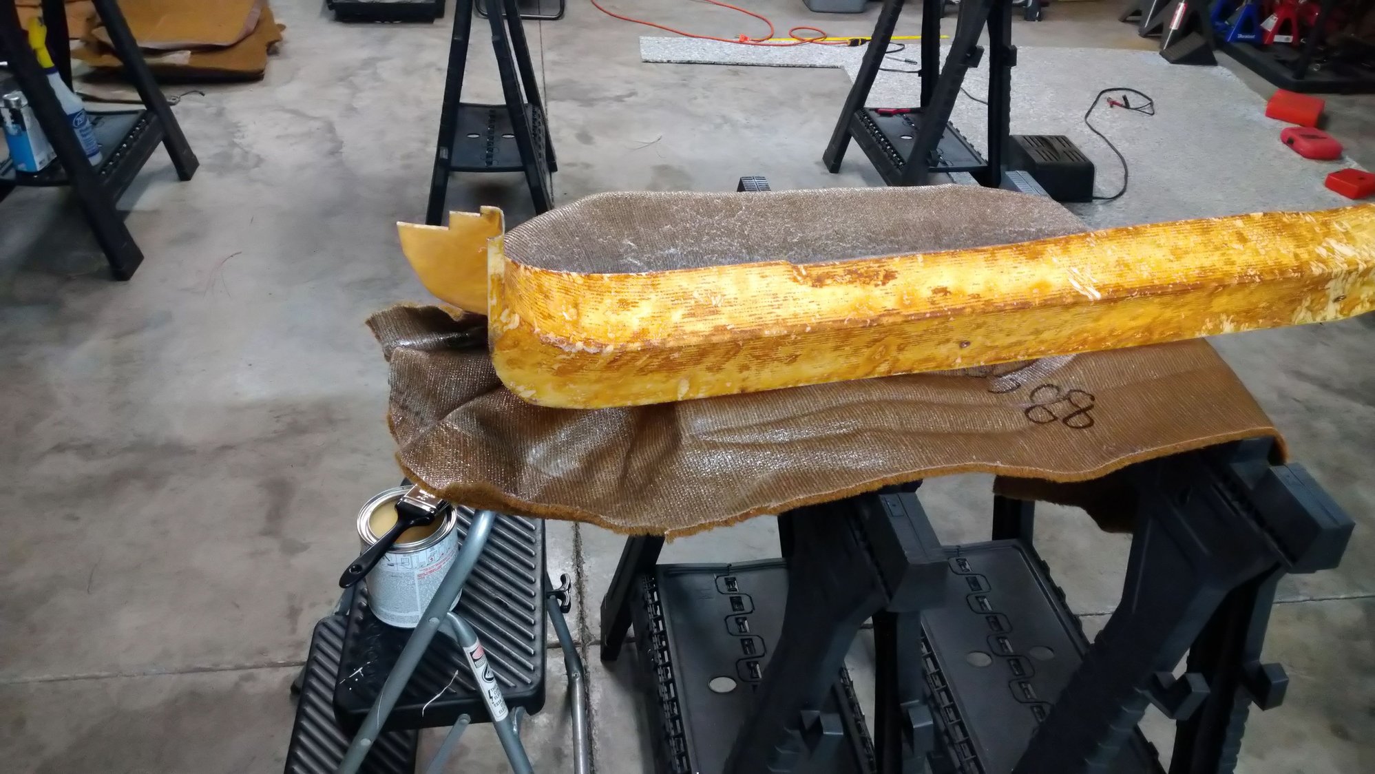

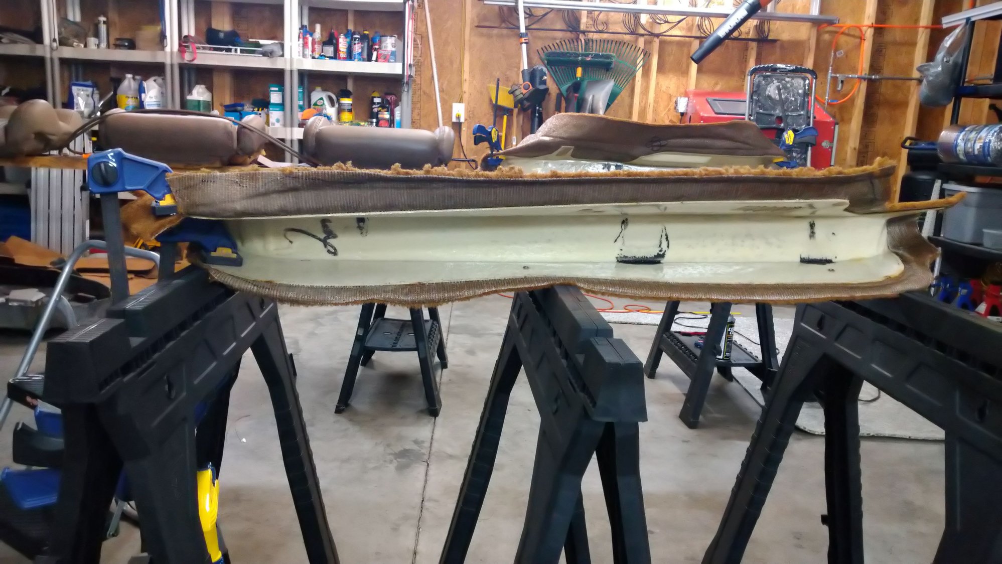

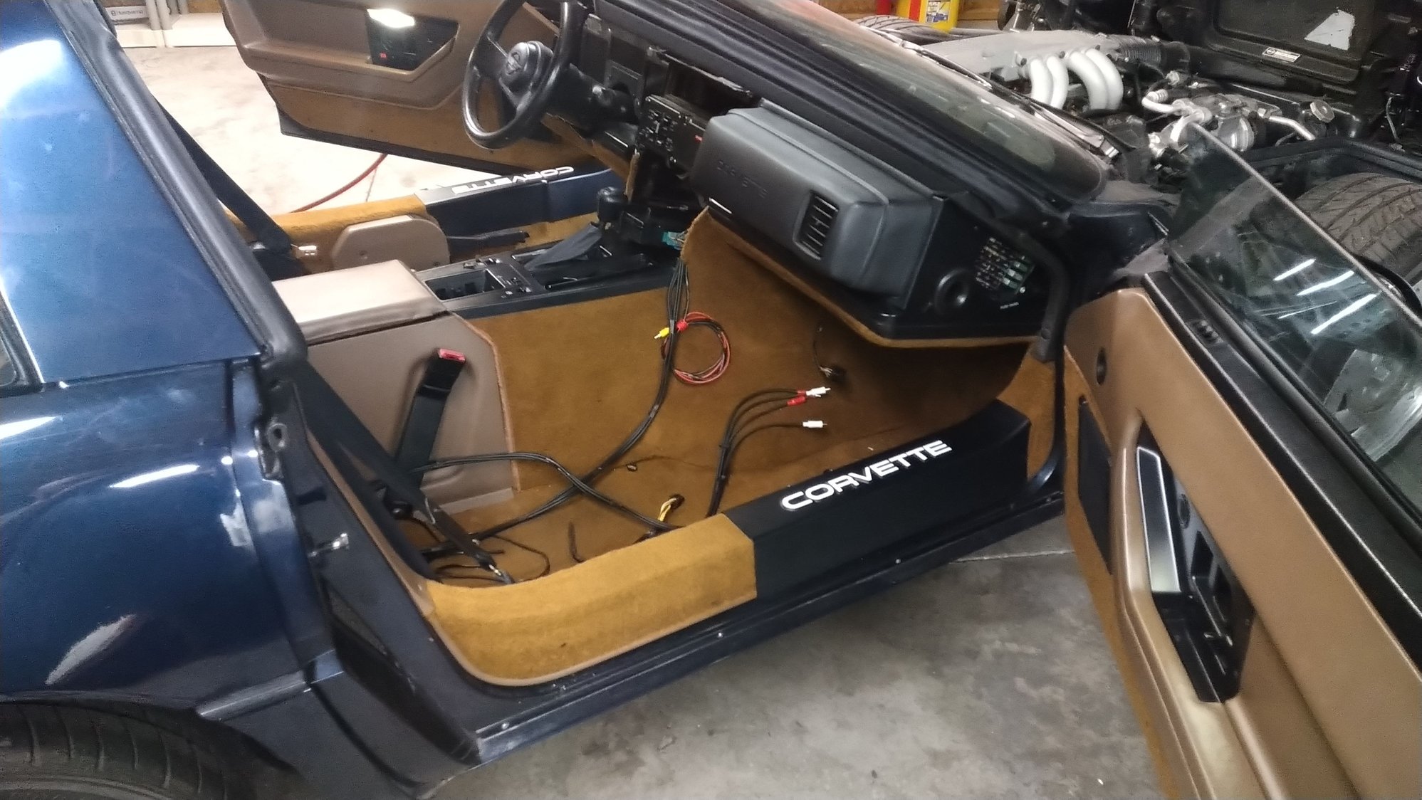

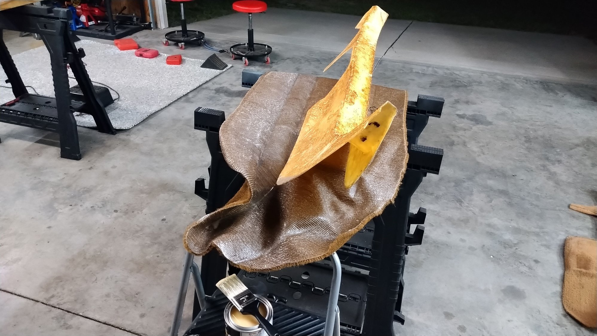

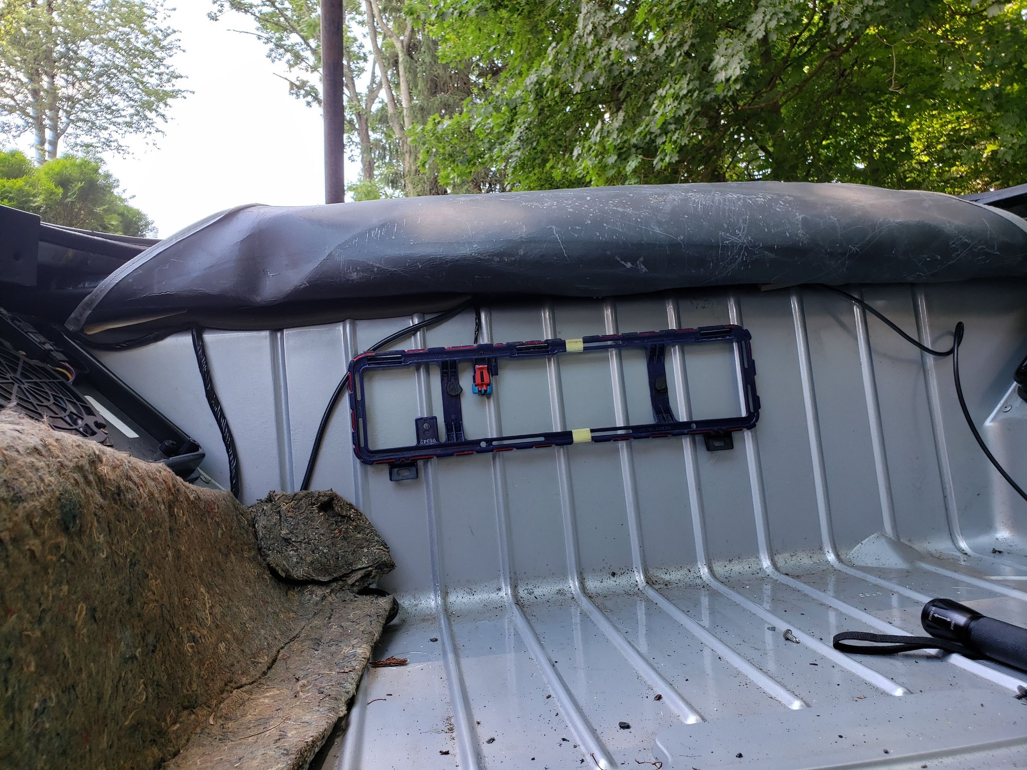

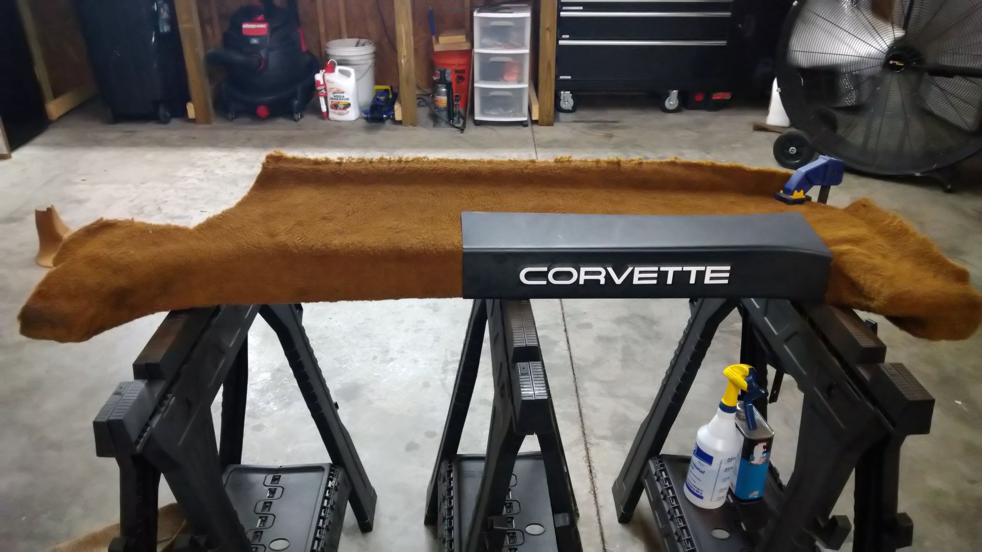

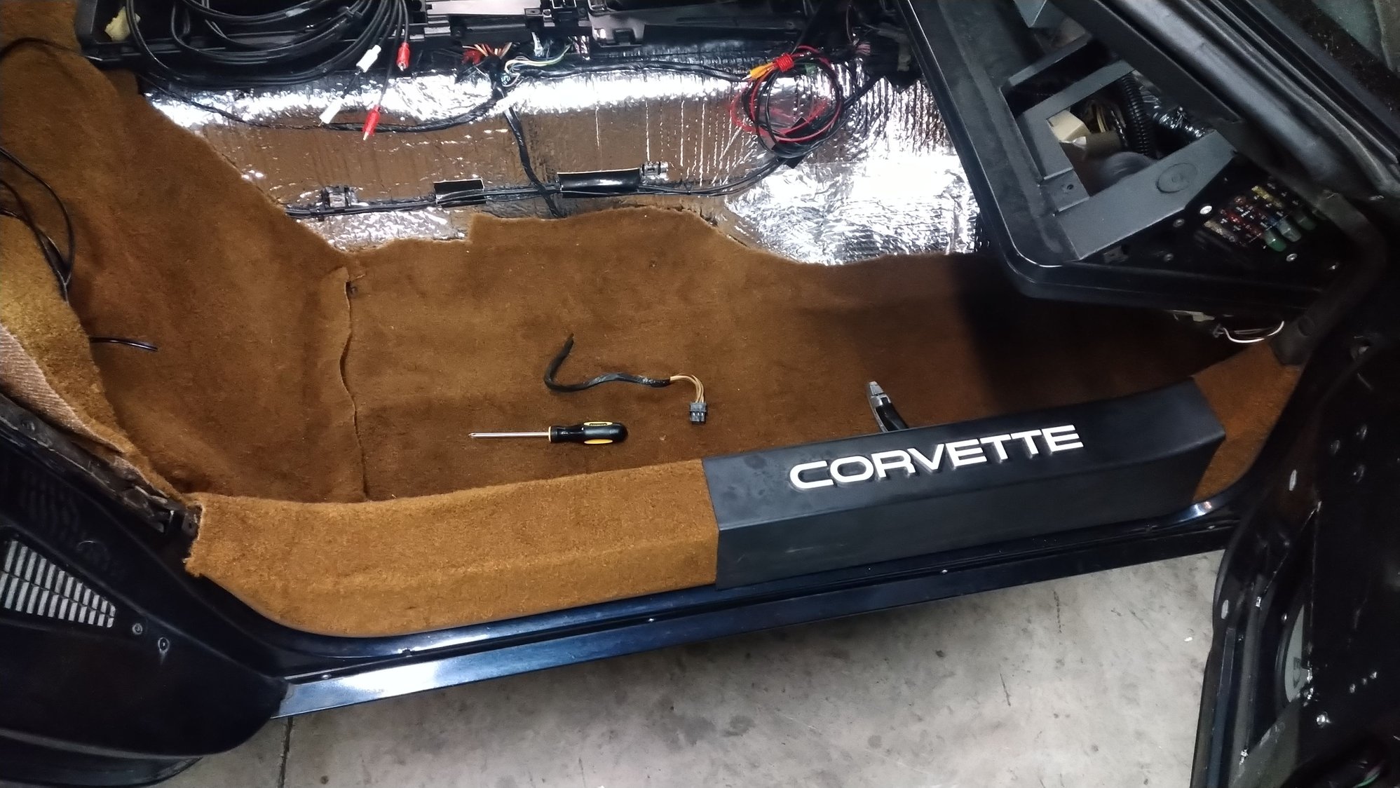

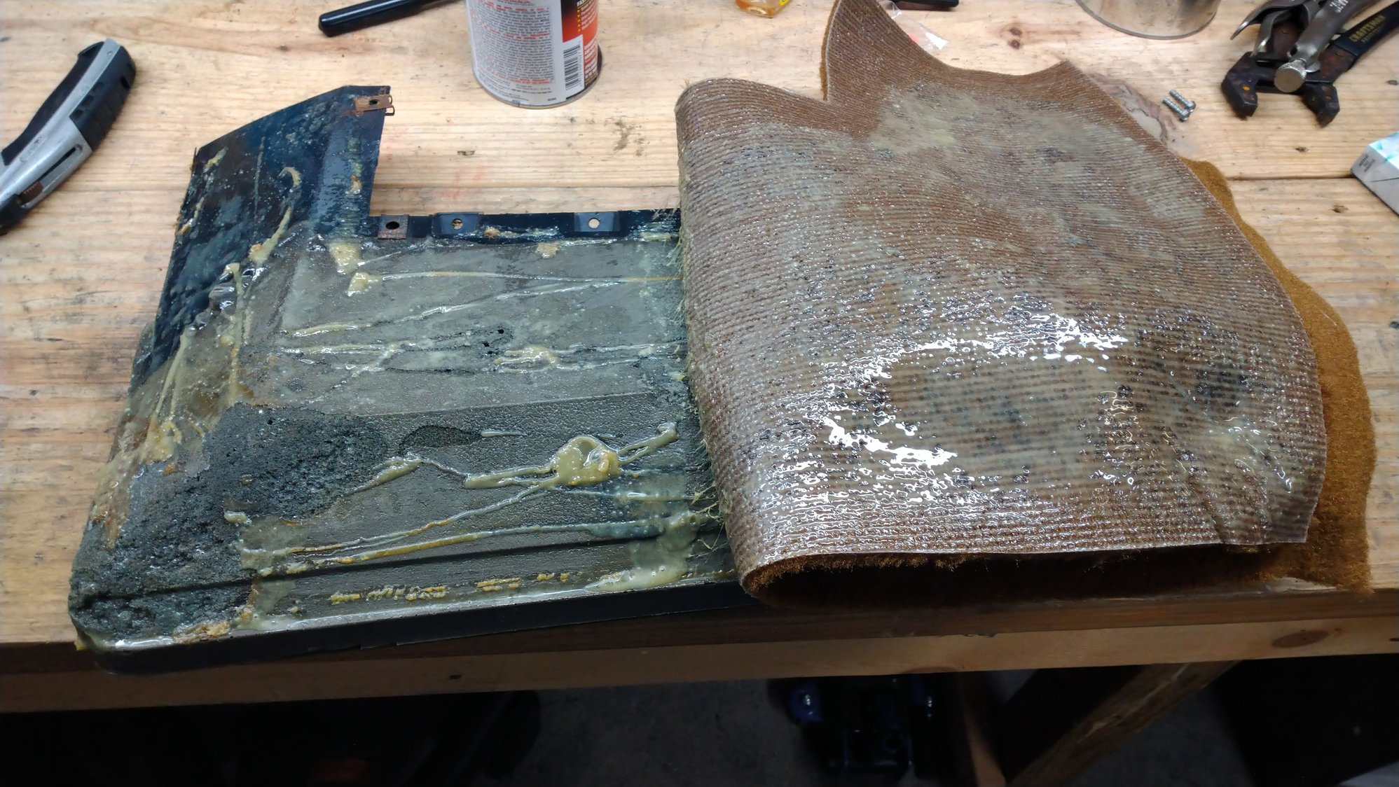

Hey gang I figured I would Chronicle my installation of my carpet set from Auto Custom Carpets. Before I get into too much detail I will tell you that the carpet is of decent quality however, if you read my other post you will know that their ad States the carpet comes with padding but it does not. I called them and they state that they only put padding on the floor carpet and the piece that goes behind the front seats. So I had to go out and buy a roll of jute padding so I could put it in the areas where it was needed. The carpet is a decent fit Straight Out of the Box, put some pieces they cut too short. I had to have them cut me a new piece for one of the knee bolsters which they did very fast. The piece that goes in the hatch that covers the storage compartments is definitely cut too short. Where it lays on the floor and then goes up to the back glass will not lay flat, there is always a curve to it. Below is my progress so far, I just did the hatch area in the area behind the seats for today. It will be a little while before I can post the door panels and the front of the car as I had to order some vinyl dye to change the color of the plastic pieces. They are severely faded and they no longer match the carpet. Also an added note, if you are doing new carpet, pay extra for the mass backing! The original had mass backing, do not get it without. If you have any questions I will be happy to answer them.
Lay it out for 24 hours
New jute padding
Contact cement for the knee bolsters
What a pain
Placing the new jute
It takes time to get it right, you can only trim once.
The lighting makes it look two different colors.
Much better!
Comparing the new to the old sill plates.
Test fitting.

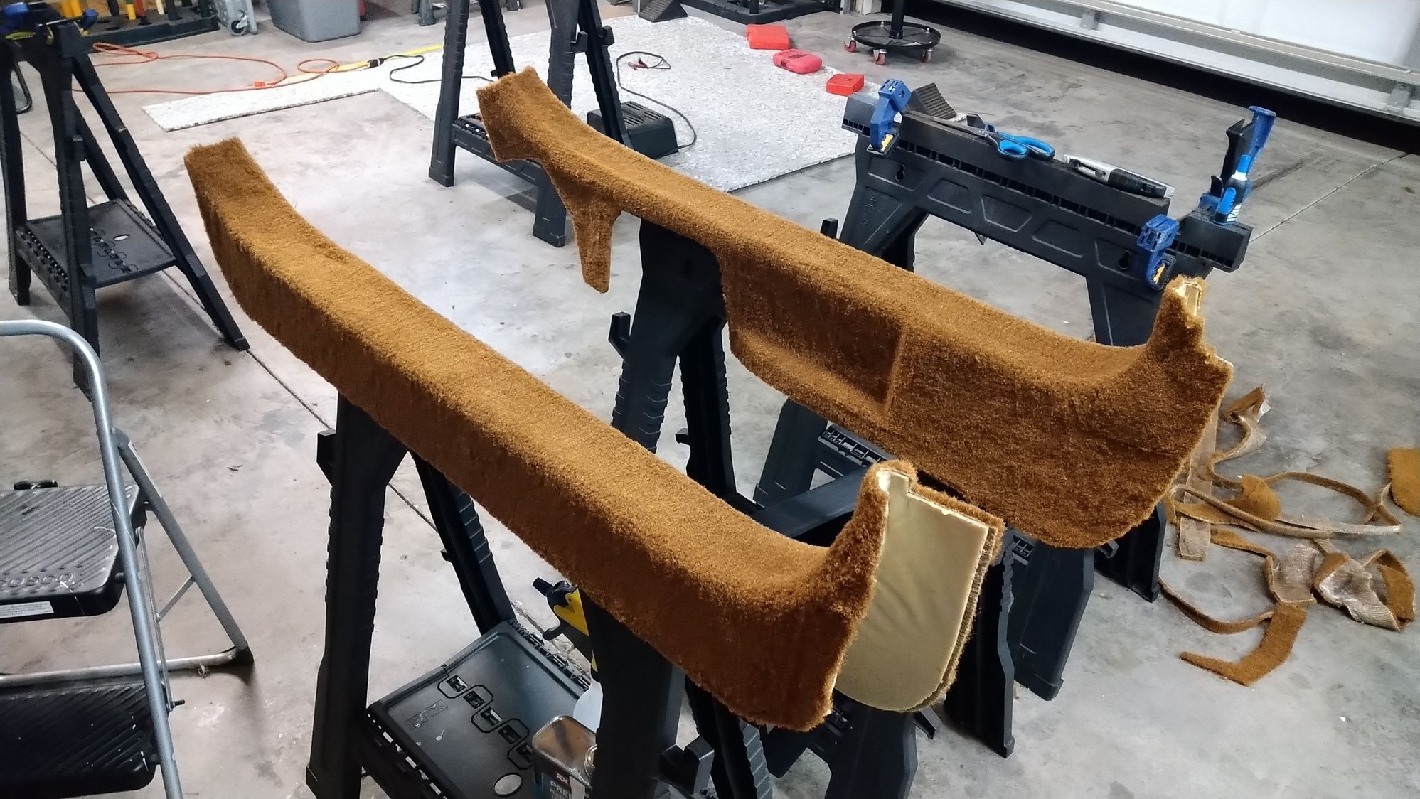

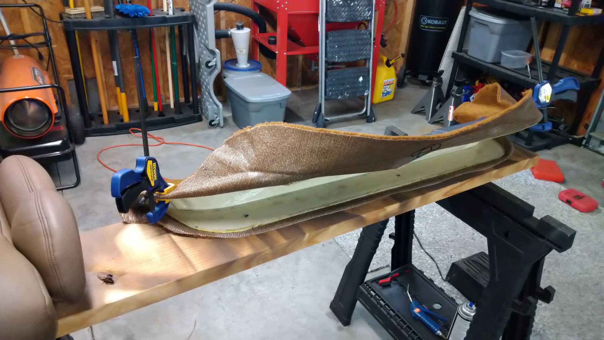

Starting to lay down the contact cement.
A few clamps to hold the stubborn areas down.
And now to trim.
After the trimming.
Had to clamp again and add more glue.
Looking good.
Trim channel back on.

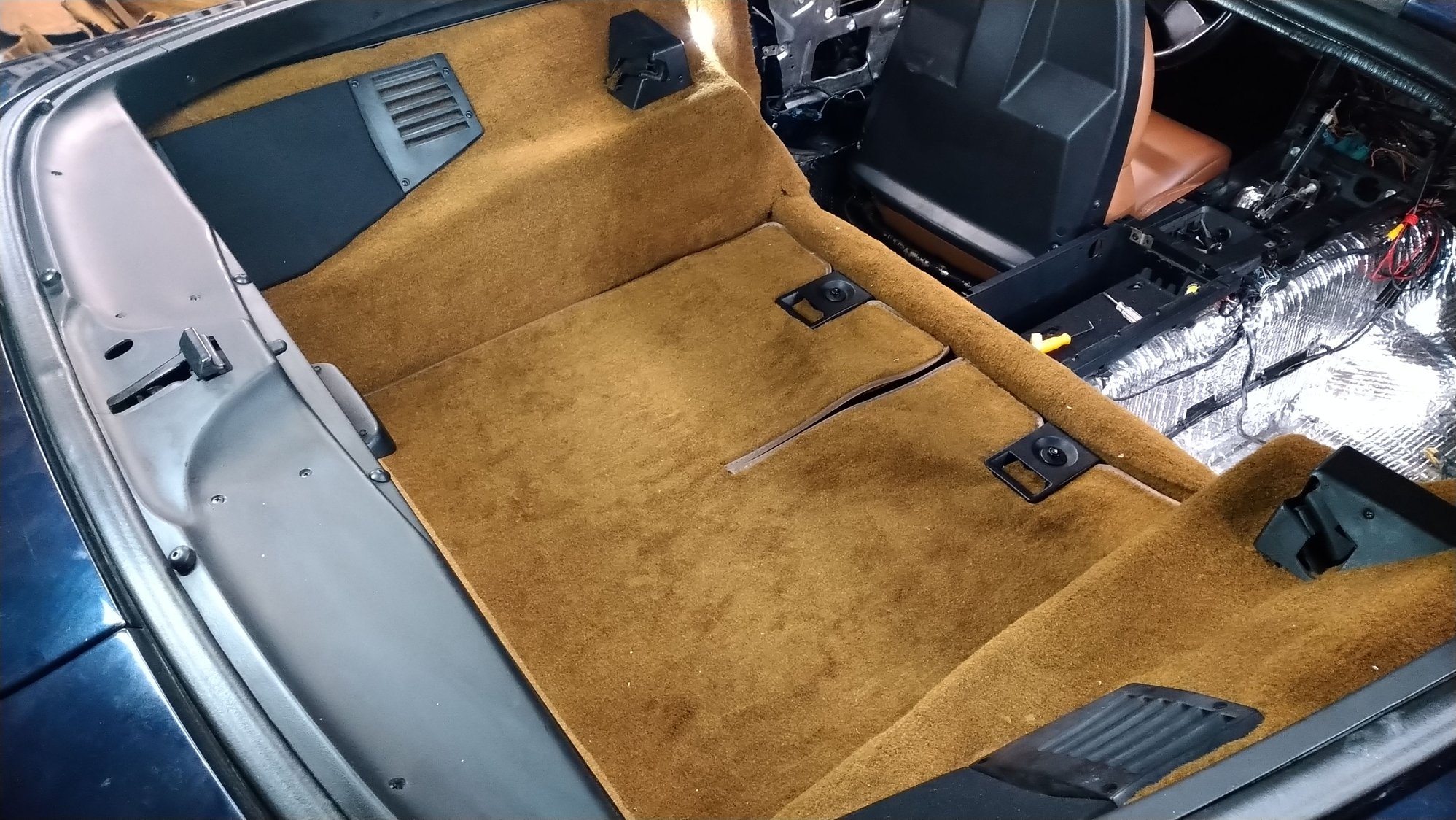

Passenger carpet in and sill plate test fitting.
Passenger floor carpet and sill plate in.
Driver side floor carpet and sill plate in.
Time to glue!

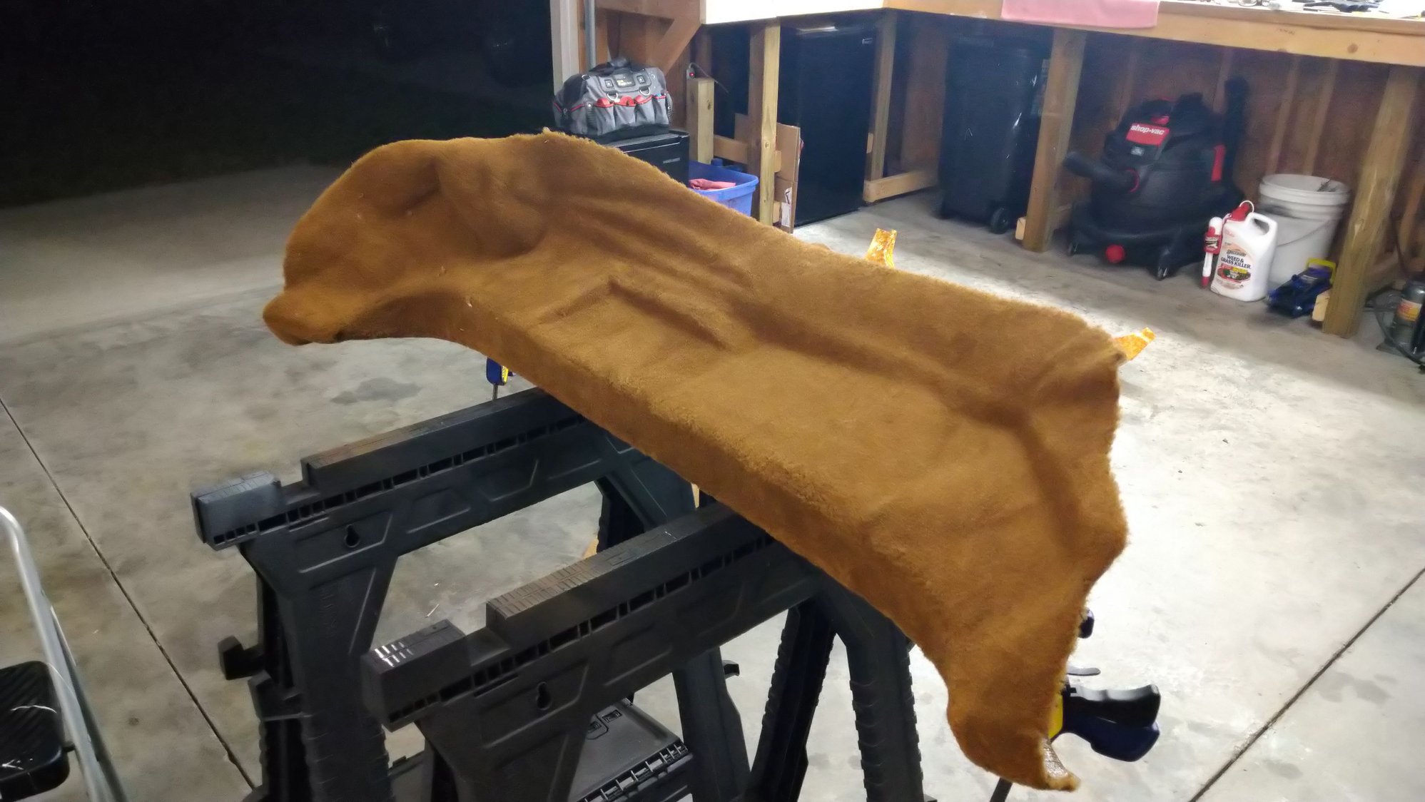

Passenger side tunnel carpet.
Driver side tunnel carpet.
Before cutting the speaker opening.
Finished product.
Here you can see the door panels installed along with the bread box back in the dash.
Shot of the passenger rear.
I just finished rebuilding my seat tracks with new transmissions.
Driver's side rear.

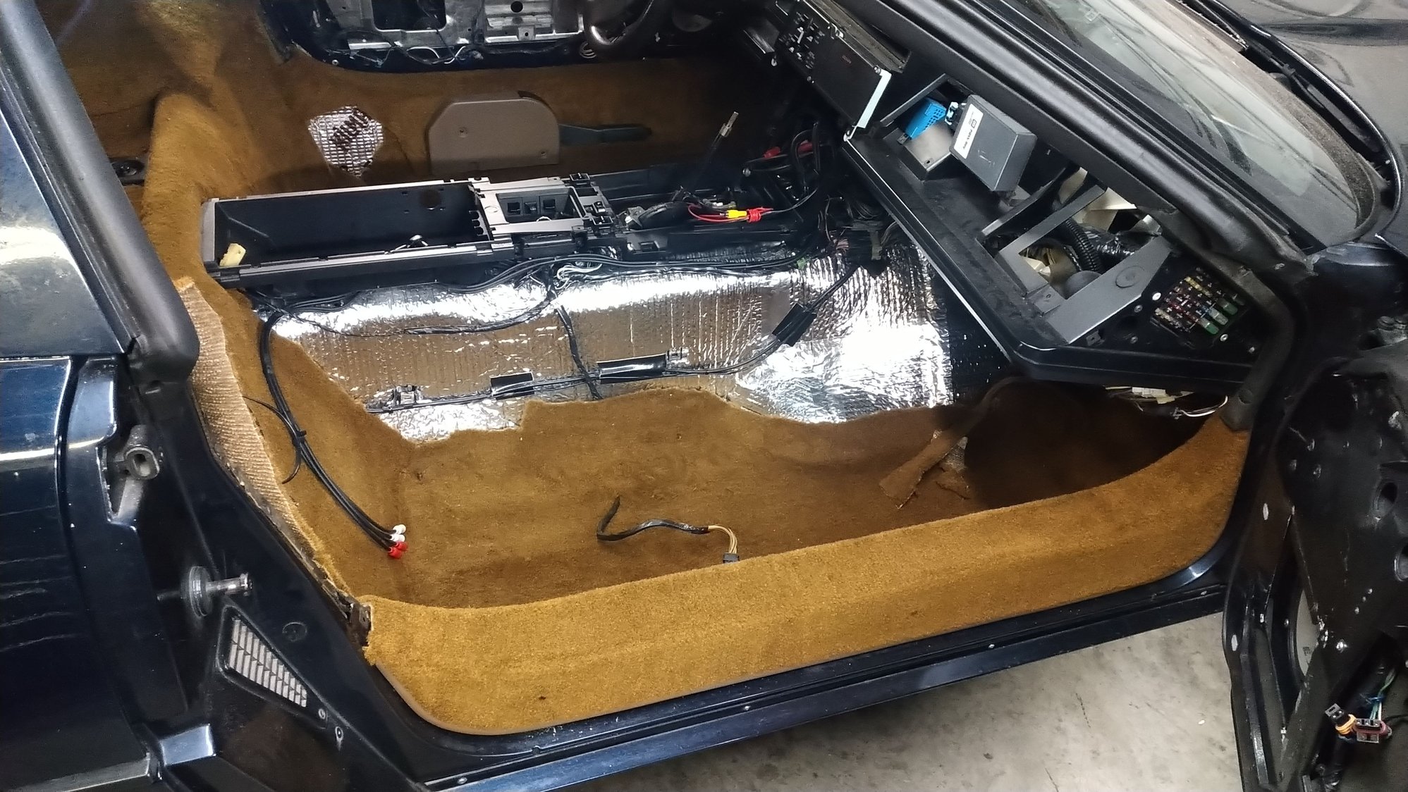

I see heat insulation on your trans tunnel. I'm thinking about the same for my '95. Is this installed in entire cockpit or just the tunnel, and how effective is it? Seems like my heat problem stems from just tunnel. Thanks
Old Aug 2, 2019 | 09:48 AM
AudioObsessions's Avatar
AudioObsessions
Joined: Oct 2018
Posts: 333
Likes: 86
From: Hope Mills, NC
I covered the entire interior with sound deadening and reflectix heat insulation. The more the merrier. So far it seems to reduce heat very well. If you search my posts you will see that I have an entire thread dedicated to this.

Thanks. I will before starting. Goint to insulate when replacing brake booster

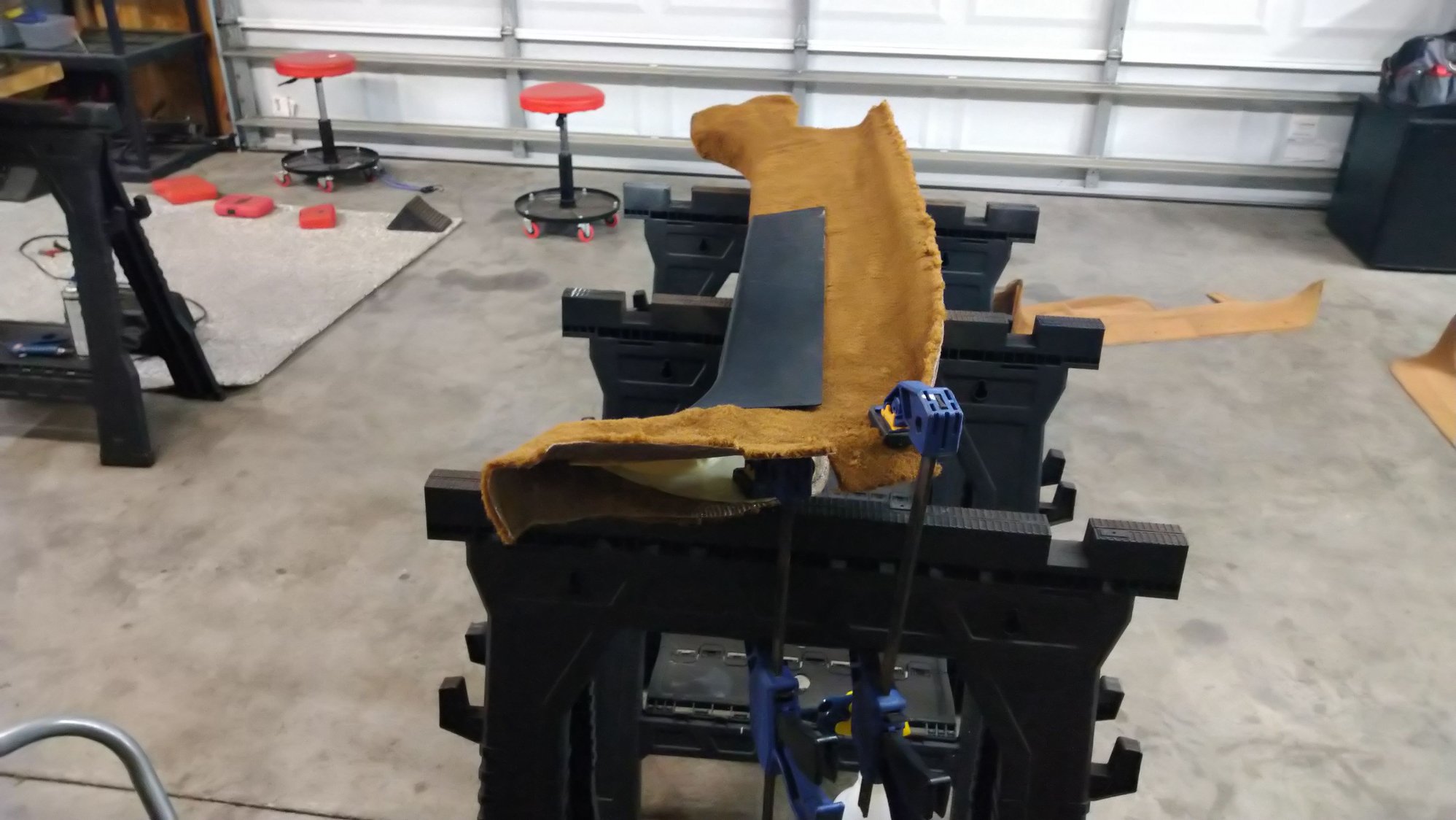

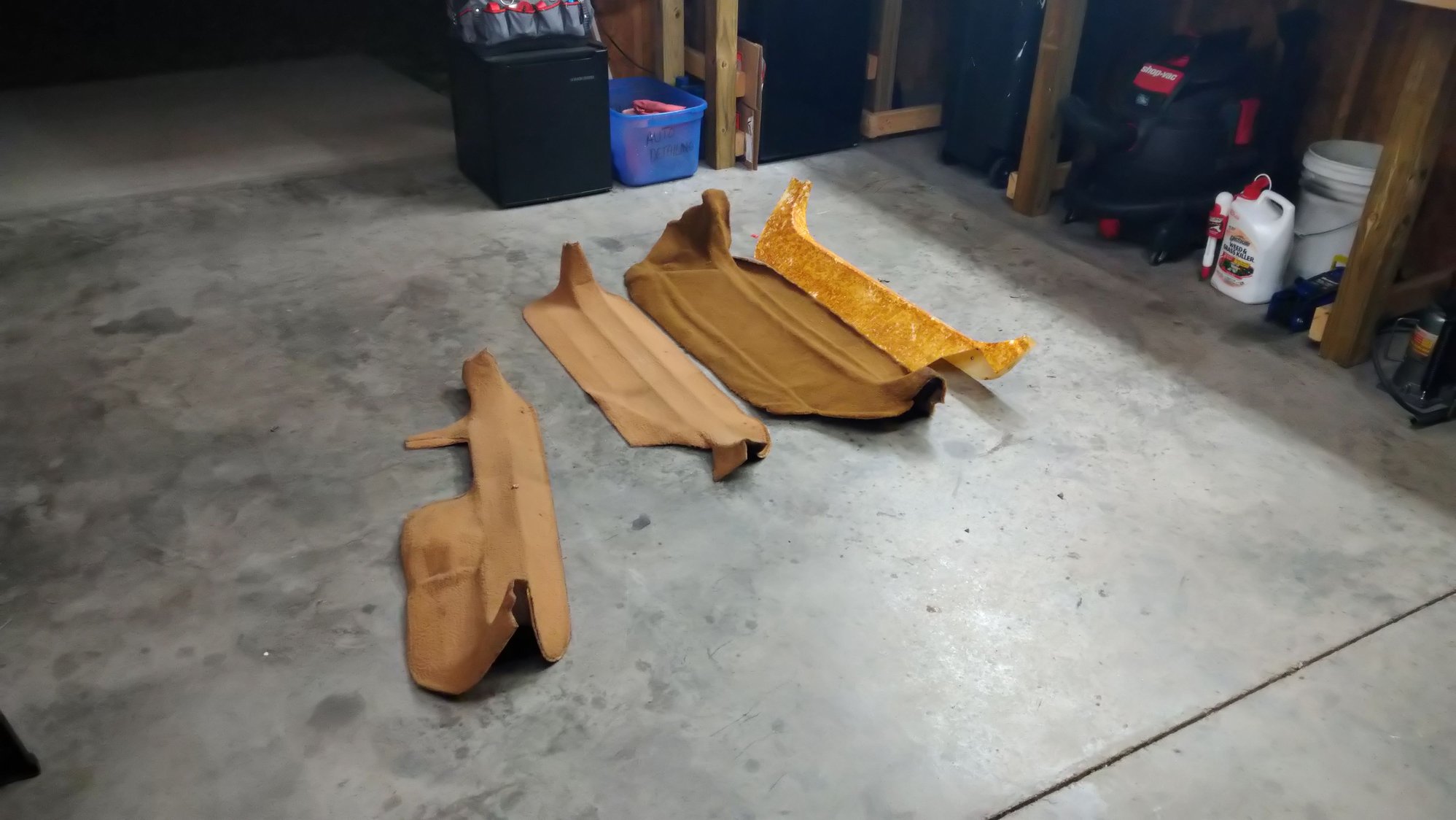

Okay gang I've been pretty busy on my days off however I did manage to get a little work done on the Corvette. If you haven't seen it already check out my thread on sem color coat application.
https://www.corvetteforum.com/forums...plication.html
I got pretty much all of my interior pieces sprayed. I did decide to try to tackle applying some more carpet and I chose the sill plate pieces to work on. If you have never done this make sure that you have time and really good contact cement, and if U clamps won't hurt either. Below you can see the progress from the time I test fitting the pieces to the gluing to the final piece. I have realized with gluing these pieces it's best to do as much as you can and then walk away and let it sit for a day or two and when you come back to it the areas that are difficult to hold down the glue will be much more tacky and will definitely hold. As always enjoy the pictures and if you have any questions let me know.
Laying out the pieces before I get started
Test fitting to make sure they match up
A little bit of glue a few clamps should do the trick
Starting to look like Factory
I put the sill plate covers on just to help hold the carpet down in place.
