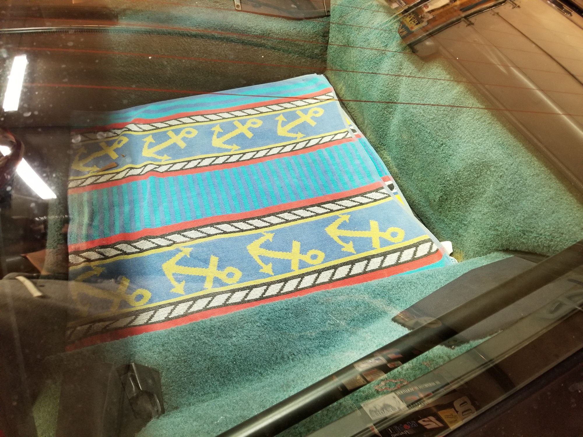

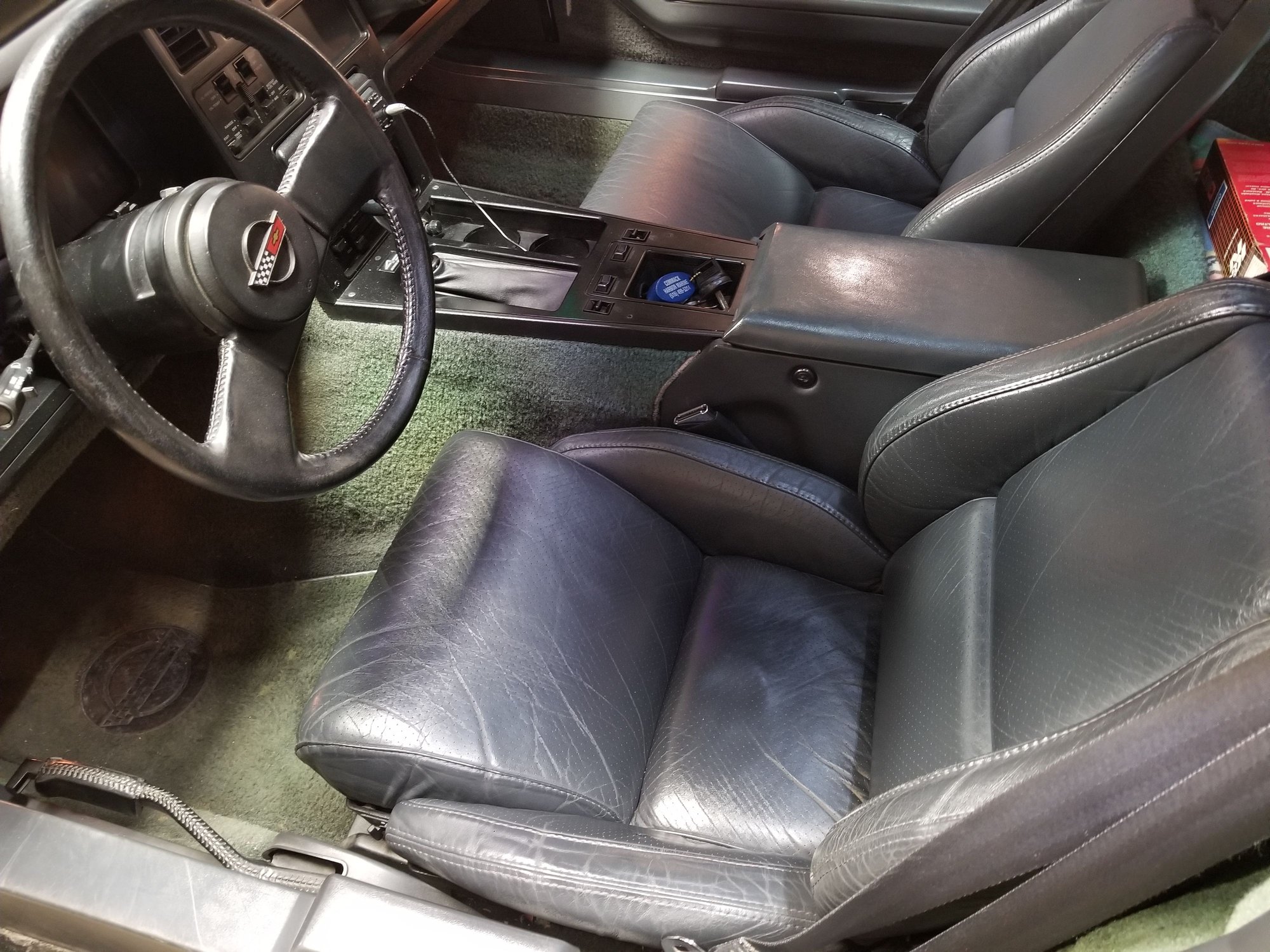

Originally Posted by 84 4+3
The interior isn't anything special. I have no reason to believe any of the carpets aren't original. The only thing I think was touched was the seat covers. But judging by how evenly the carpets faded I would say they're all the same age. Also, aside from the fade, the carpet themselves are in excellent shape and that is the reason I haven't replaced them yet.
The weather stripping needs attention next imo. Also, the towel in the back is to keep dirt out of the carpet. These things fling it everywhere!
it’s not too bad, it’s 36 years old and plastic. Your door cards look good, mine have been bricked and fix by a succession of Luddites. I was hoping for red interior though, black on red look wicked .

But seriously though, interior is in good shape. It was a daily for a long time by the PO so it's expected. It is as good or better than most from around the same time period with 100k miles...

For the age, it's in great shape and could likely be dyed back to the original color. The carpet in my 86 has done the same thing. With the windows open, the fibers fly all over the place. It's quite distracting really. It's time for new carpet for my car. I would also prefer black interior with a black exterior. Just flows together nicely!
