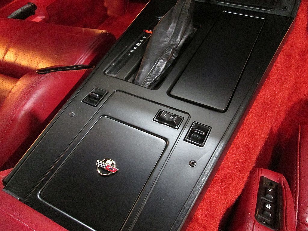

Originally Posted by rhandle
We are all due for Console Refinish. Im sure most of us has that stick feel when we touch the interior. Has anyone here tried a vinyl wrap instead of paint? I think that it would have a smoother finish than sanded and painted plastic
What year console are you talking about vinyl wrapping? I don't think you could get it to look right on the earlier C4 consoles (or the later design for that fact). I used paint on my refinish and it came out smooth as can be.
1 have a 96 . Even my OEM replacement that i had in a closet turned to mush. Yours turned out fantastic

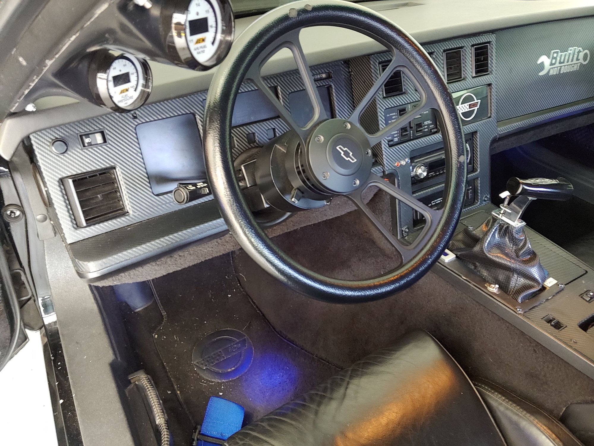

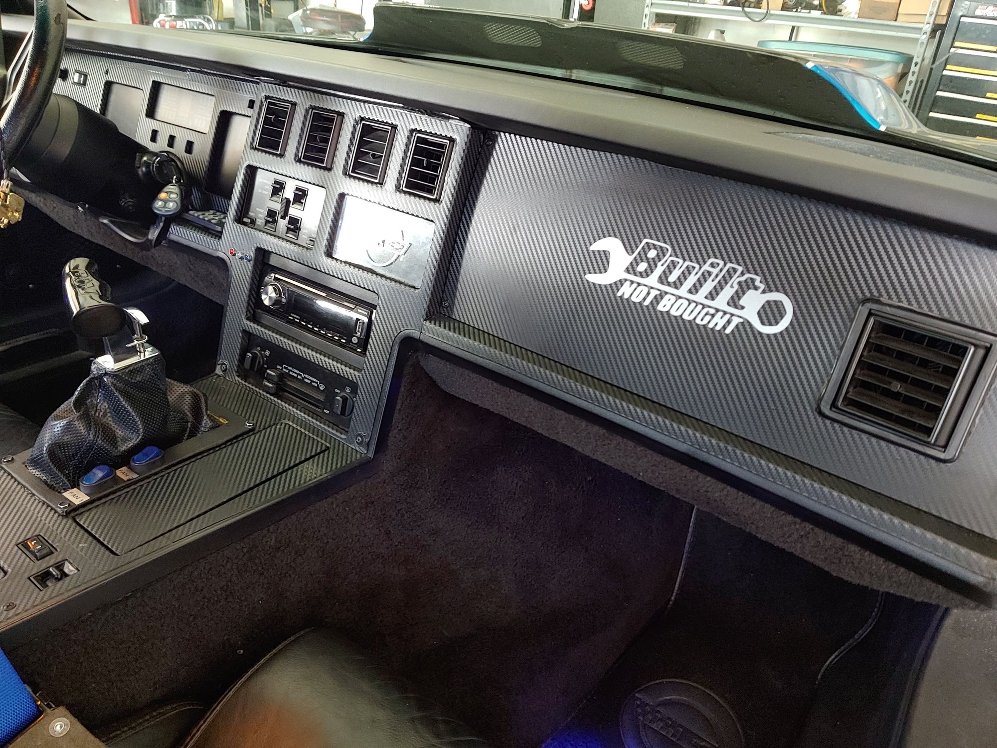

Old Sep 30, 2020 | 02:53 PM
Midnight 85's Avatar
Midnight 85
Joined: May 2004
Posts: 5,866
Likes: 60
From: Hellinois
Finalist 2020 C4 of the Year - Modified
Originally Posted by kenmohr
pics ?
Here you go, keep in mind it is not perfect now, it has been on the car for at least 5 years so wear and tear spots are showing,,, and, the floor is dirty, hahaha
this looks really good for 5 years old. I was just thinking about vinyl wrapping my 84 dash in CF. I also like that shifter, was that a difficult install?

That wrap looks great
