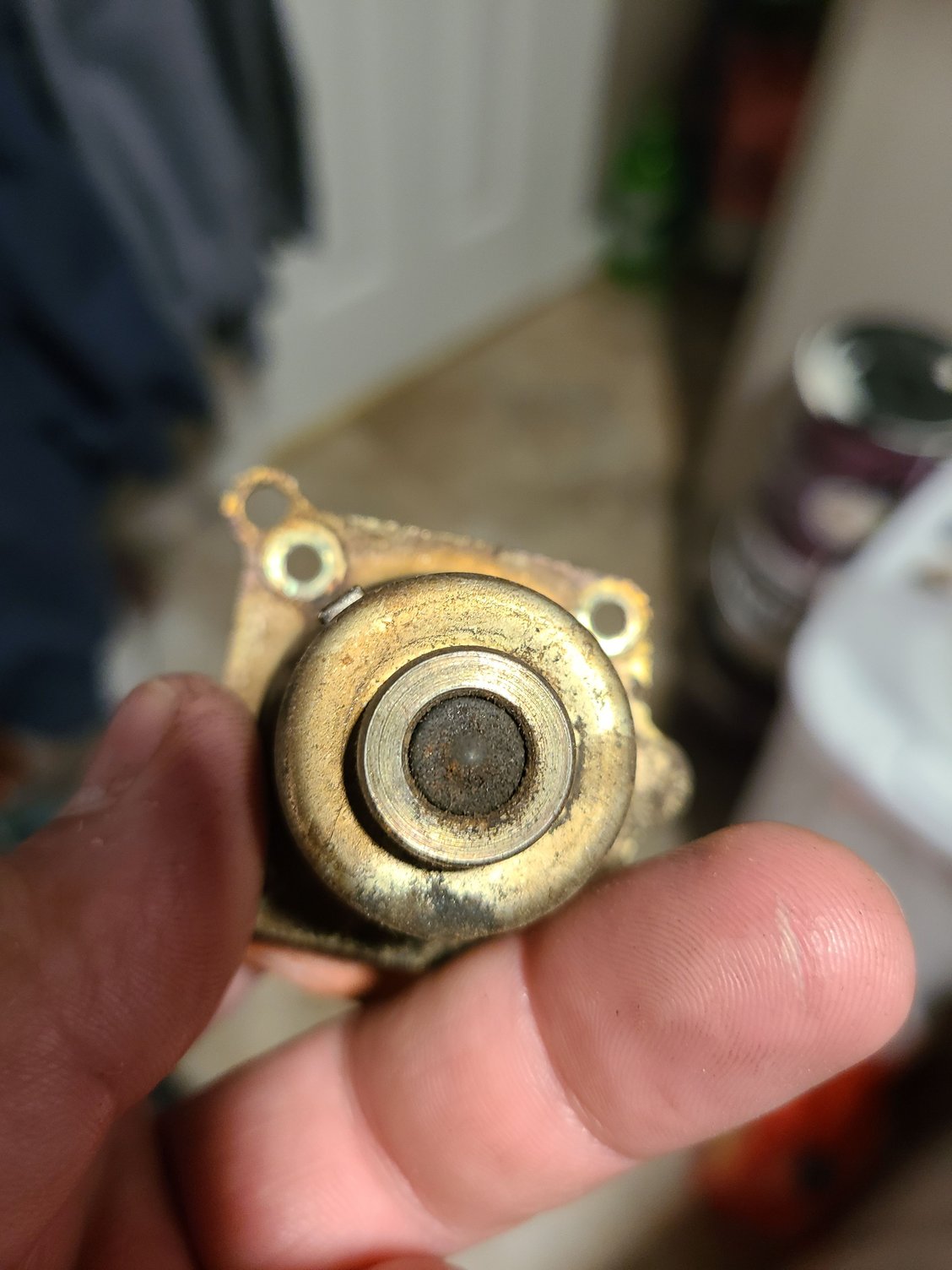

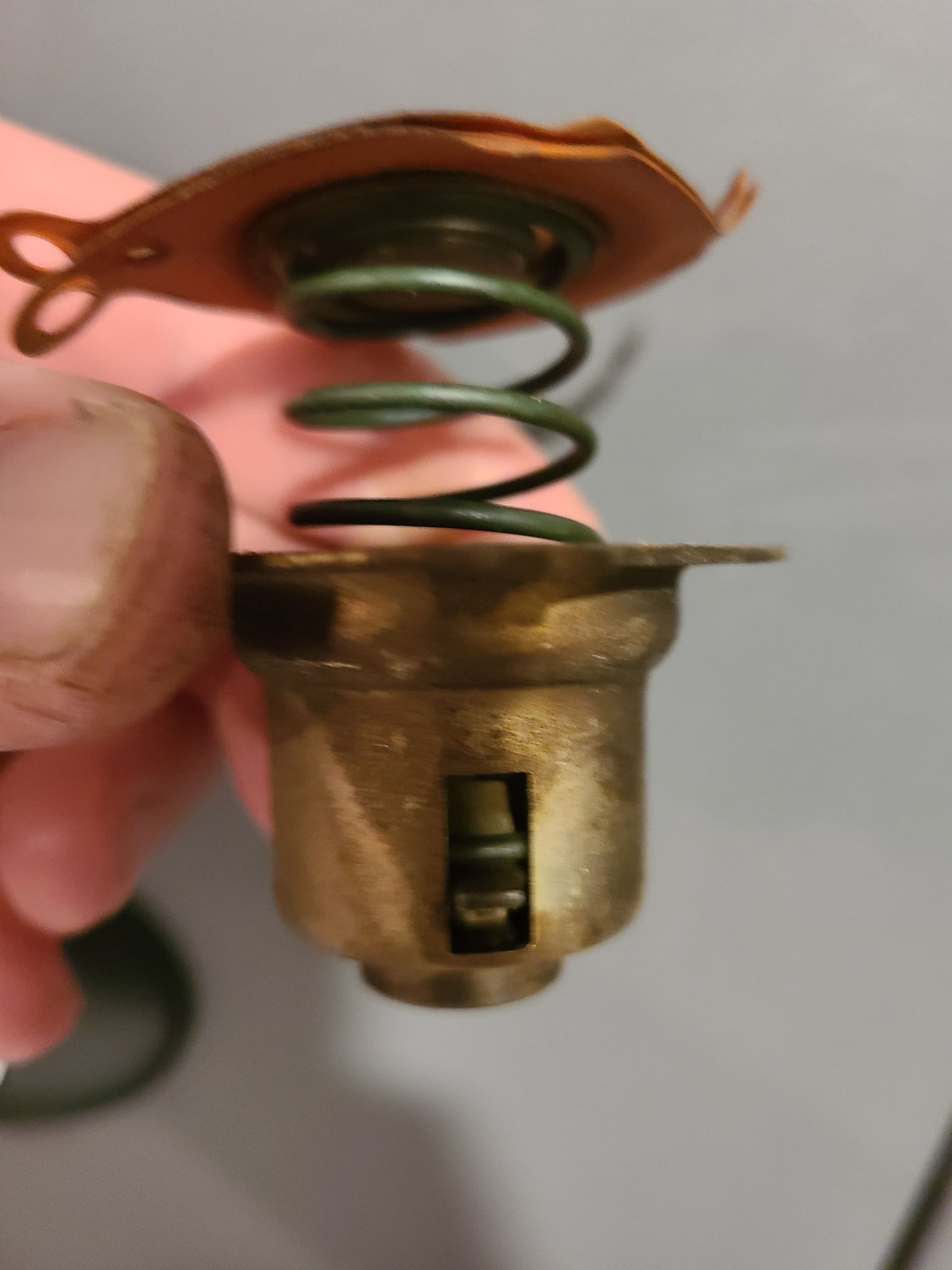

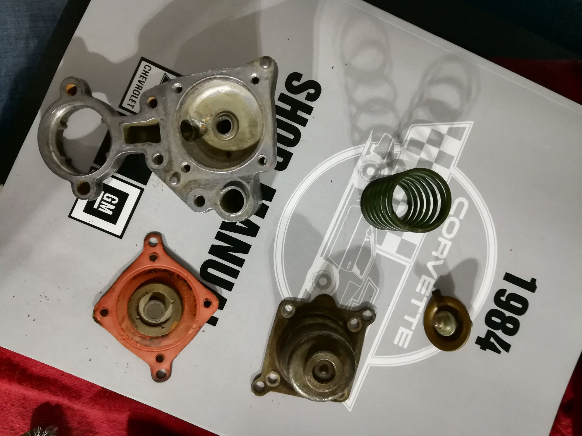

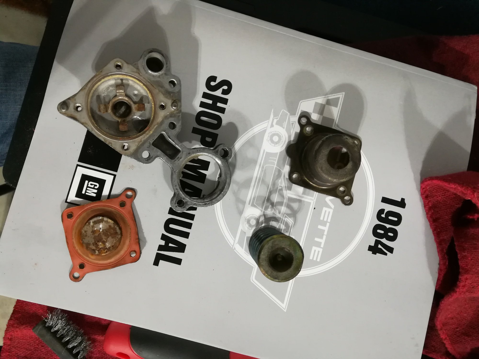

The black gasket is used on the single TB version used in 4 cylinders. You should be okay pulling the TBs. They have indexing pins. The link and sync will stay pretty close. I've done it.
The pod is set at the factory for the bladder. But all you're doing is reassemble with the new parts and the old spring so it isn't an issue. I attached photos showing the pressure regulator and the tamper plug.
You just put it together like that again and you're good.

Thanks for the help, the fuel line is off and I've cleaned and refreshed the regulator and accumulator.

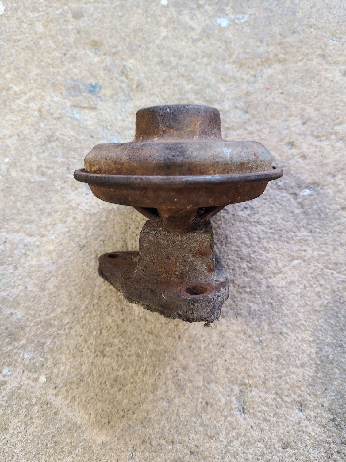

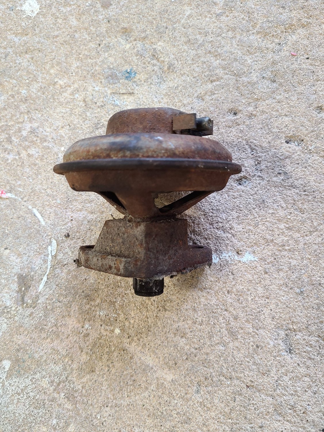

The intakes are all the same. How could the EGR valve be different? Unless it's the control valve not the intake mounted one?

It's the intake mounted. I believe that since it won't be registered in California, the "Federal emissions" part will be fine.

I have a working one if you would like mine.

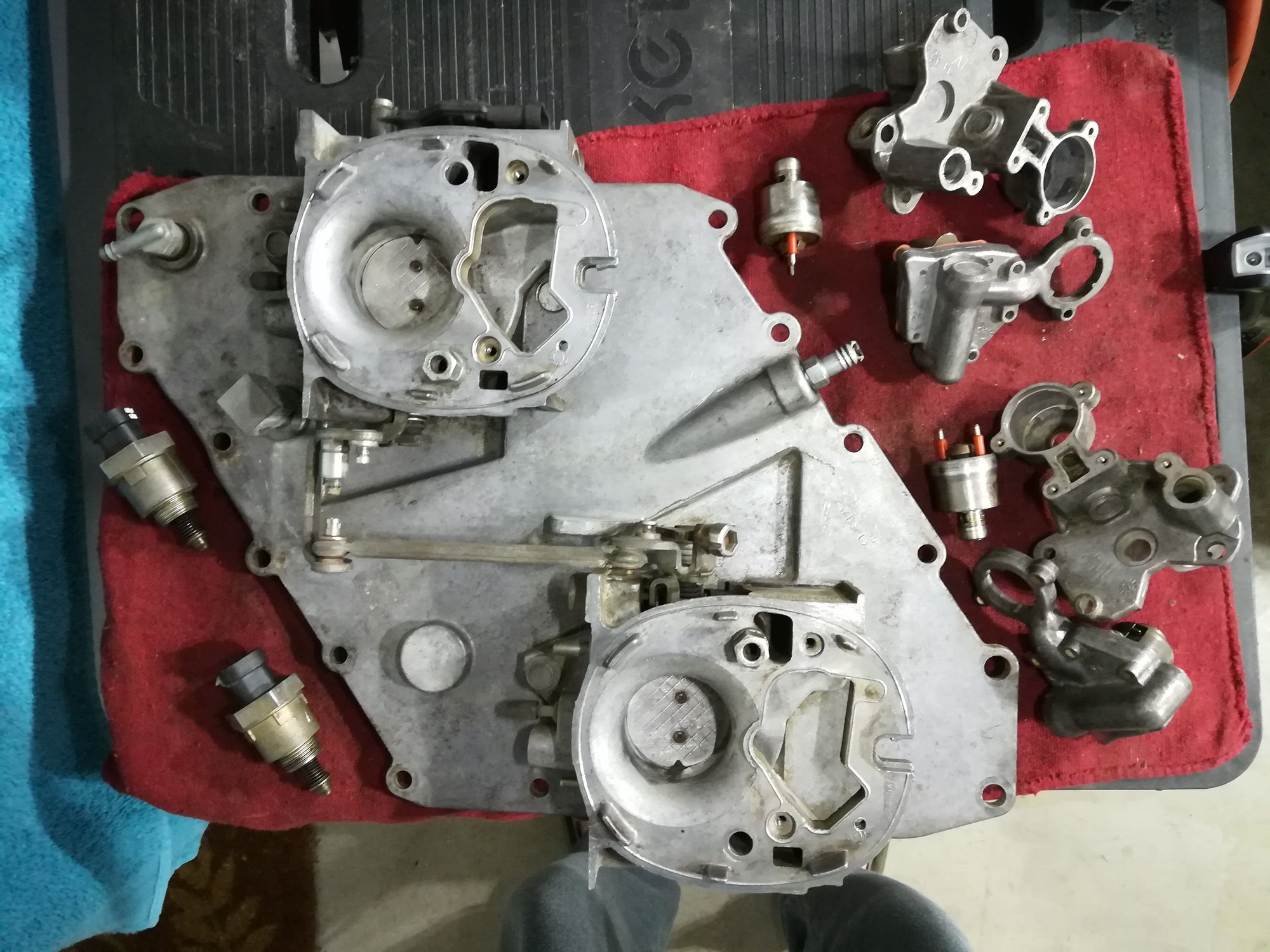

Default Before and after
Cleaned up much better than I feared. The gasket between the manifold and lid should be here this week.
I want to clean up the valve covers while waiting on the fuel tank sensor/filler assembly. How much of a pain is it to remove them? Any tricks or traps to be aware of?

Heck yeah! Looks killer! What a radical improvement.
Valve covers come off easy; 4, 11mm or 7/16 bolts on each cover...lift 'em off.

All good. That one does 100% function. I checked lol.
All good though. Figured I'd try since it wasn't of use to me.

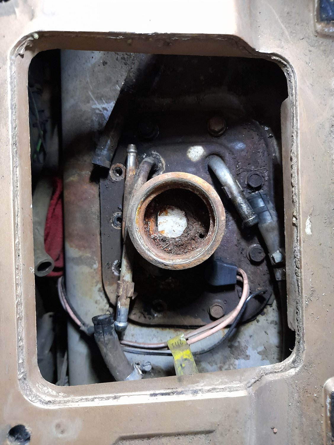

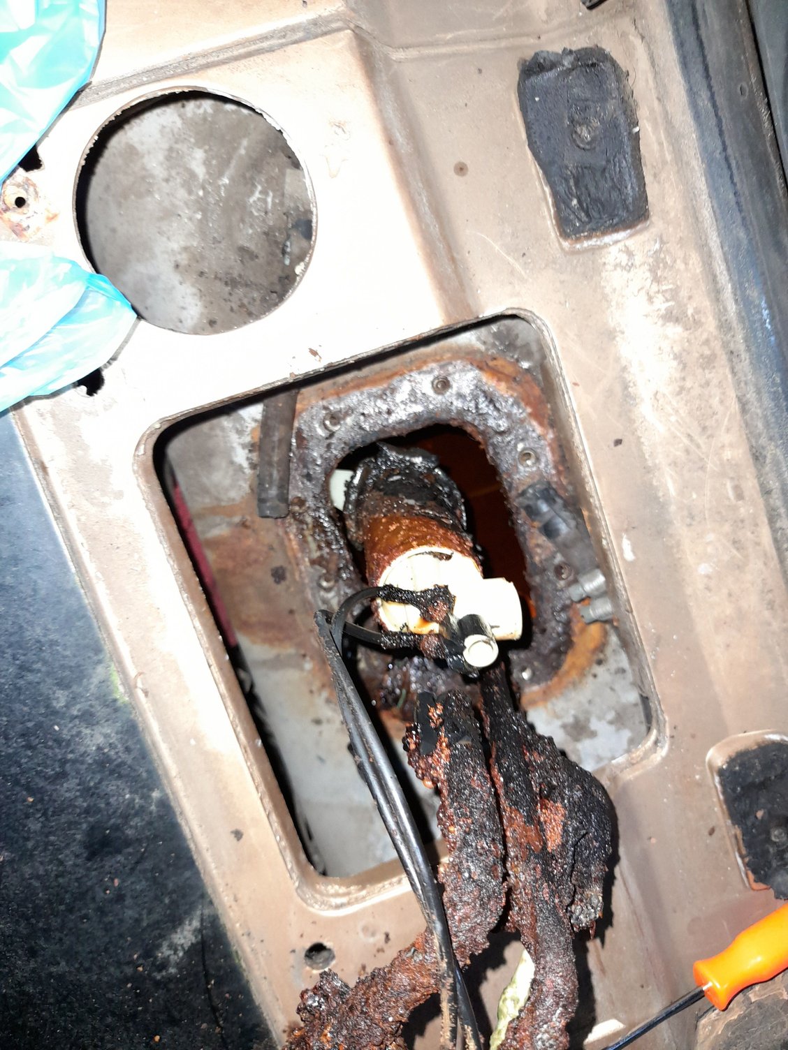

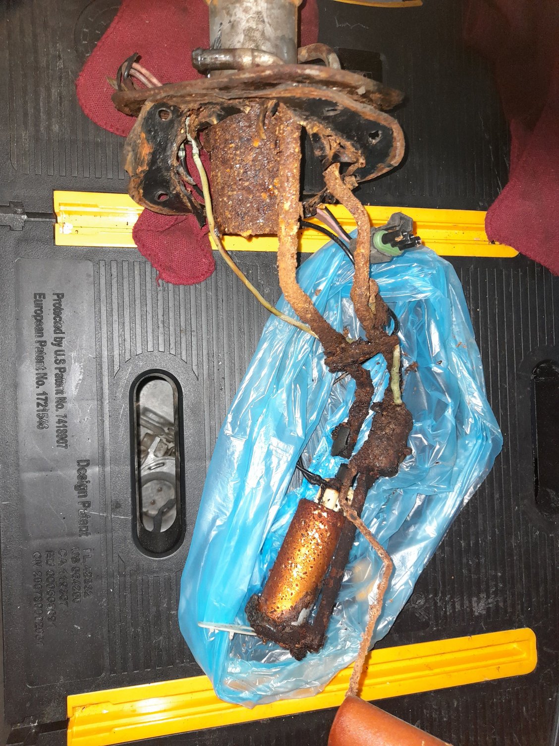

Default Fuel pump extraction - not for the squeamish

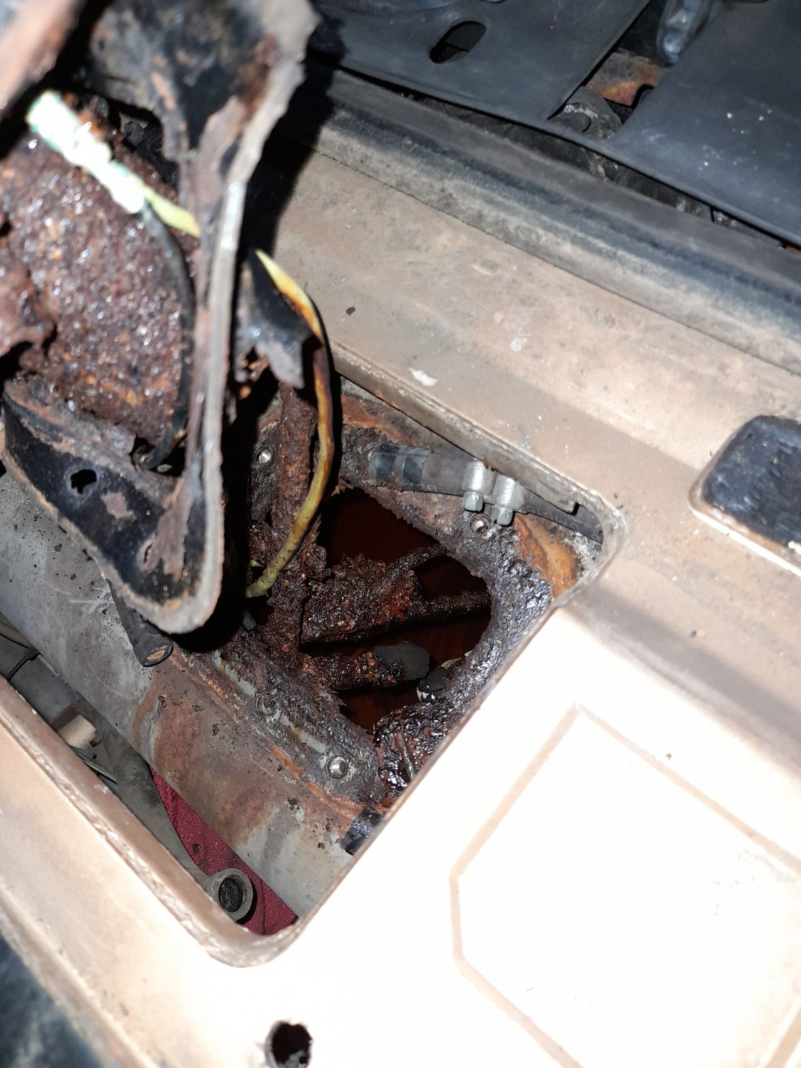

Pulled the fuel filler/pump out tonight. OMG, here are a few pictures. In the last one you can see the crap in the bottom of the tank. From the condition of the filler/pump opening it looks like I just need to replace the tank - recommendations/hints/tricks? All wisdom (and commentary) is appreciated!
