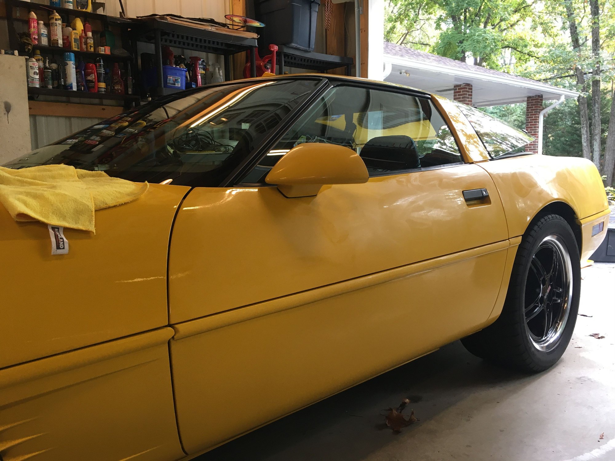

I was waxing the 96 and buffing off the hood and I heard a noise near the back. Walked back and found that the hatch had popped opened on its own. I wasn’t anywhere near either of the releases buttons
Looking good BTW
