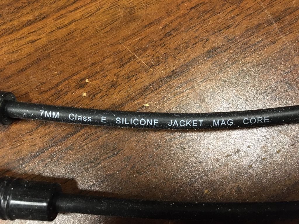

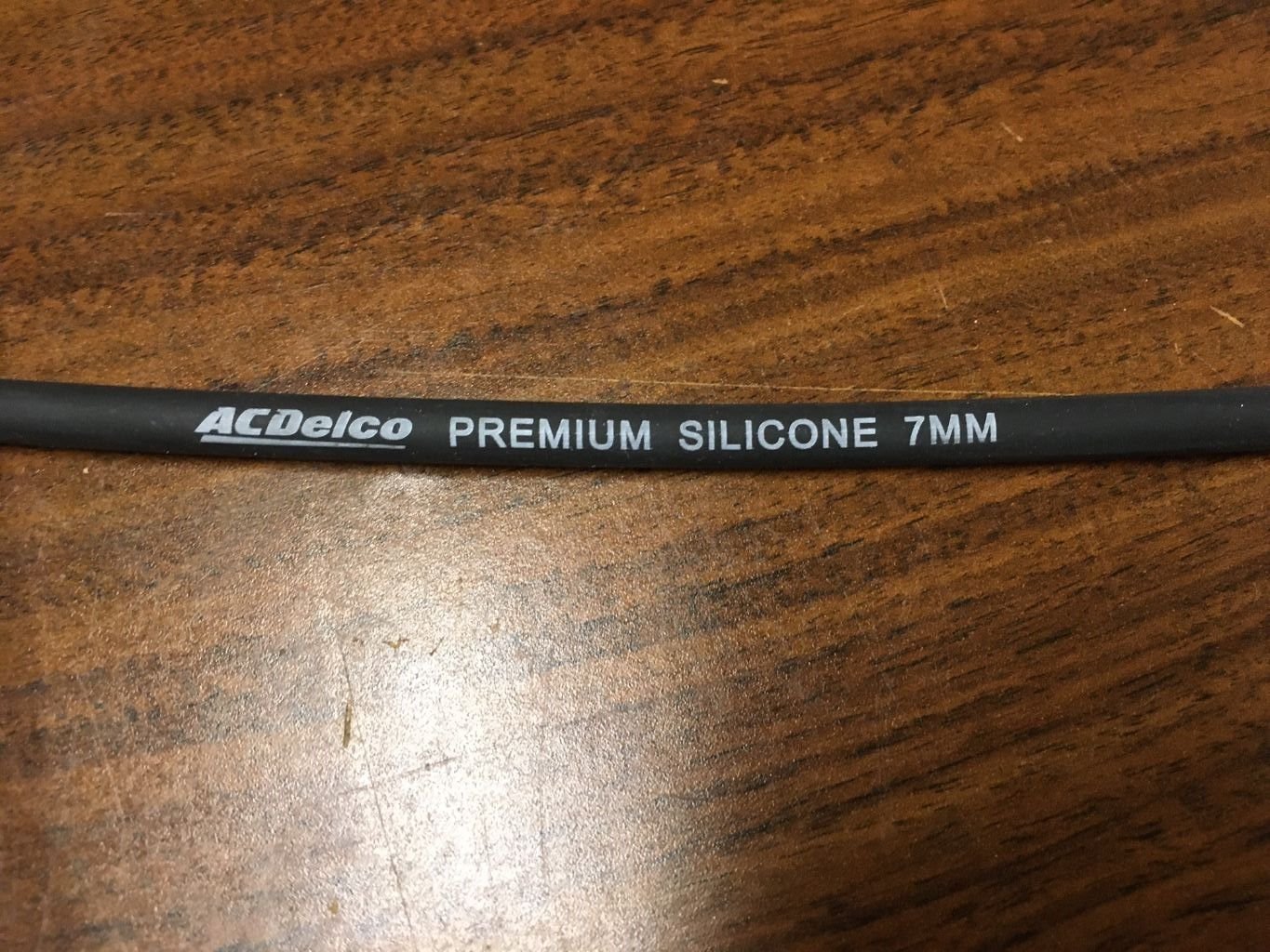

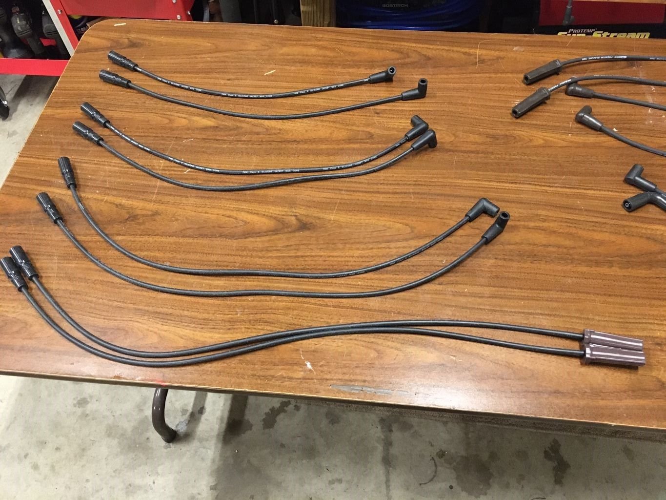

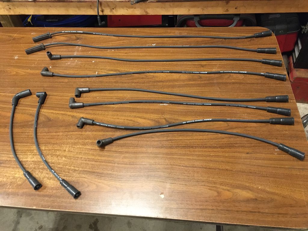

I looked the two sets over. Carquest Premium vs. ACDelco. I took a few pictures below that don't say too much themselves but there they are.
Some observations;
1. Both sets came with 10 wires total which included 2 different coil wires in each. This is obviously to accommodate the post on the two different coils that can come on these cars.
2. Both wire sets have various length wires as you would expect and the lengths between the two sets are almost identical.
3. The outer insulation sheathing felt different between the two with ACDelco feeling spongy and slightly more flexible compared to a more rigid and less spongy feel to the Carquest Premium.
4. While both sets are listed as 7mm, the Carquest Premium are ever so slightly narrower. Micrometer measurement was 6.8mm ACDelco and 6.7mm Carquest Premium.
5. Looking down into the boots for the spark plug ends, the Carquest Premium set appeared to have slightly smaller connector rings. I used a spare spark plug to snap into each set. The result was, Carquest Premium took a bit more effort to snap in and definitely more effort to pull off. They snapped in with a prominent "click" compared to the ACDelco which had a looser feeling at connection.

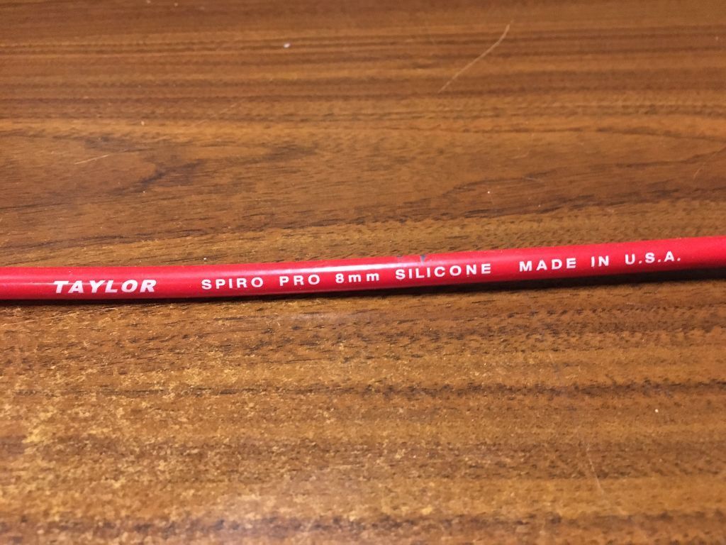

6. I did resistance testing on each set. BTW, I also have a new set of Taylor Spiral Wound 8mm that are for another non vette LT1 car we have. So in addition to comparing resistance between Carquest Premium and ACDelco, I also tested a Taylor wire to add to the comparison. I tested the longest and shortest wire on each set. On the Taylor, I only tested one equal length shorter wire just for comparison since they are commonly in use on our cars. Here are the resistance test results.
Longest Carquest Premium = 4900 ohms. Longest ACDelco = 9900 ohms.
Shortest Carquest Premium = 3000 ohms. Shortest ACDelco = 5900 ohms. Short Taylor 8mm = 800 ohms.
I'm not totally decided yet but leaning pretty strong on using the Carquest Premium and returning the ACDelcos.

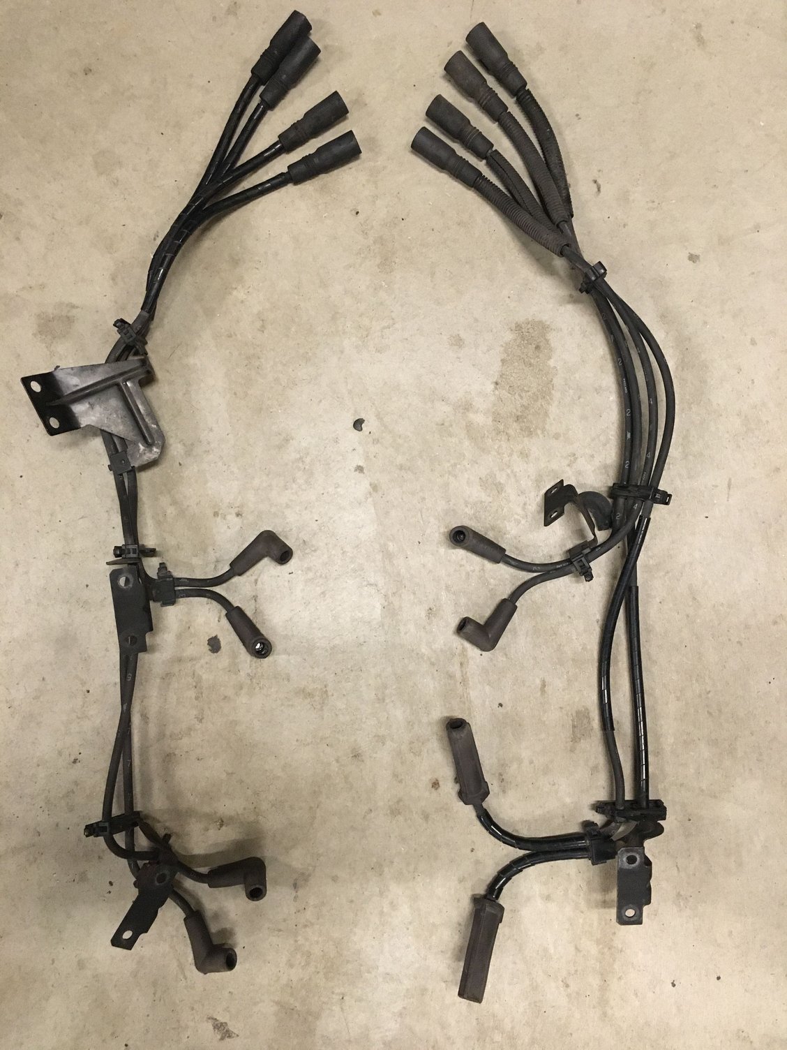

I saw it suggested to remove the wires as an assembly and still in the looms. I’m glad I saw this method and it turned out not too difficult to remove each side. I’ll swap the new wires into the looms and transfer the protectors over while on the work bench.
The passenger side was without the need to move anything out of the was and the entire process on that side was done from above.
On the drivers side I unbolted the ASR motor and leaned it back out of the way. I also removed the splash guard by the shock mount. I reached up from underneath and popped the wires off the opti then pulled them past the accessory bracket one at a time from above.
