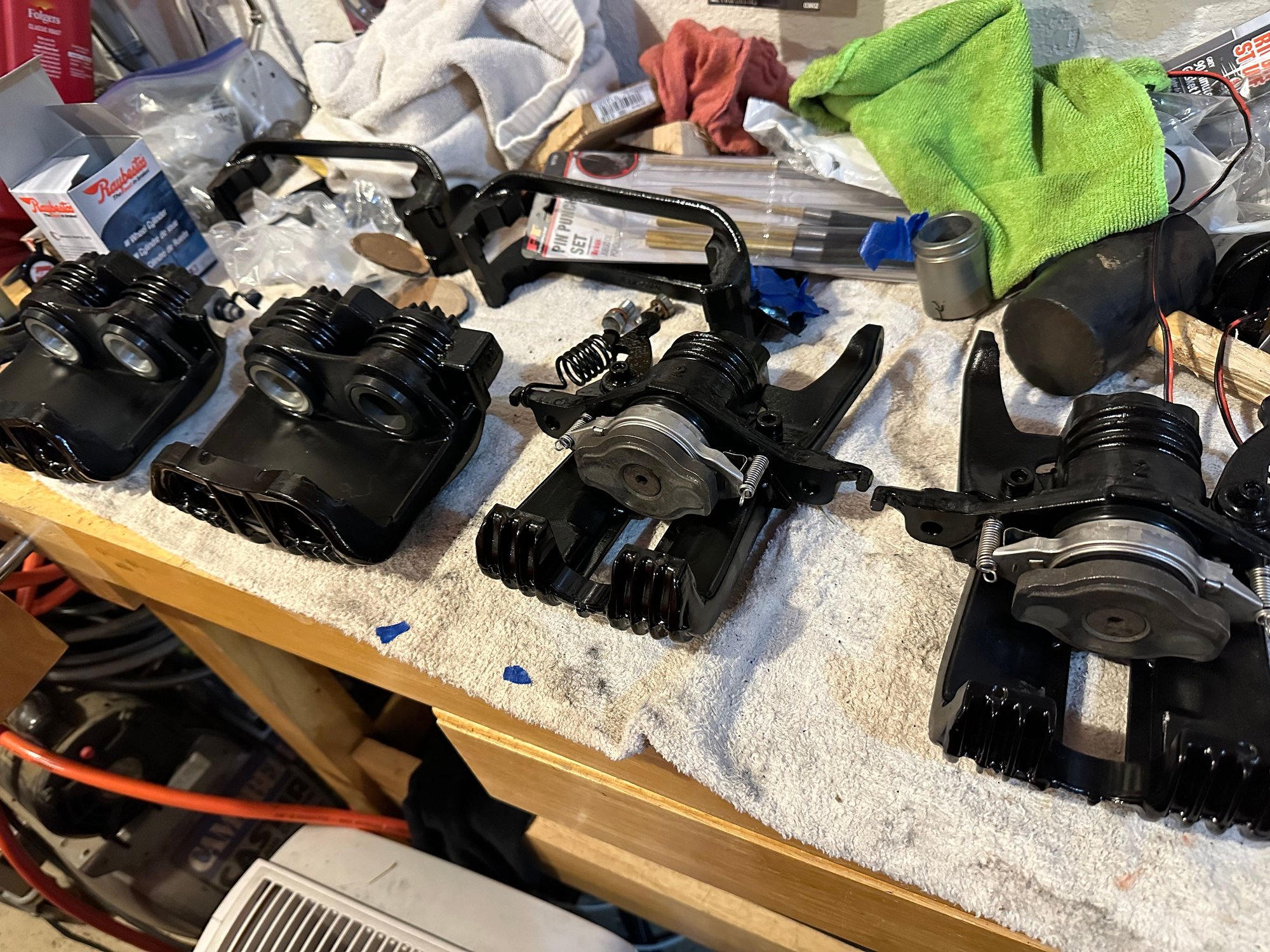

Now time to finalize calipers/install…

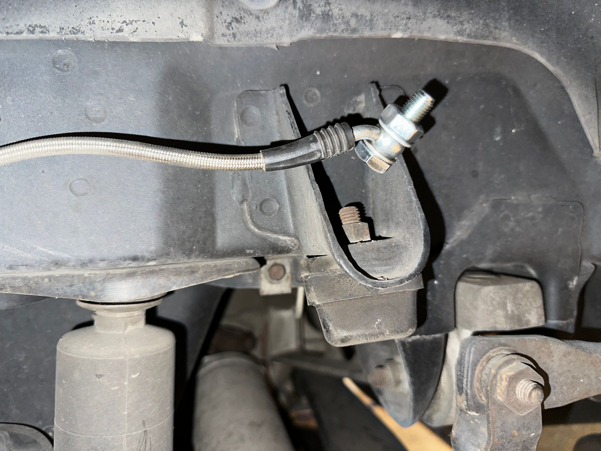

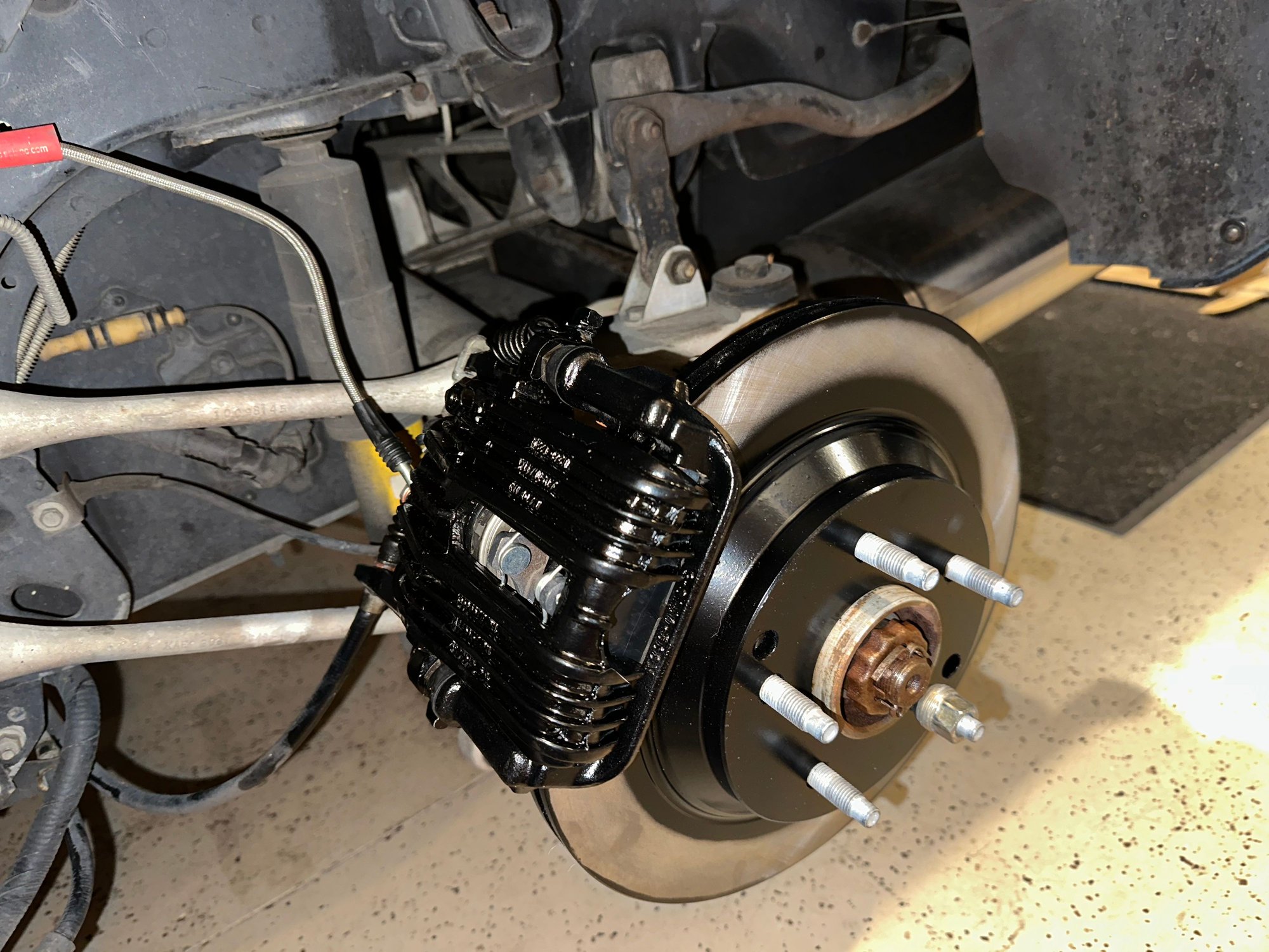

Now removed the rear calipers…used bolts with old crush washers to seal the hoses in the meantime

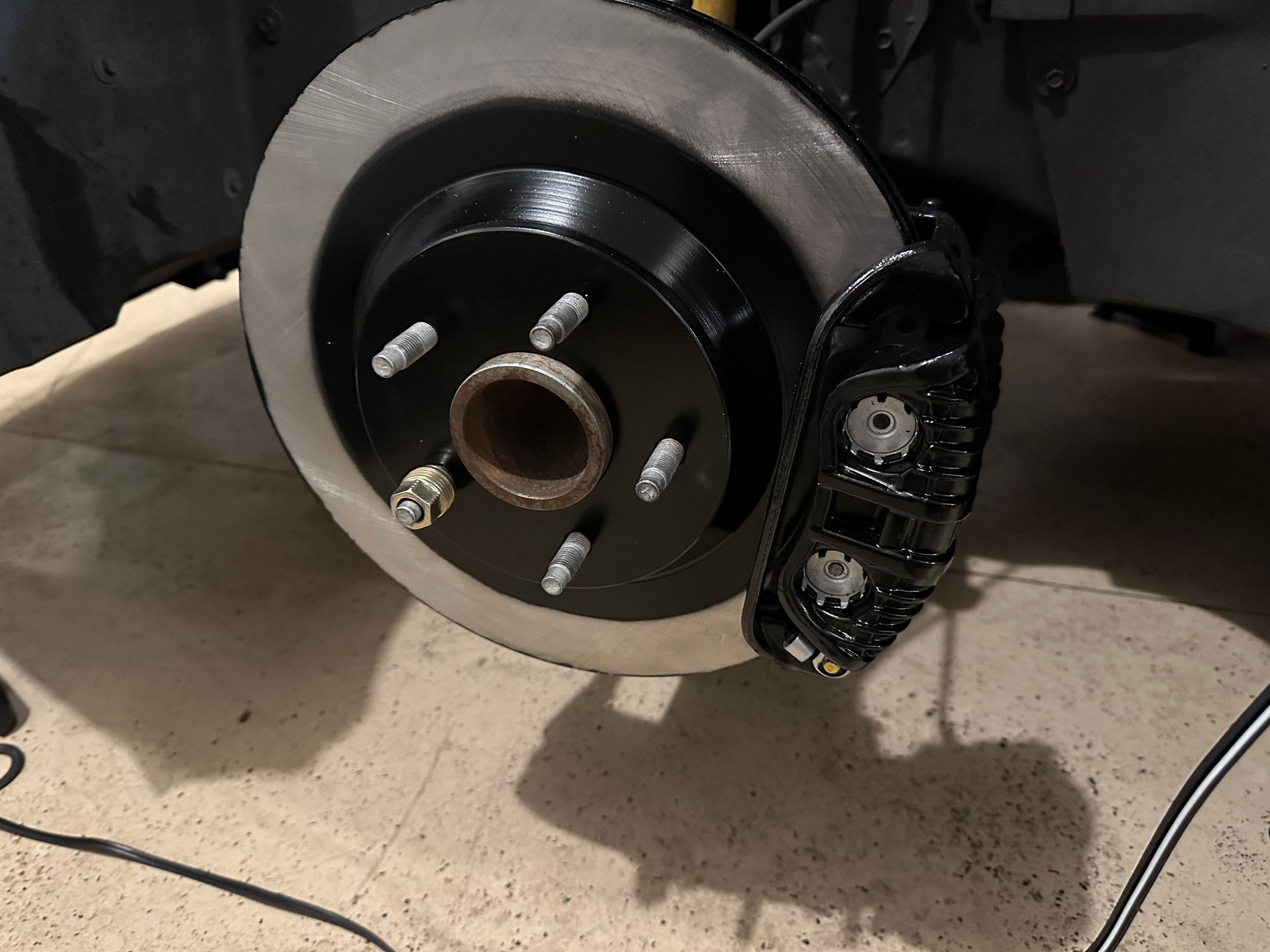

Rears fully rebuilt and painted

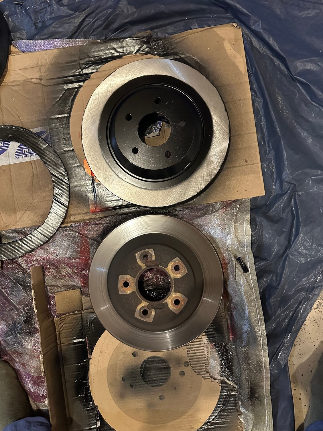

Front jl9 rotor vs j55

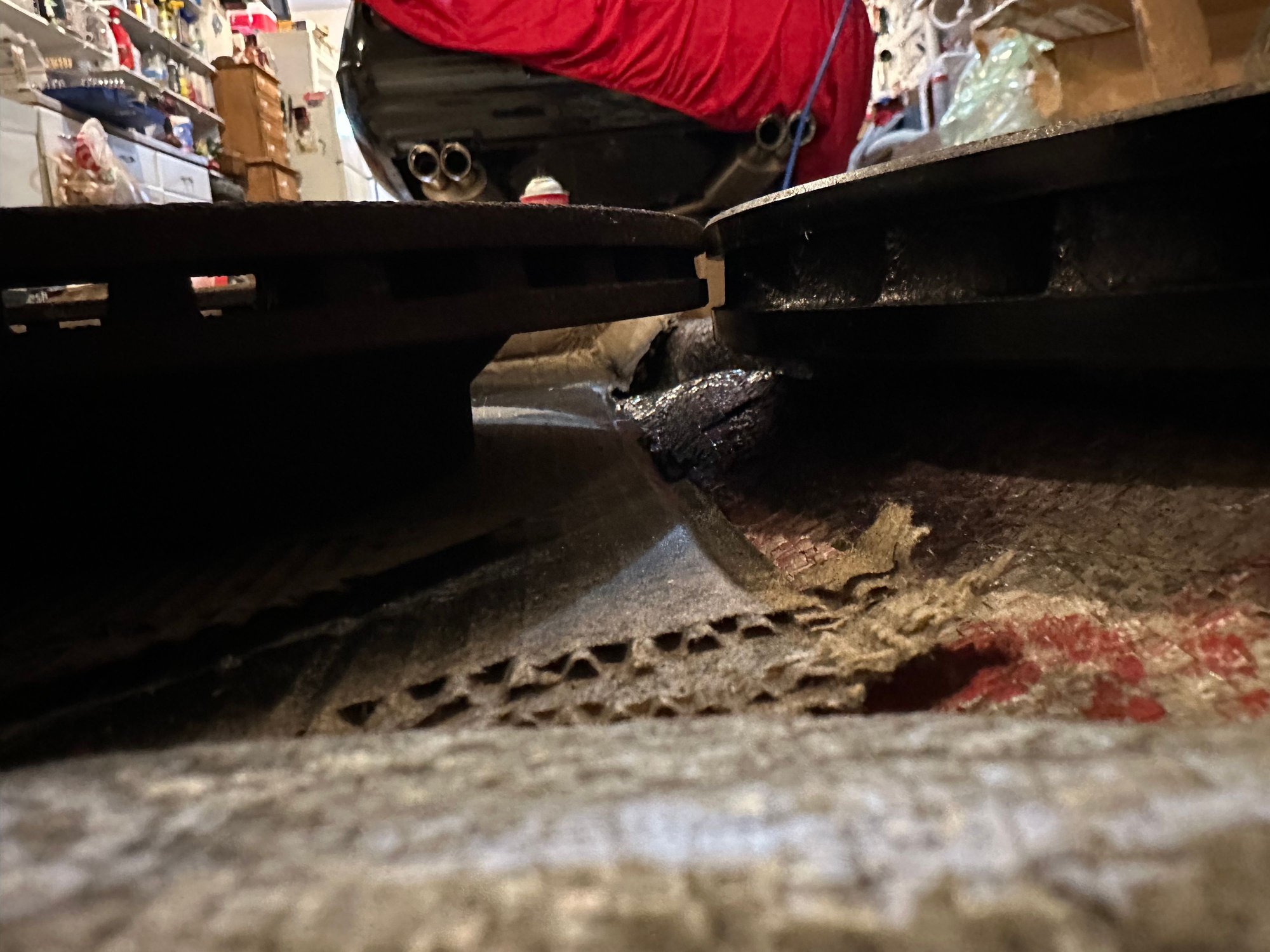

Jl9 vs j55..much thicker/more meat
Rear caliper mounted, I painted the rotors with a little overspray to end up with a clean line after a stop or two
J55s

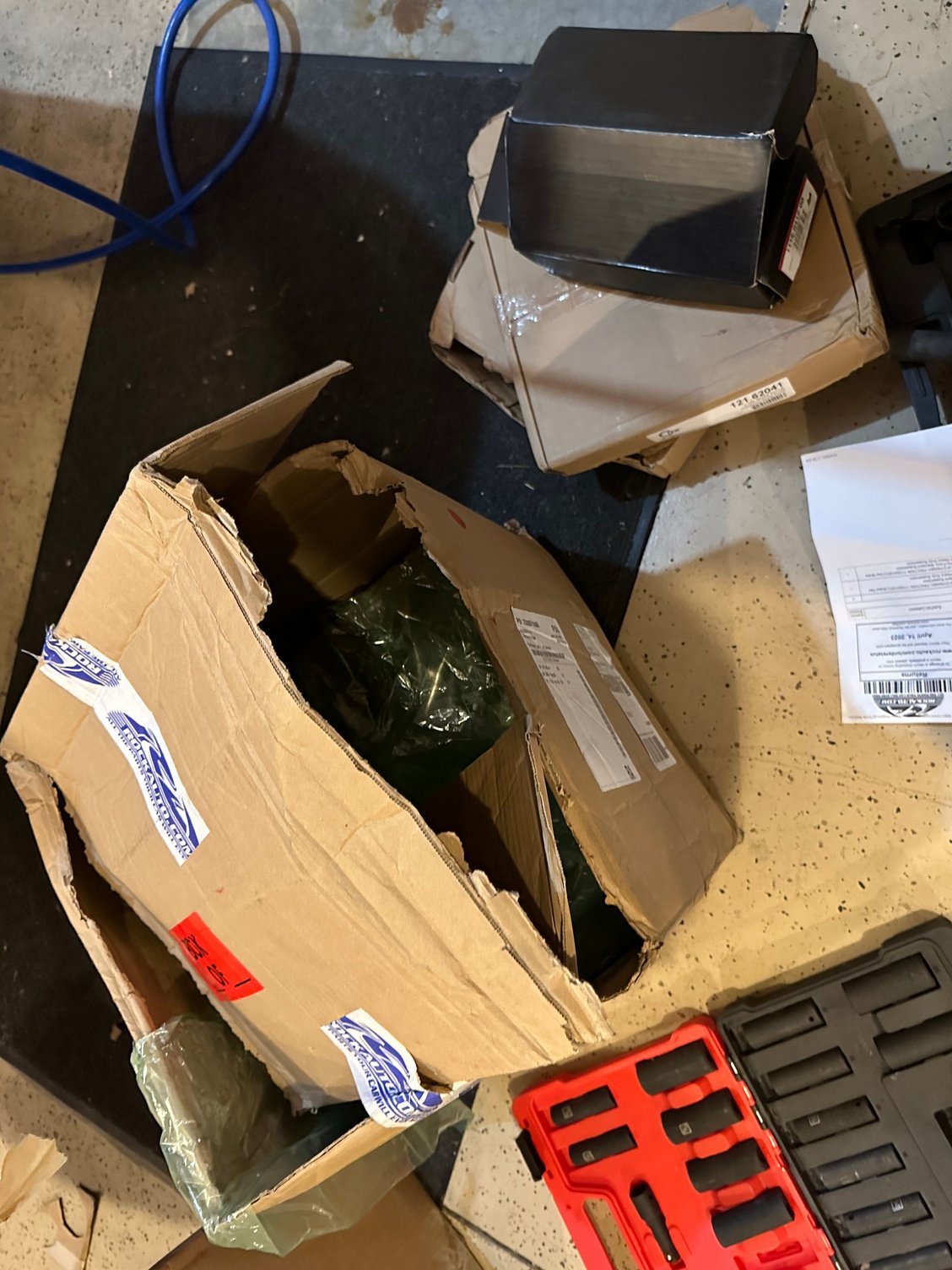

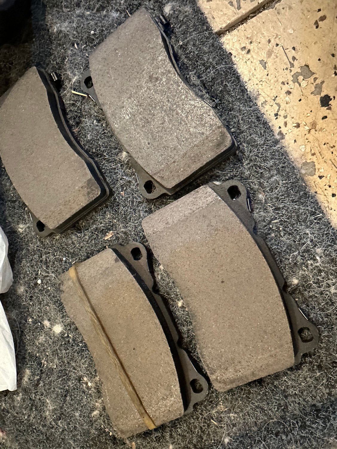

Brand new centric rotors and dynamic friction advanced performance pads from rock auto. Let me say I was less than impressed with the boxes/shipping. I honestly am shocked they weren’t damaged or things missing.
Box was way to thing, poorly packed, and toast.
Free extra random pads!

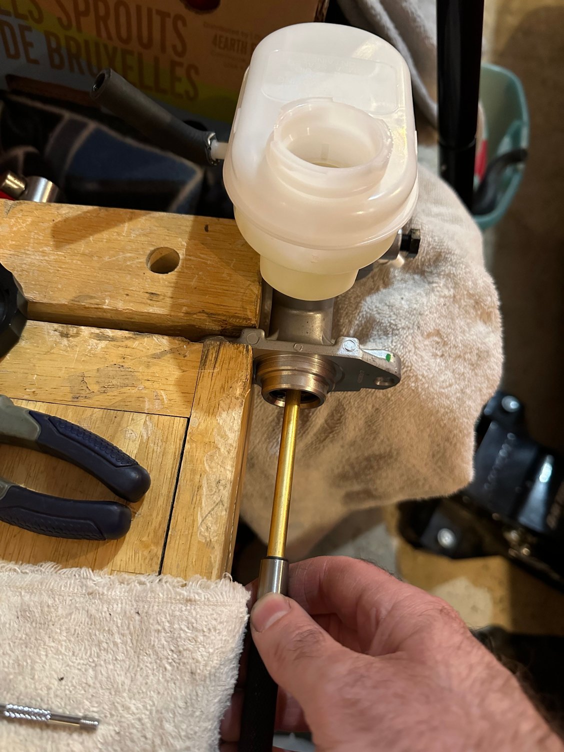

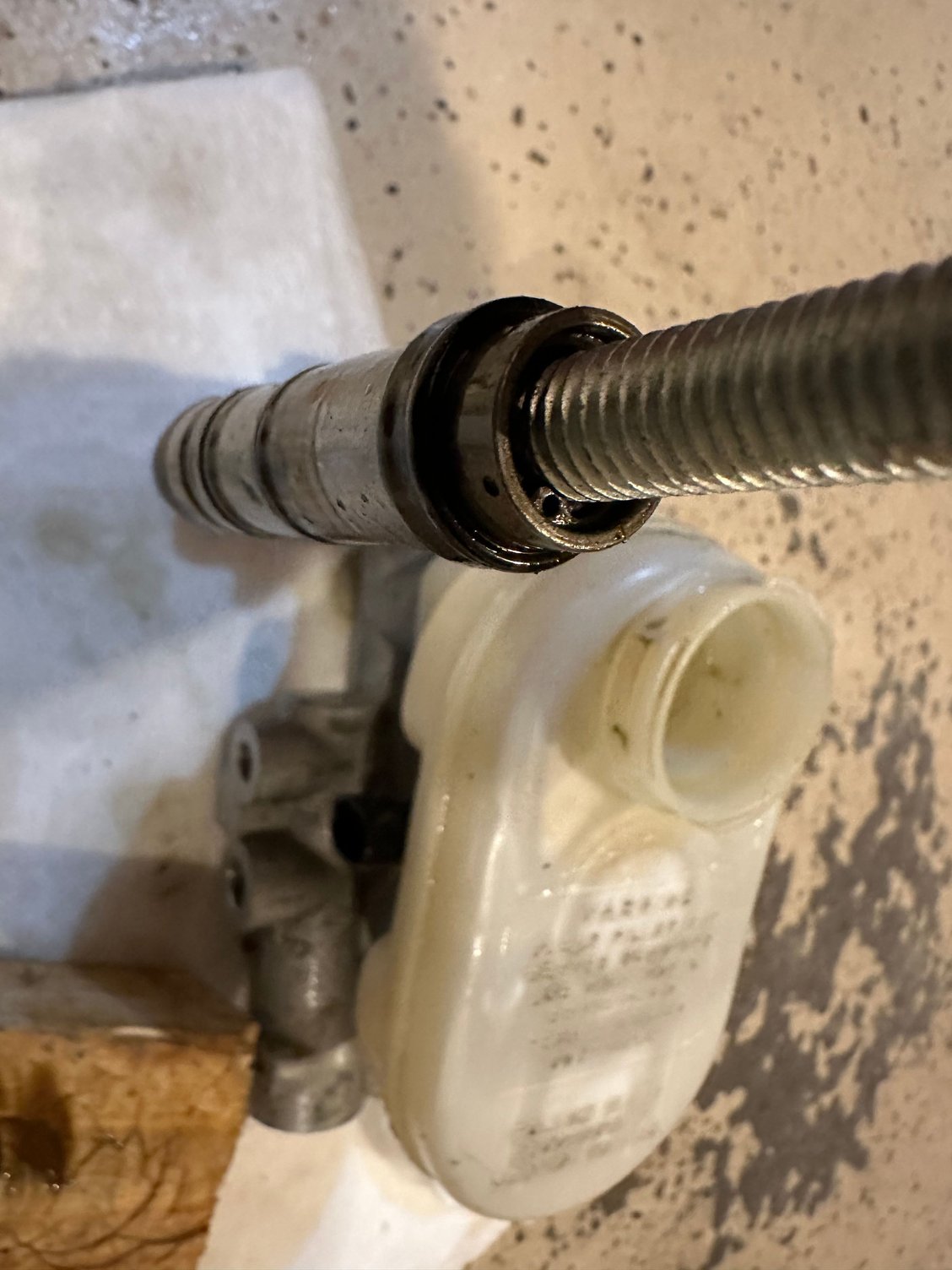

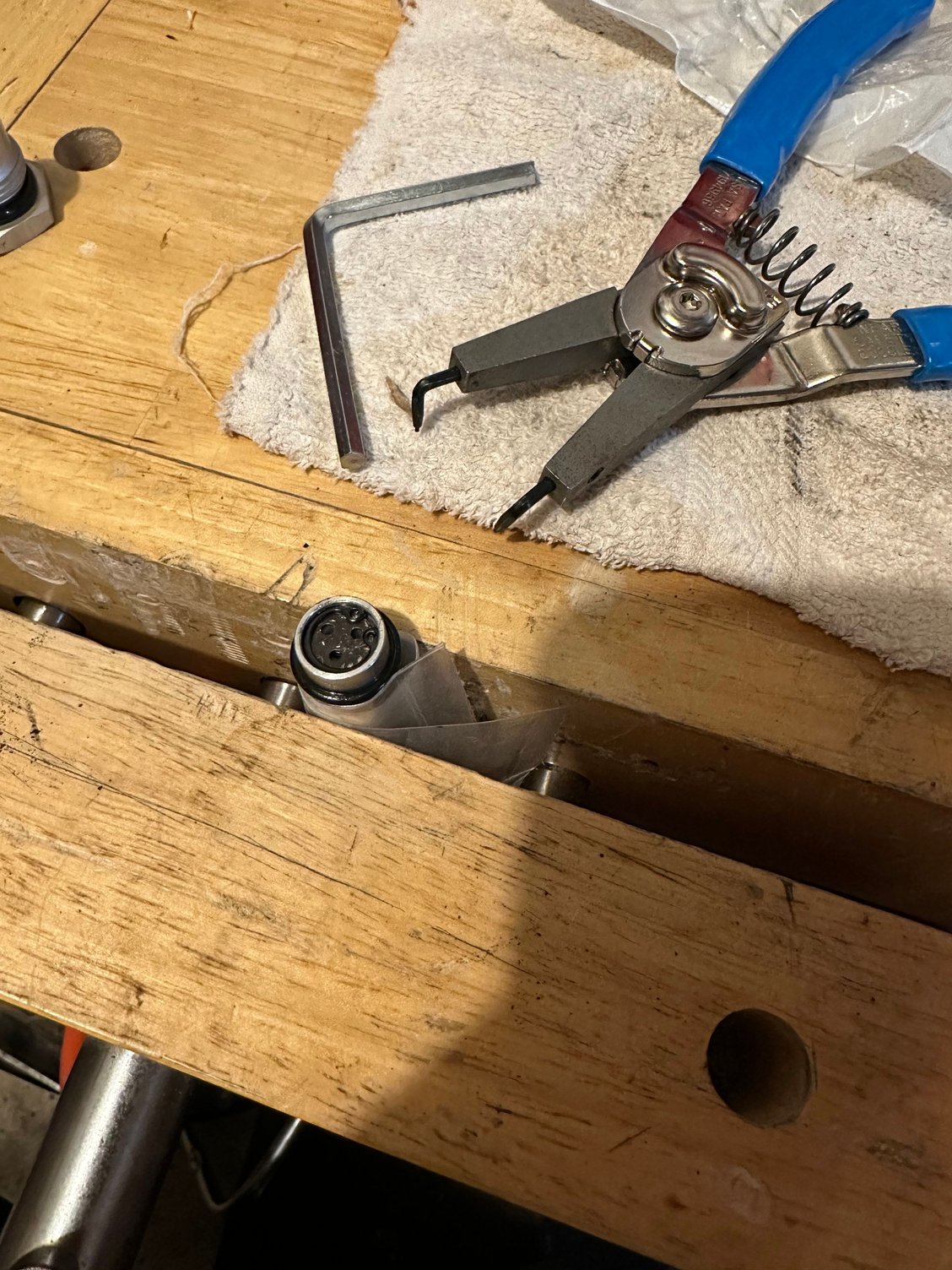

Now I ran into a problem…for the life of me I could not get the proportioning piston out of the bore with the master in the car. 93 master is different than other videos I’ve seen…there is nothing to “hook” to as the spring faces outward (in other words backwards from earlier masters). Mine was super stuck…so begrudgingly I removed the master from the car.

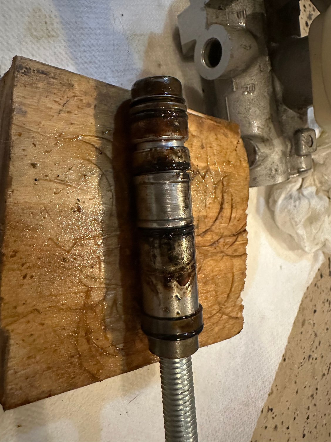

Smacking the master on a piece of wood did nothing…(FSM instructions). So I had to get creative. I found a bolt that threaded into the c-clip perfectly. Mounted the bolt in my wooden vice on my work bench and whacked the master with a mallet and finally:
Ewwwwwwwww
You can see the bolt just threaded into the clip.

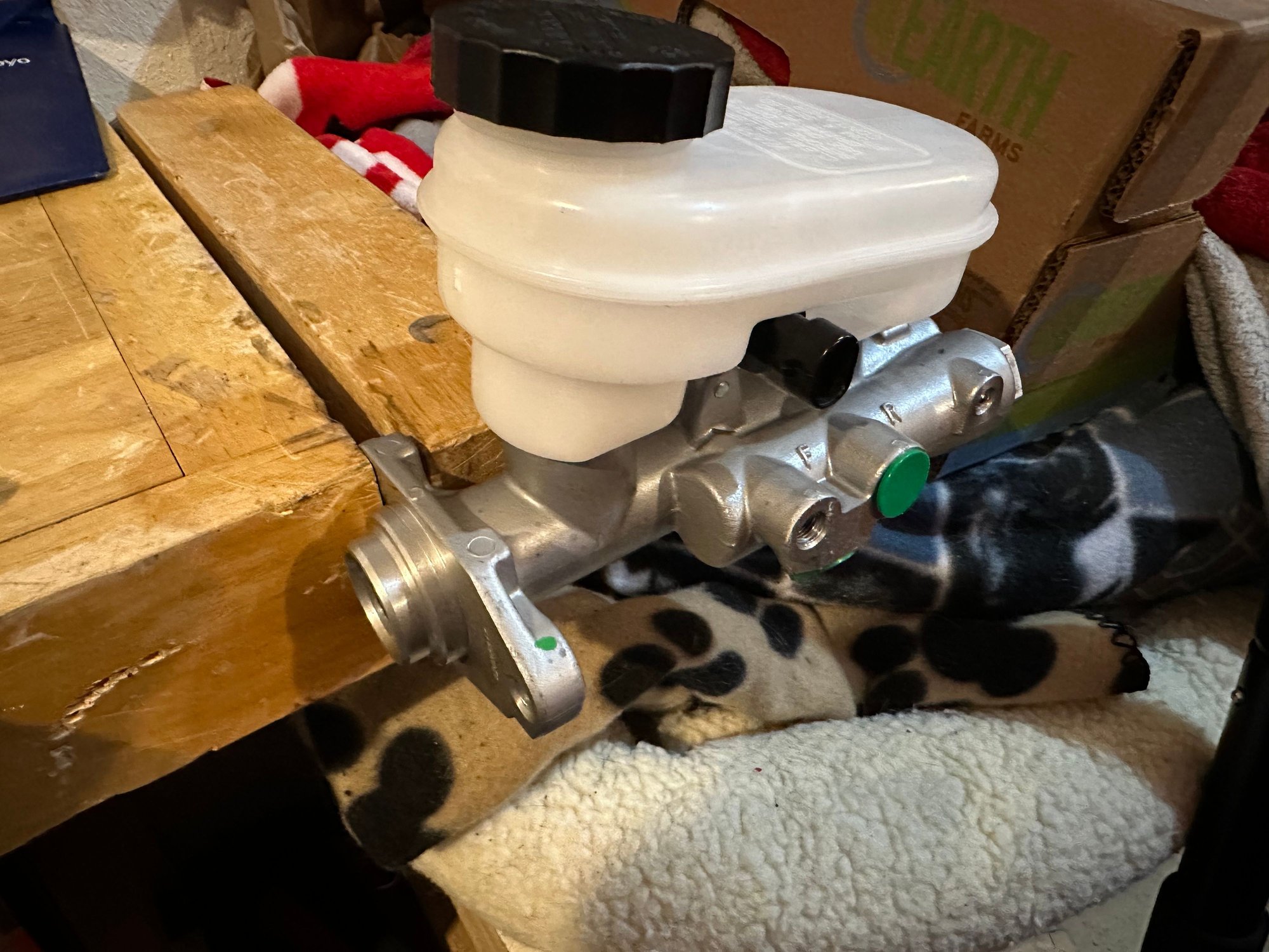

I finally came to the conclusion that even cleaned up I couldn’t trust the master and to me it wasn’t worth reinstalling without a complete rebuild. So I ordered a new one.

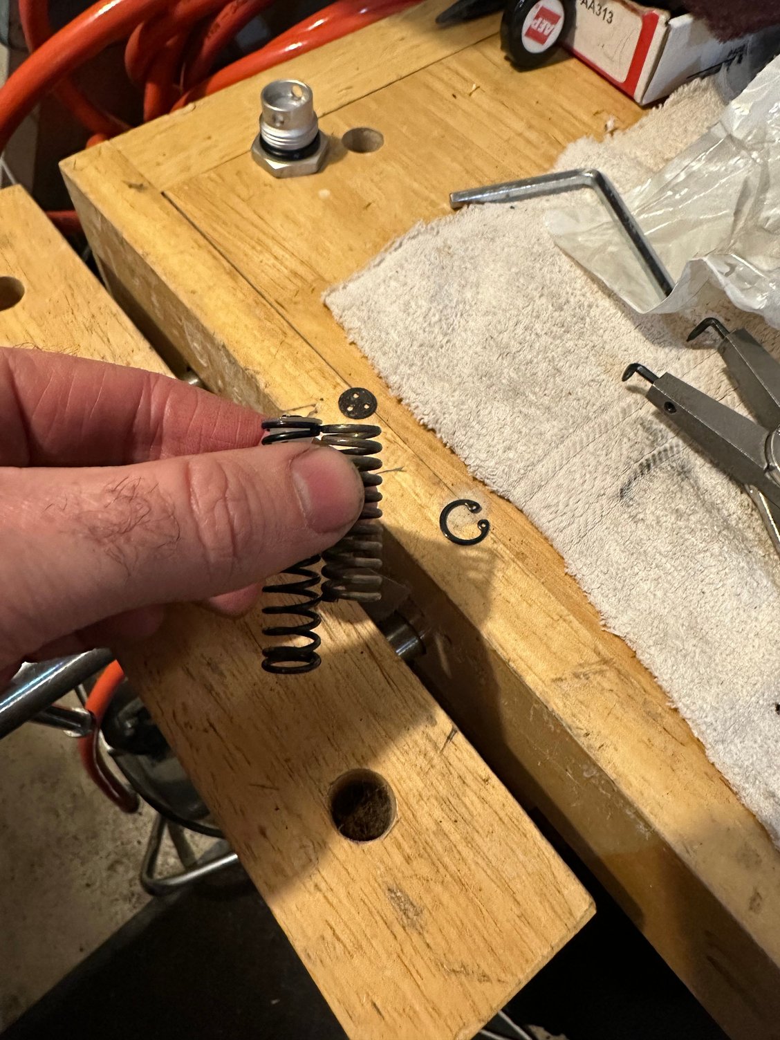

This bias spring install went easy:

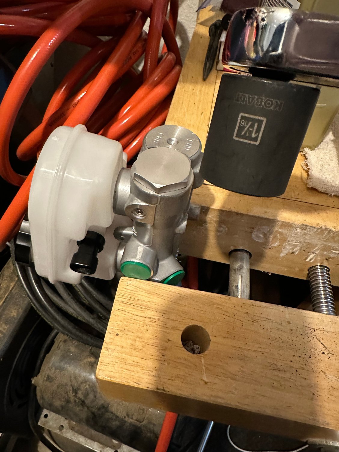

This is the size that fits the nut to remove the proportioning valve/cylinder. I happened to have it because it is also the the exact same size as the nut on my double tapered ARE shaft on the nautique.
Valve body
Difference between standard spring (left) and updated bias spring (right).
I used the Allen to push the spring down and was able to get the clip in there after a few tries…

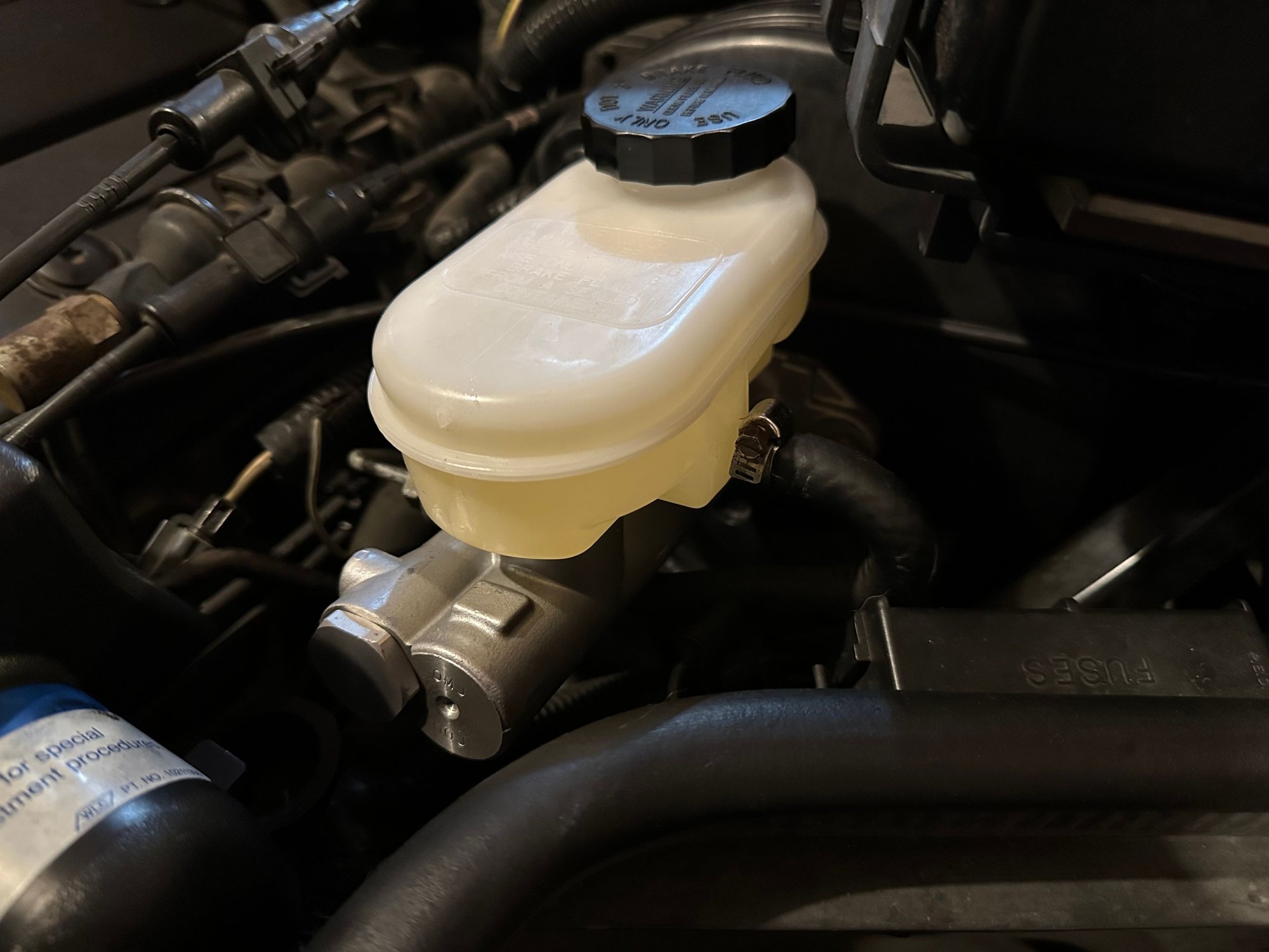

So now here I am feeling pretty good..I then remounted the master, and bled at all four wheels using my vacuum bleeder that hooks to my compressor. Pedal feels decent but won’t know for sure yet. I put Castrol SRF in it.
New master installed and bled

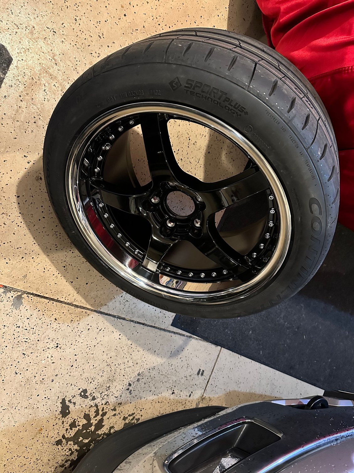

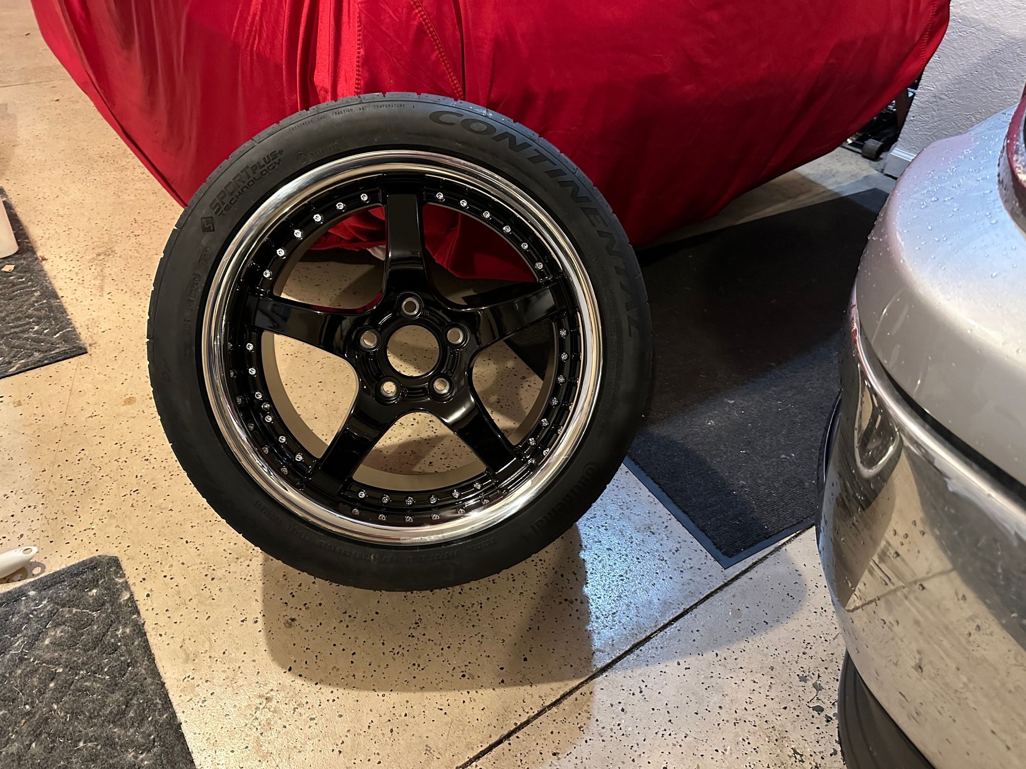

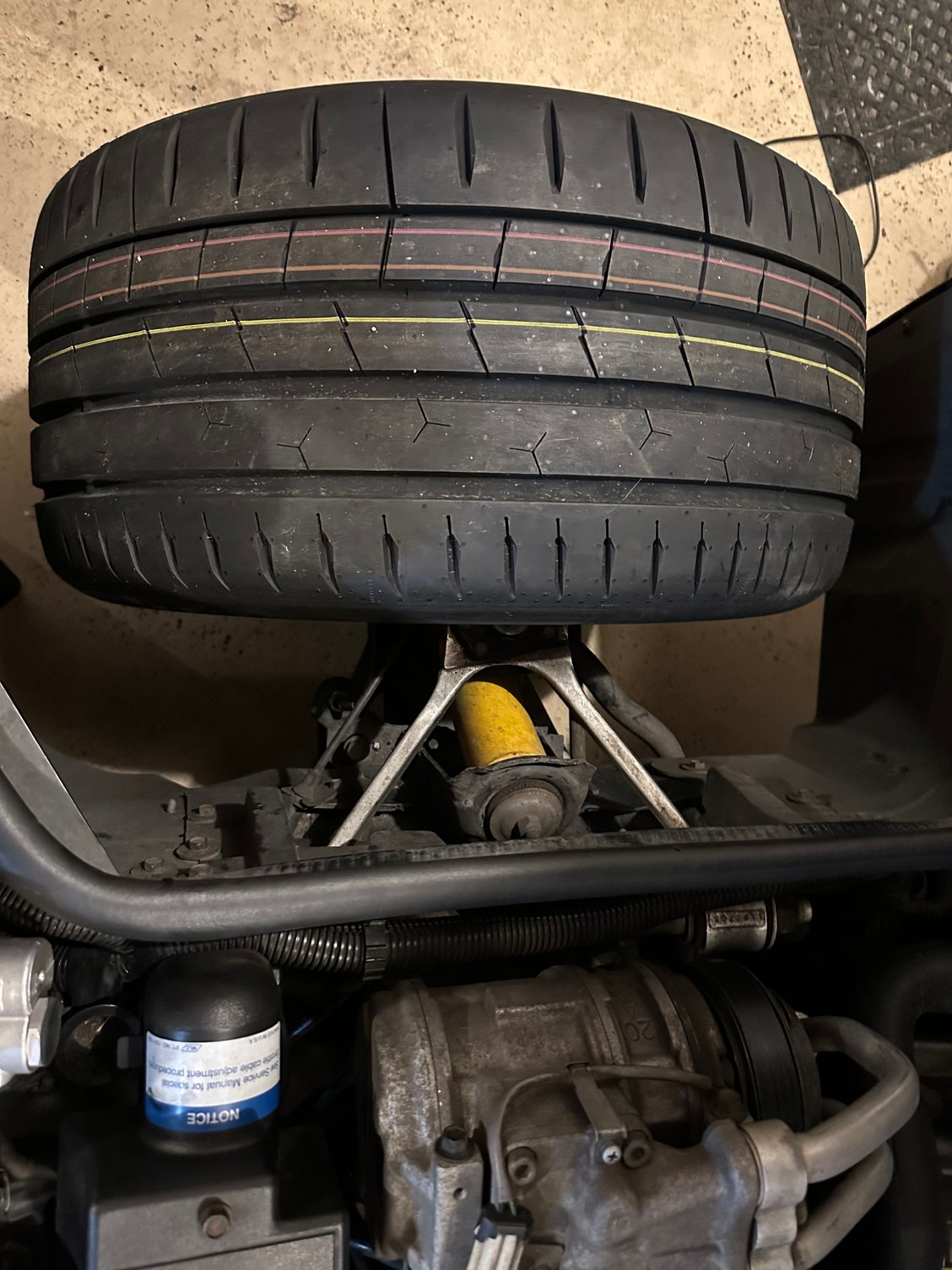

On to the wheels and tires…forgot about them! I went with Continental ExtremeContact Sports all around. 295/35R18s on cheap (<$400 for the set) 10.5 x 18inch wheels. I ceramic coated the wheels after the tires were mounted and balanced…should hopefully assist with washing brake dust off more easily and protect the cheap wheels.
No center caps yet

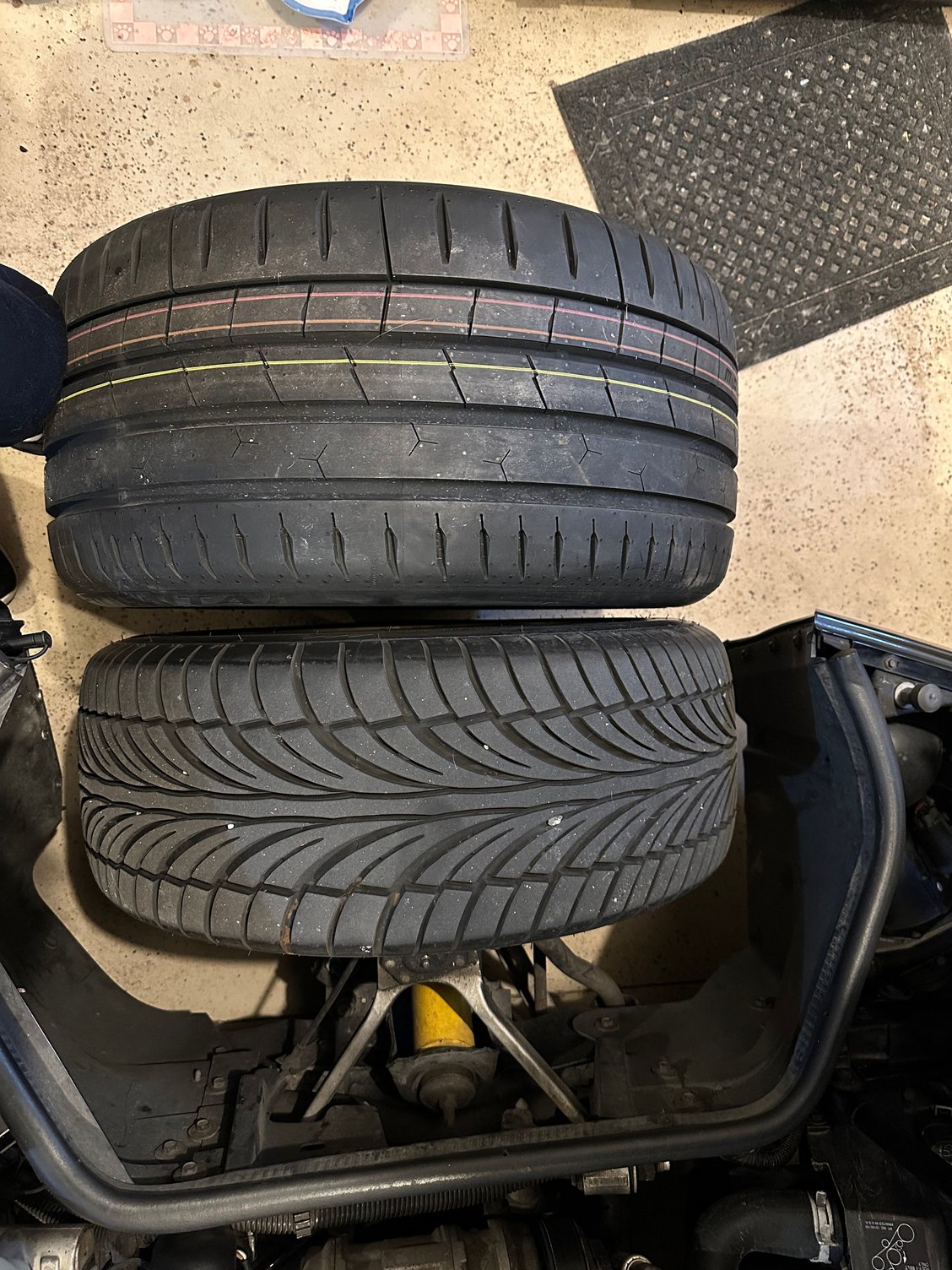

Comparing front size
So back to today…Time to put the new wheels on for the first time! Wholly crap I may actually drive it tonight!!!
That fills the wheel well nicely!
…need center cap stickers…

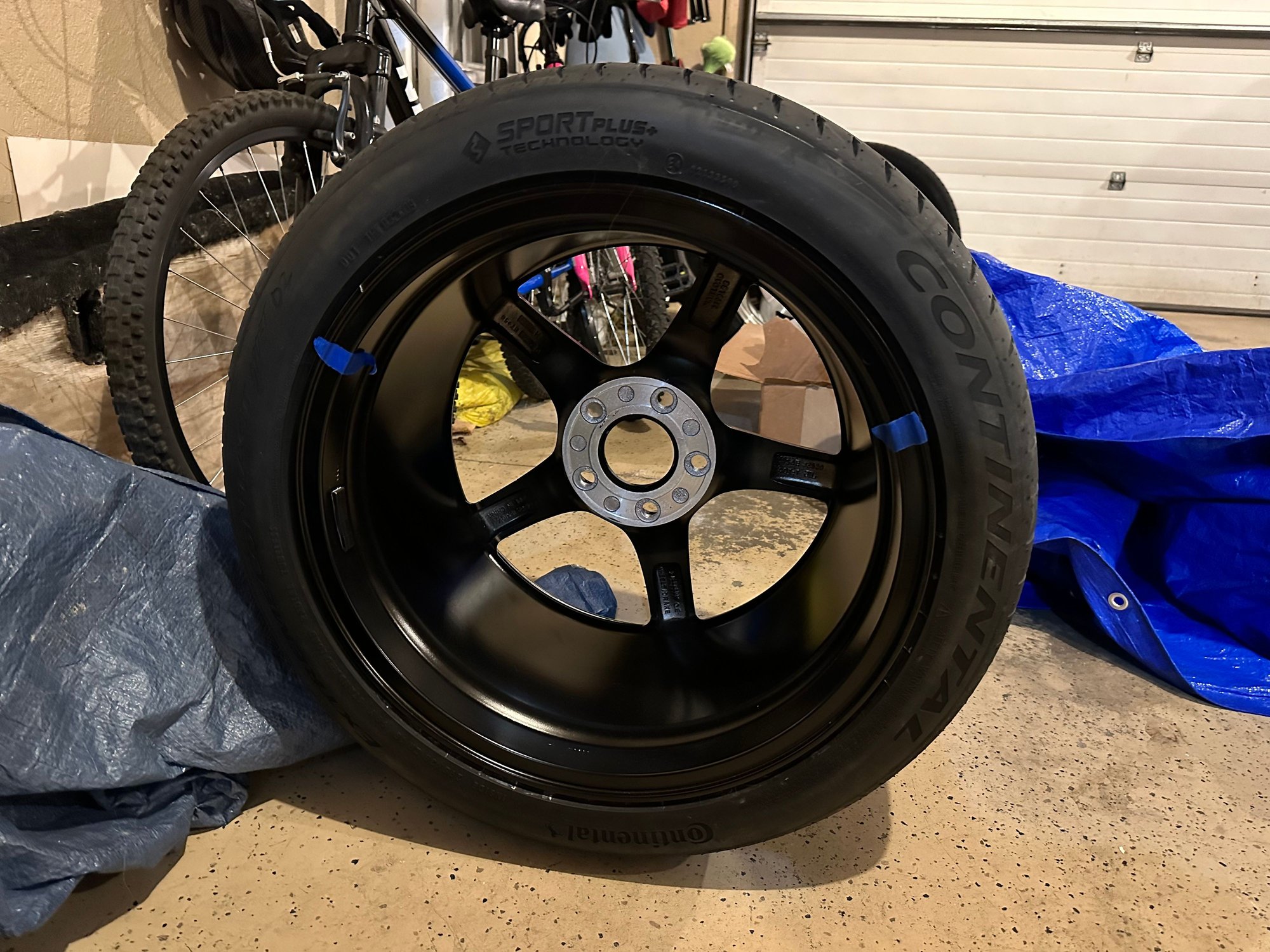

I go to mount the last wheel on the car and……….sad trombone…it’s completely flat. I mean 0 psi flat. WTH! So I try putting air in it and am greeted by a nice hissing sound from the bead on the inside. In two spots!
Tape marks where it is leaking
Not sure what happened there. I know for a fact it wasn’t leaking like that when I got it. It’s been a few weeks so all I can think of is it had a leak somewhere (either bead or valve stem) and it went all the way to 0 and lost the inside bead. I tried overinflating it/smacking the tire with a mallet and no change. I guess I’m taking it back to where I had it mounted to have them fix it. Hopefully I can do that tomorrow and actually get this thing out for a test drive.
