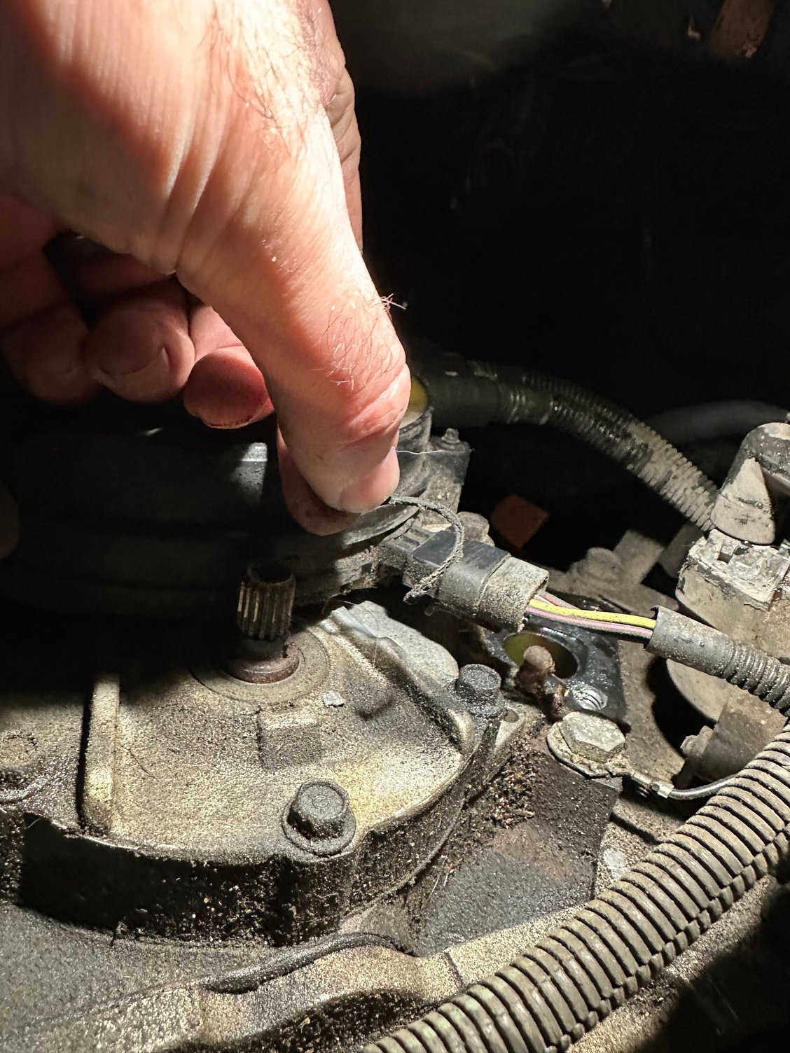

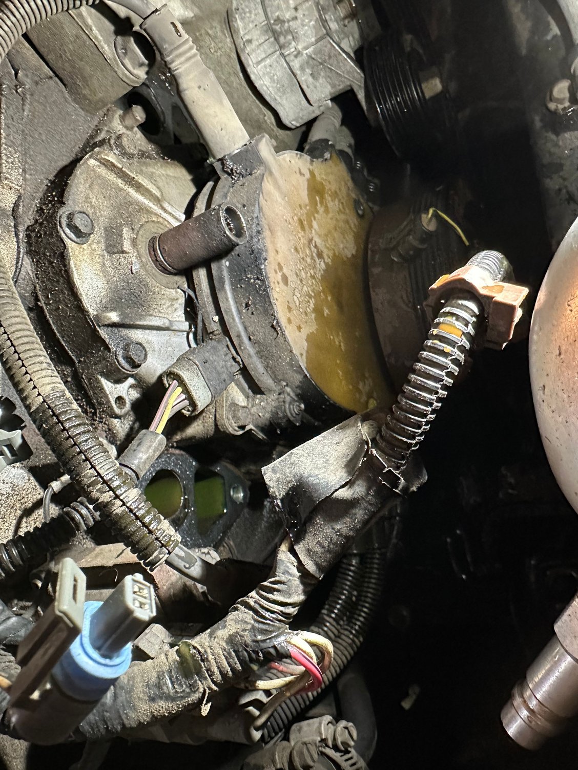

About to begin (what lurks beneath?)
Throttle body leak?
Uh oh…glad I bought a new CTS and never tried to remove that connector!
Ummmmm…I guess that’s one way to stop the water pump from dripping in the opti
This water pump was not long for this world…seal completely gone and grease flung out
Found some of the seal…
Opti looks like it avoided any coolant or oil, miracle! Can’t wait to pull it and inspect!!!
Dirty but no intrusion
Yeah I should have done this sooner!
next up is getting the crank pulley off…bolts are out but needed to clean and dry the floor before I get under the car to try and knock it off.

Please take pics of the inside of the cap and rotor.

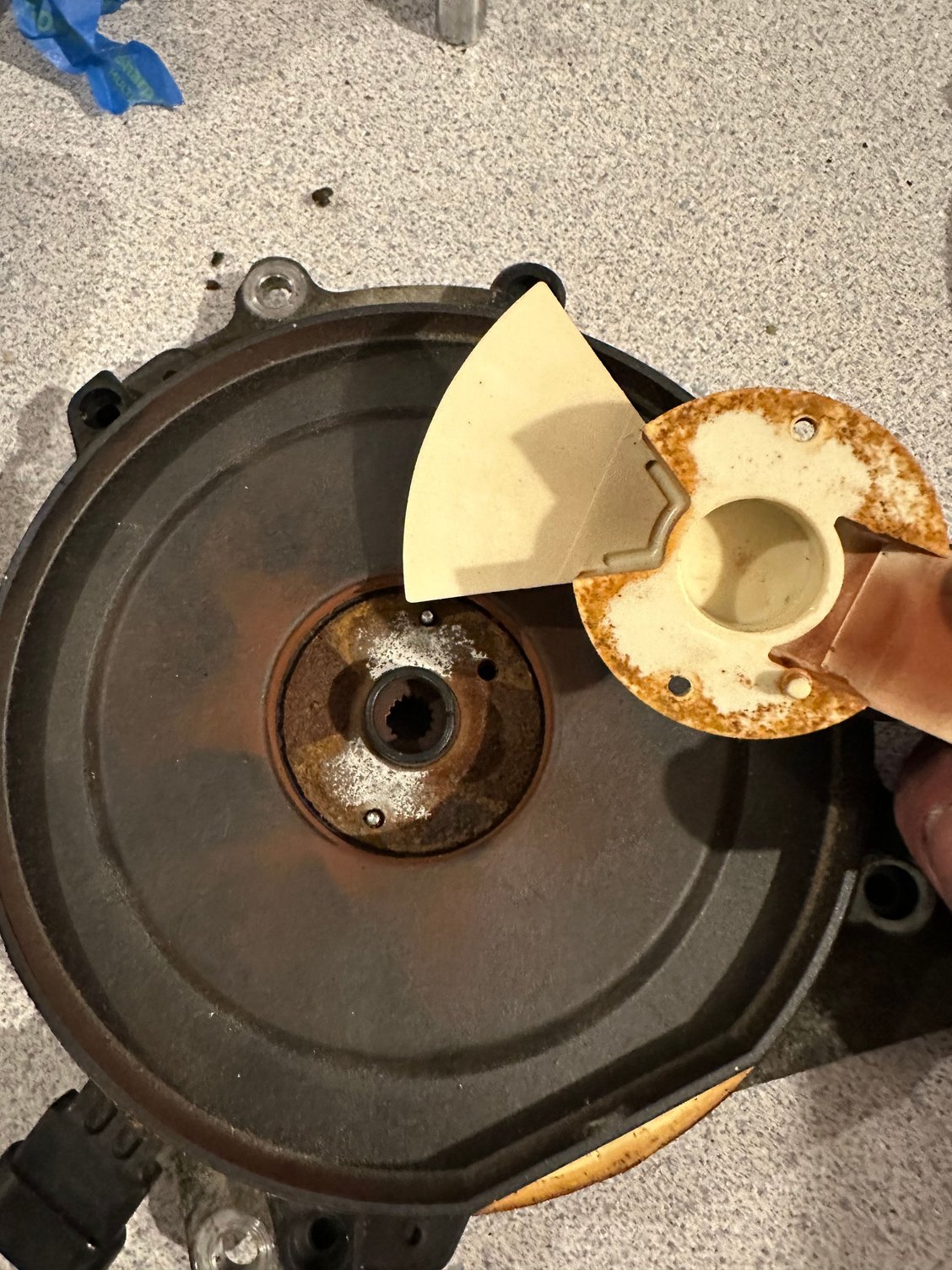

Ok here we go…

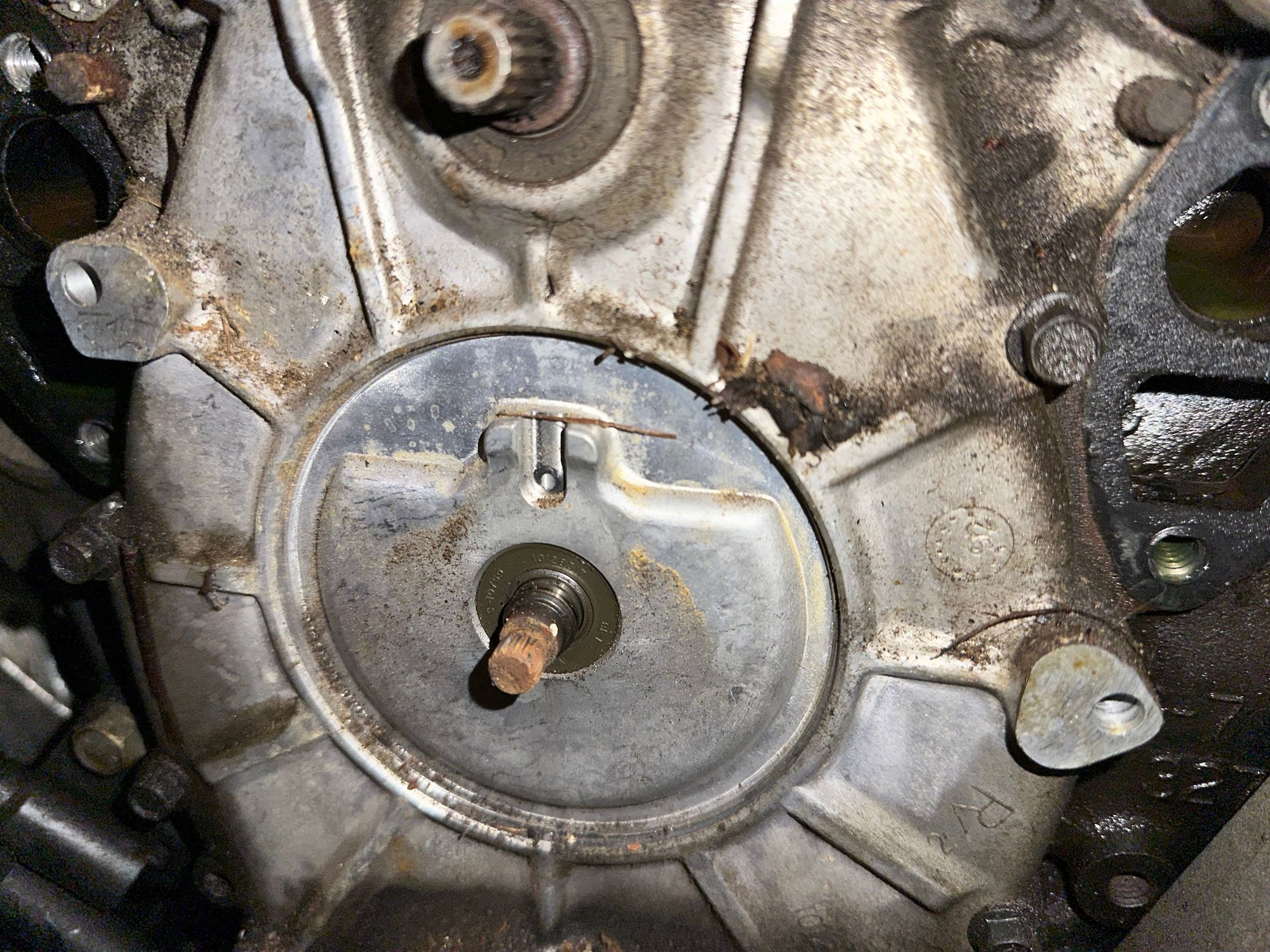

Opti coming free… crank pulley came off surprisingly easily…long dowel rod from underneath with a 4 lbs hammer and off it came
Timing cover looks good IMO..just dirty and wet from coolant
Encouraging! Back side doesn’t look too bad. The part that needs to be clean is clean.
Hmmm…maybe it’s ok?

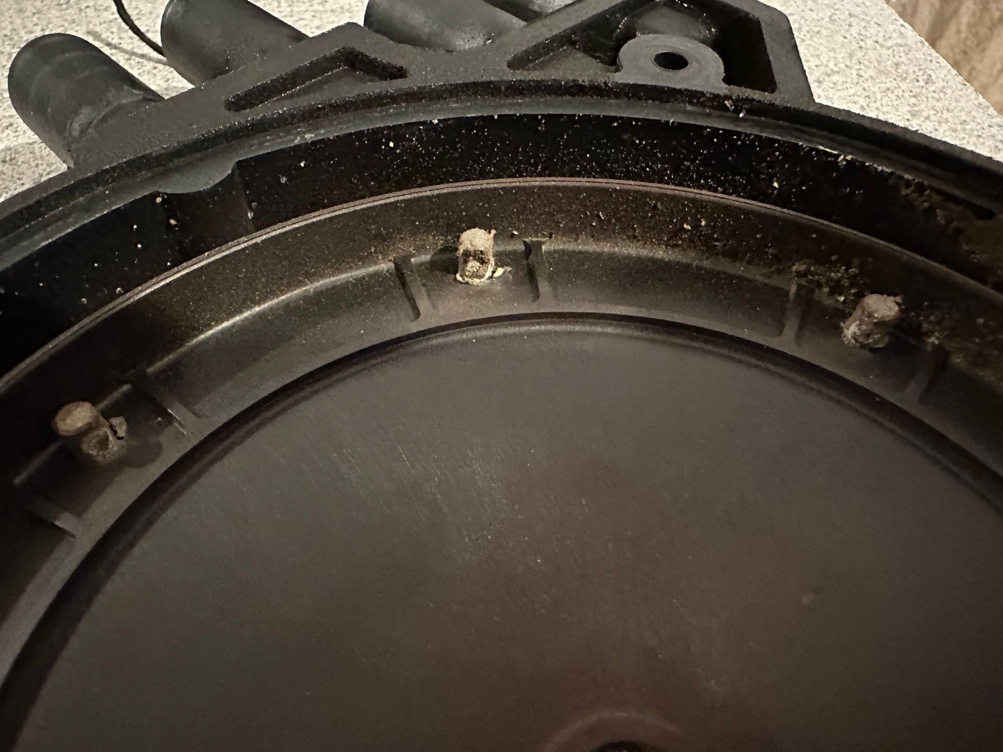

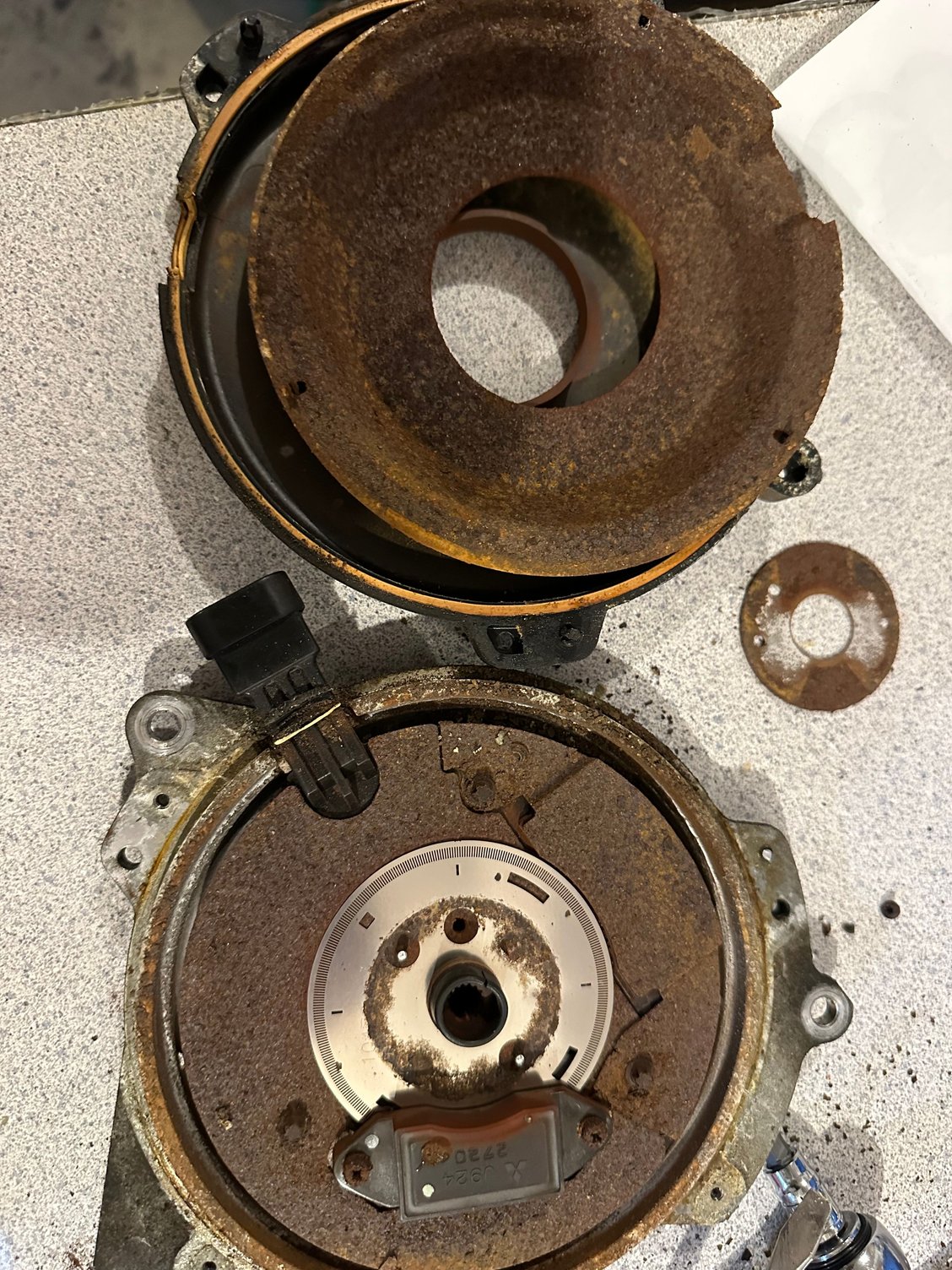

Cap…one of the thin bolts that holds the cap on snapped…fixable
Rotor worn
Cap electrodes worn
Uh oh…both screws were so corroded a little twist and they disintegrated (not just snapped…complete crumble)
Oh…oh no…
Dead.
But what’s this symbol! Score!! It’s original! Also the wheel where it matters is perfect.

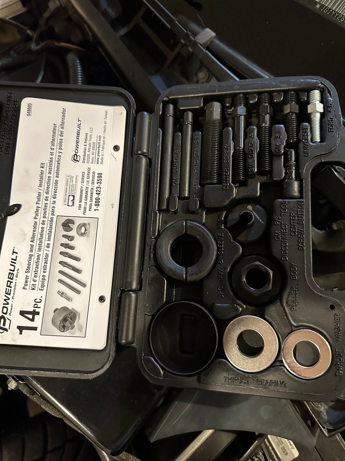

Might as well pull the PS pulley now
This tool is a rental from Advanced…worked effortlessly! Going to wait a until I have wires, plugs, intake etc to install the new pulley

So I guess this is evidence that active venting likely matters a lot…time to order a full petris and I’ll hang onto that old sensor for sure. Glad I didn’t try and order just the cap/rotor/vent kit…it’s obvious any other screw or bolt I touch to disassemble further will disintegrate.
Btw car had no running issues whatsoever. This isn’t totally surprising as the wheel and sensor were fine…it’s just everything else around it. No way I am putting that back on.

WOW... Lots to unpack here.
1- 93 with 47K, but you are not the PO.
2- No idea if POs ever decided to pressure wash the engine3- Do you have to remove the entire Opti to replace the rotor and cap?
4- Did you clean behind the Opti before the pics? I would have expected lots of oil back there.... Looks very clean.
5- What is the stuff inside the Opti...4th pic?. Looks like chewed up plastic?
6- the bolts disintegrating...wth? Can the remains be removed? Where do you get new hardware?
7- The rotor looks pitted to hell!?!?
8- Are you sure the corrosion is ozone and not water damage?
9- You stated your car ran good. I'm really curious to hear how it runs after the new Petris unit.
10- What's the deal with the pulley? I have any LT4... Do I have a sanity pulley? Can't remember.
Ignition wise, this is the last thing I need to do to my car... Cap and rotor. I'm having second thoughts. 😬
Ric

@IHBD I agree it’s the unvented ozone that does it, at least on mine. Sorry to hear about your struggles, I have the seal install tool for the WP seal so hopefully that will go well. I was going to lather with assembly lube but if the inner lip is Teflon that might not be right as I believe those are supposed to go on dry? I will check. Thanks for the warning on the pulley, I will try not to screw that up…

“2- No idea if POs ever decided to pressure wash the engine3- Do you have to remove the entire Opti to replace the rotor and cap?”
No idea…but it doesn’t look like it was washed ever. Appears untouched. No you don’t *have* to remove…although the rotor screws would be hard. It is almost zero difference in effort to completely remove the opti to freshen it…in fact it would probably be easier and shorter time. Less chance to break anything too. 3 bolts and it’s off and remember one of the tiny cap bolts snapped so you’d want to take care on a bench.
“4- Did you clean behind the Opti before the pics? I would have expected lots of oil back there.... Looks very clean.”
Nope. Taken immediate after removal.
“5- What is the stuff inside the Opti...4th pic?. Looks like chewed up plastic?”
I believe it is the material/corrosion coming off of the electrical pins in the distributer…there is nowhere for that to go so it accumulates there.
“6- the bolts disintegrating...wth? Can the remains be removed? Where do you get new hardware?”
The rotor screws are Phillips head. I am sure you could drill and retap or maybe I could unscrew with vice grips (assuming the shaft doesn’t snap). But you’d want to remove ALL of the screws/plates and either get some thing sheet metal to try and replace by hand forming maybe? Problem is that metal that is rusted is paper thin so I doubt they could be reconditioned. The opti wheel should be fine though.
“7- The rotor looks pitted to hell!?!?”
I’m not sure that’s abnormal for 47k miles.
“8- Are you sure the corrosion is ozone and not water damage?”
99%. As you can see there is no evidence of intrusion of water or oil whatsoever.

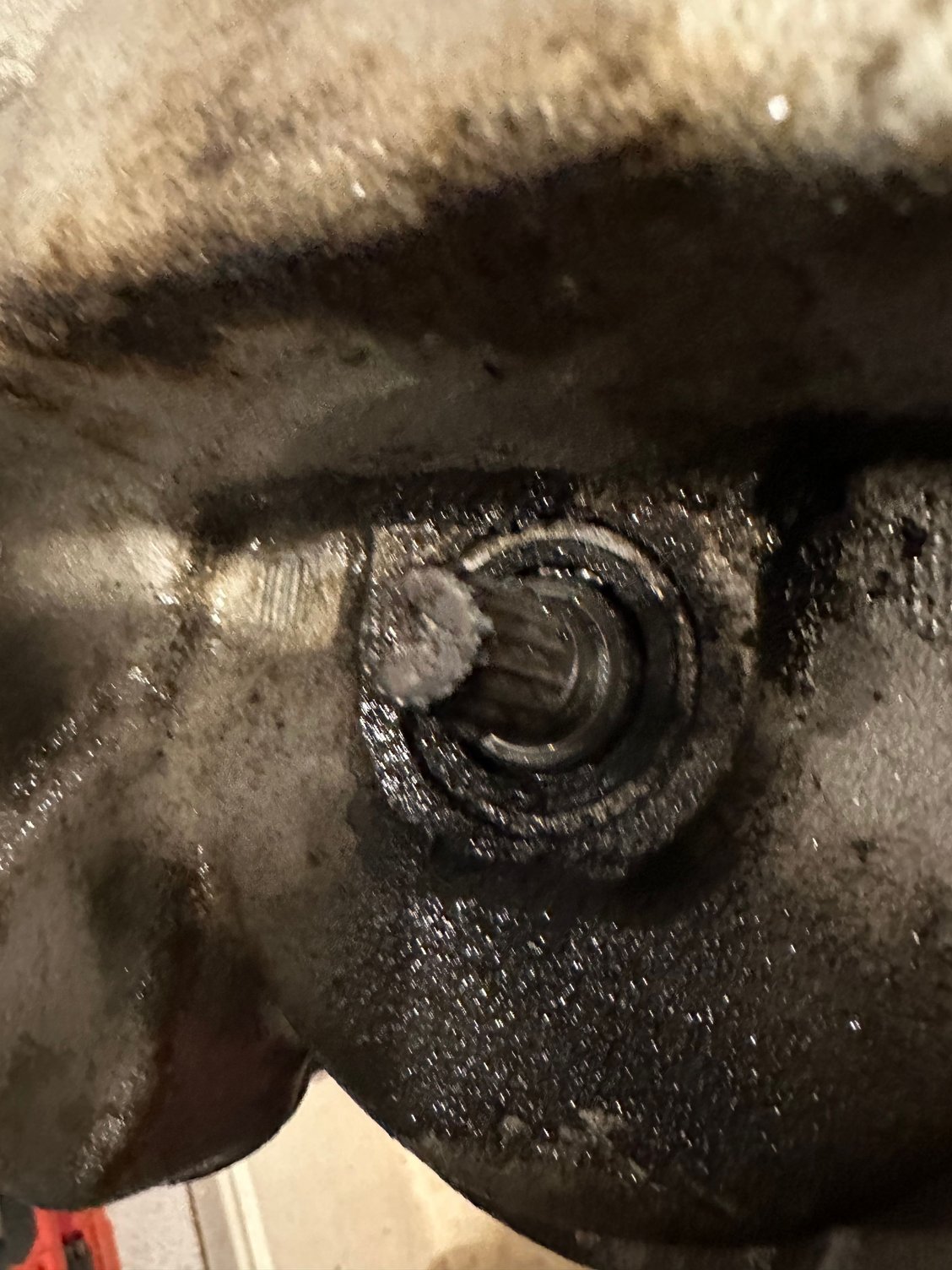

Tried to install the water pump drive shaft seal with the tool. That part was fine. Used copious assembly lube. But…lighting wasn’t great so with the shadows I didn’t realize I had the seal slightly cocked as I was driving it in… I leveled it but didn’t feel great about that. Also I didn’t attempt to clean up the shaft with sandpaper/wet sand it. Is that necessary? Just de burr? Do I need to worry the spot where the seal actually rides?
also just to be sure should this seal be “bottomed out” or flush with the cover?
I have a another new seal on the way. Cheap enough I’d rather do it one more time to be absolutely sure. Maybe I’m being too paranoid?
Timing cover etc cleaned up some
It started well..
seal installed

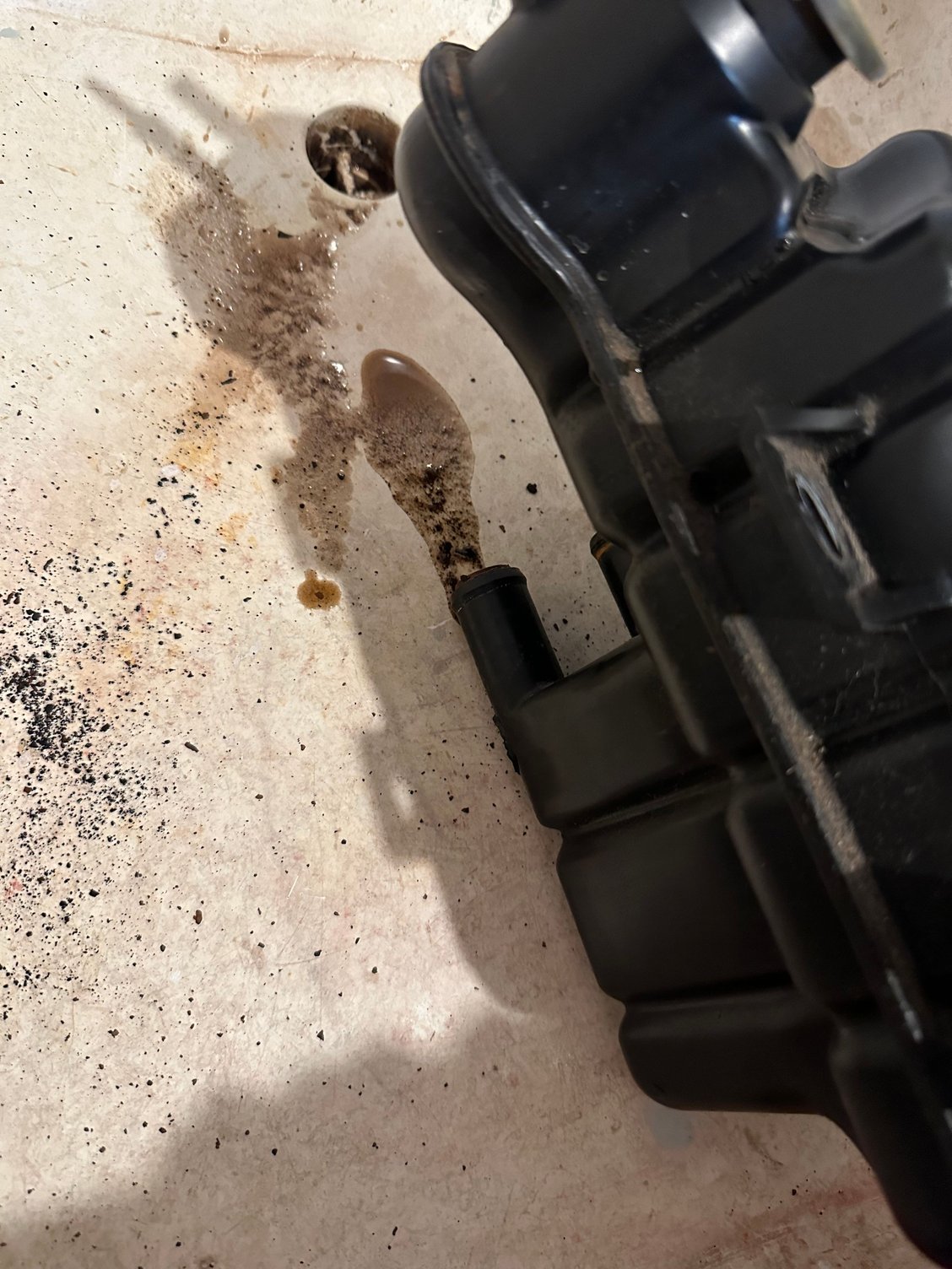

So while I’m waiting, I’ve been doing more of a deep dive on the cooling system with additional flushing.
This is my third attempt flushing the system since I bought the car. First time when I got the car it was absolutely putrid…maintenance people!!!! This weekend I flushed the radiator with a hose, flushed the heater core (second time since fall) etc.
I pulled the expansion tank and wow was it full of junk (even after some flushing in the car). I probably filled/shook/emptied the thing in the sink for 20-30 minutes straight. Gunk and rust flakes just kept coming out. Suddenly it started to rattle when I shook it…I bet the coolant level sensor had been stuck and finally let free.
Surge tank just after removal and after it had been flushed in car, puking in the sink:
after seeing this I highly recommend pulling that surge tank if the cooling system is in need of serious flushing. It wouldn’t come out without shaking.
Very glad I’m replacing ALL of the hoses too, PO(s) did me no favors:
Now what about the radiator with that much junk? It’s been fine…no leaks and no overheating…flush is running clear…so I guess I’ll just run it and hopefully save some time and money for now.
Based on the flushing it seems like almost all of the junk was in the surge tank and as a result some in the heater core
Btw water pump impeller looked fine:
