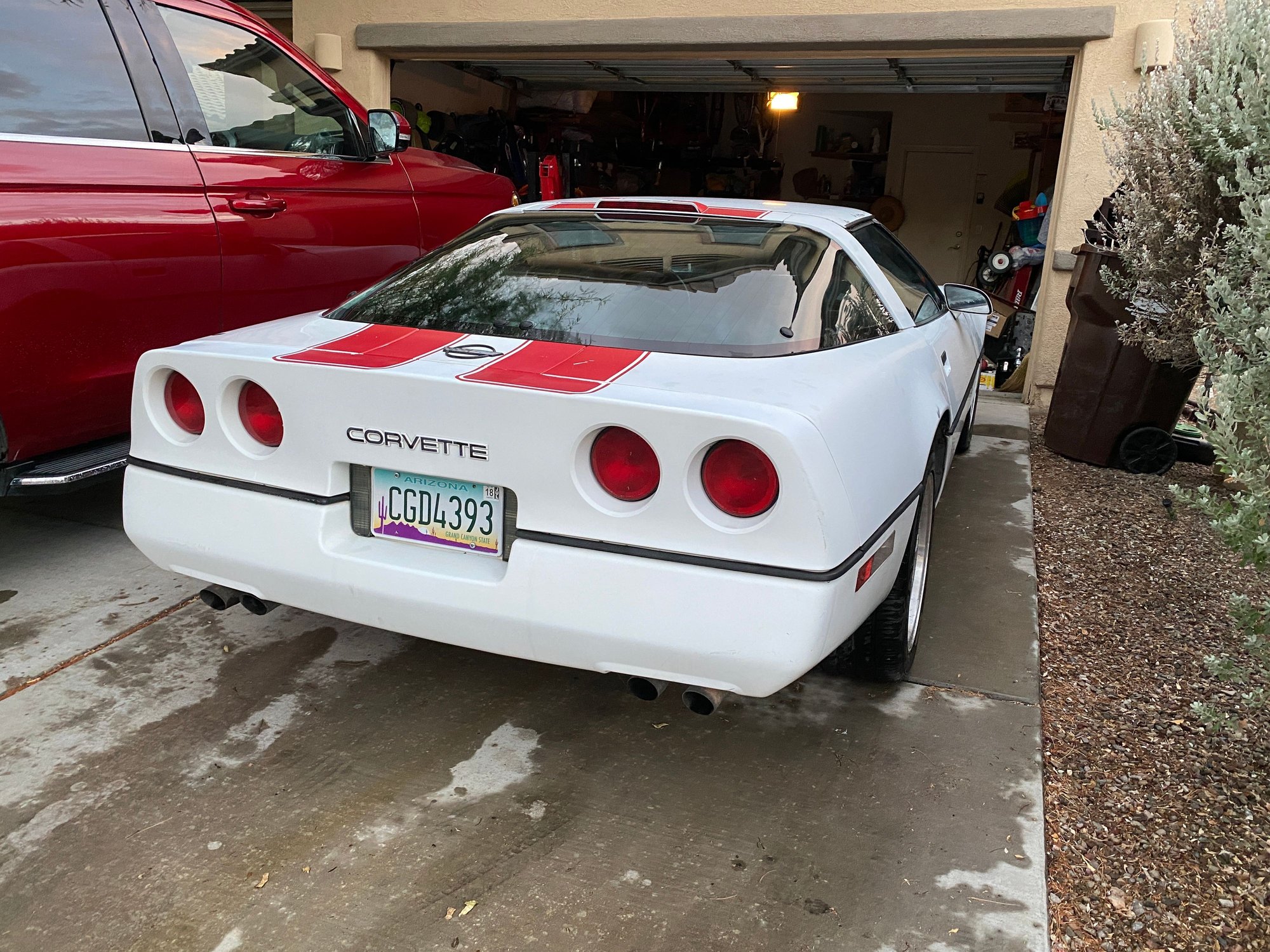

Agreed - great to have it on the road! Even better, it was so grimy that last night I had a hard time seeing out of it - so I dedicated this evening to giving it a good wash - first in at least 5 years! It looks SO much better.
With regard to the radiator, I haven’t taken the cover off to inspect more closely but it looks pretty clean from below. I flushed it with the hose before hooking it up to the new engine and other than some rust residue that washed out pretty quick it was pretty clean. I’m betting it was one of the last things done before the old engine bit the dust.
VATS…. I’m just going to pretend there’s no VATS problem for now and maybe something magical will cure it. It started fine today.
