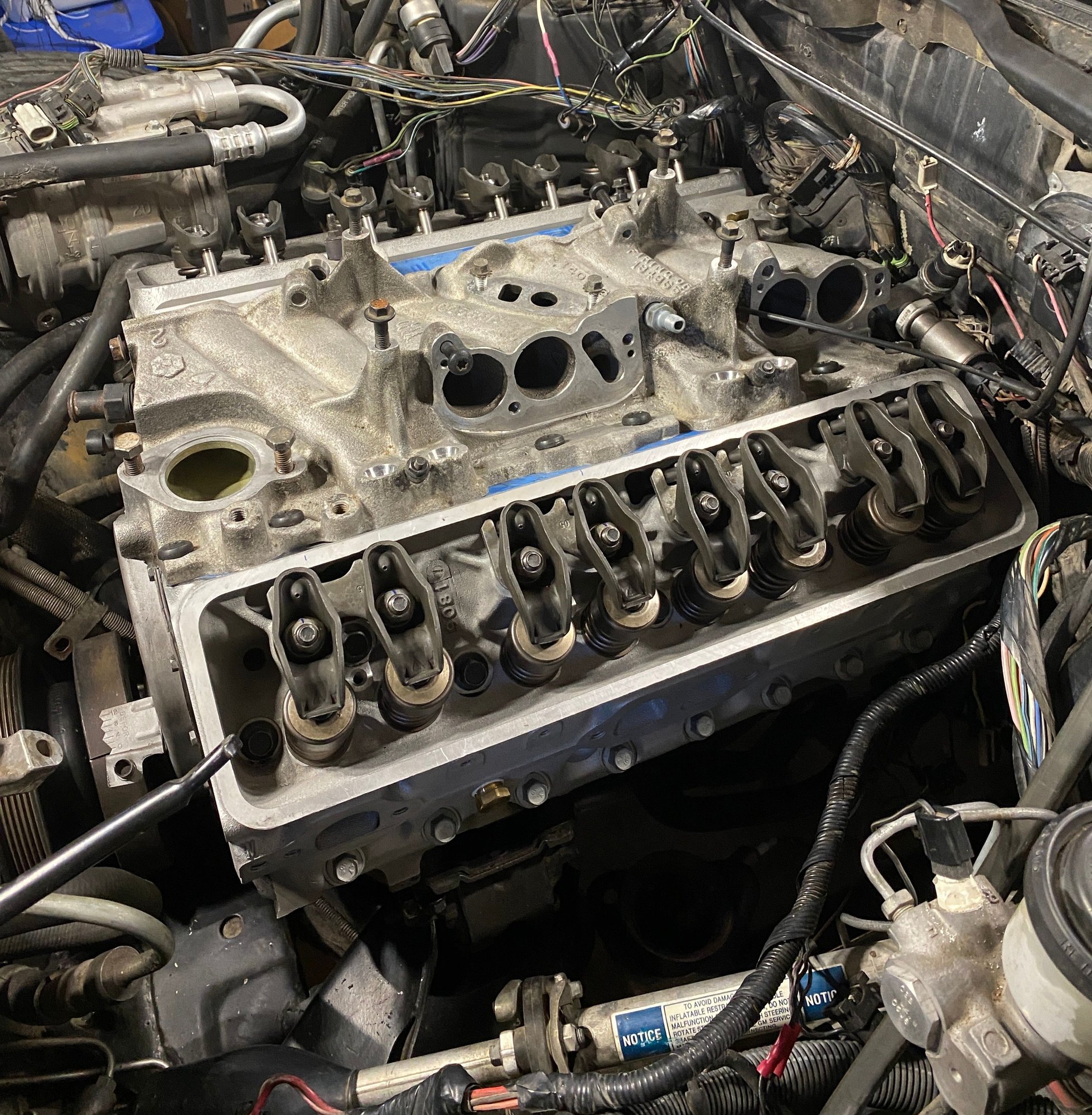

Potentially a minor snag today - got both heads on and torqued, which was great. But started preparing to place the pushrods and tighten rockers and came to the conclusion that my old pushrods are just too nasty, and I’m a bit worried that regardless stock ones will now be too short and/or weak to work the new springs etc. According to the machine shop tension is now about 330 lbs when open, which exceeds the rating of the stock pushrod replacements I’m seeing (for example Melling MPR373 which say max 300 lbs). I think I’ll do the Sharpie marker test with one of the old stock ones just to see how close it is with regard to length. But it might take a few days to get new ones if I need something special. Am I over thinking this?
New pushrods are cheap, so I agree. But why would they be too short now? Should just be stock length for roller lifters as you didnt do anything drastic valvetrain/milling wise. But also, yeah do the sharpie test to be sure.

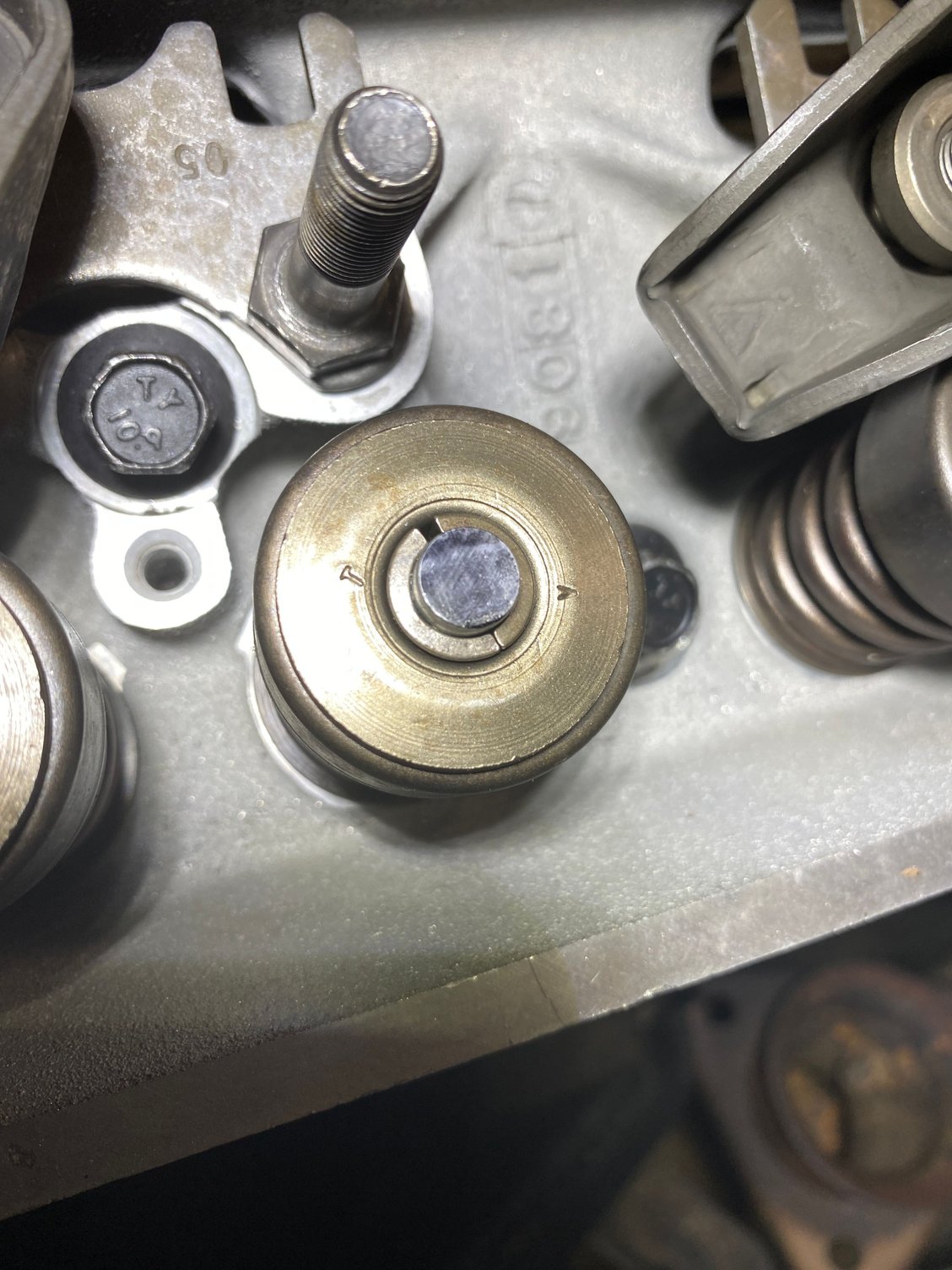

Probably only a small difference, just due to the resurfacing. But then I’m using what is probably a slightly thicker gasket.
Still need stronger pushrods in this case though, right?
Will post a pic of the test result.

Test result - a little hard to see but seems to be pretty close. Slightly lower than right in the middle (lash adjustment?) but stock length seems right.

Wellll… both heads are on, pushrods and rockers tightened and adjusted, was finally installing the intake manifold and stripped the threads of one of the intake bolts going into the head. The damn thing didn’t even take 20 ft lbs before giving way.
Is Heli-coil the way to go here?
Man, so frustrating. I hope none of the other threads strip.

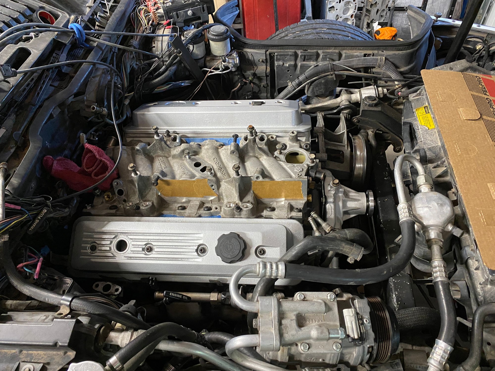

Water pump, exhaust manifolds, freshly-painted valve covers

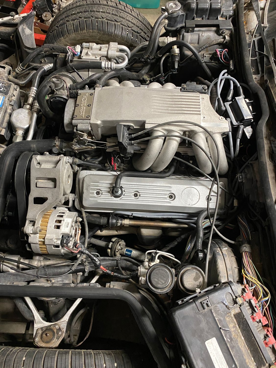

Distributor placed! Plus EGR tube and left accessory brackets

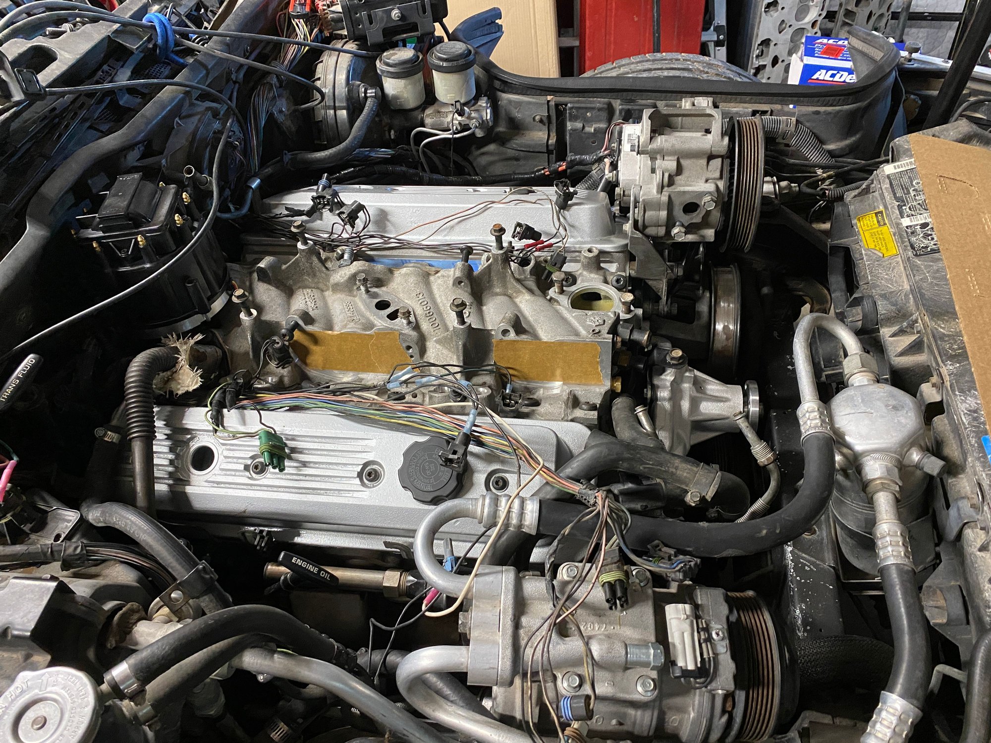

Right accessory brackets and hoses, ready for fuel rail!

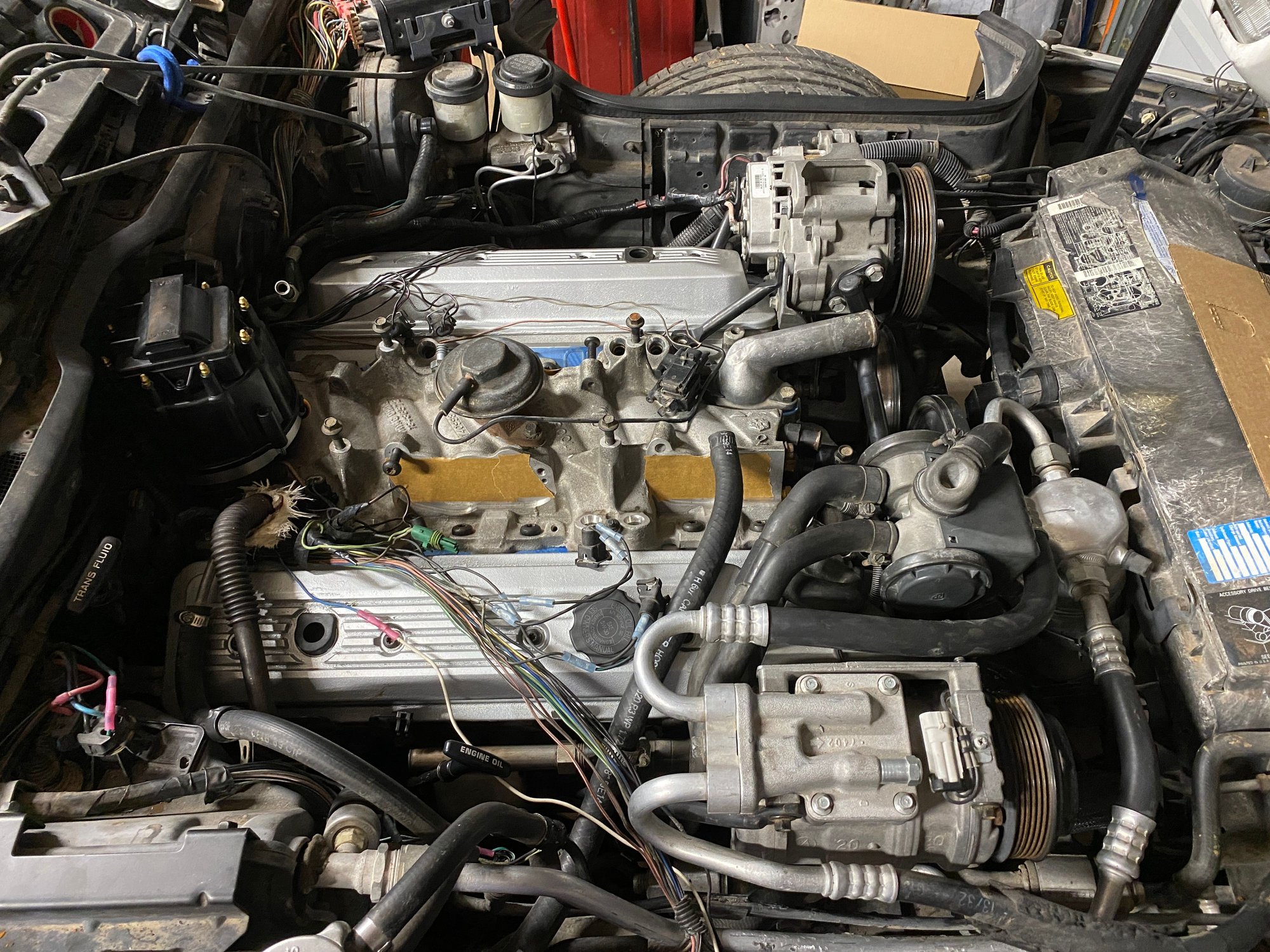

Full assembled! Minus a couple of vacuum lines
