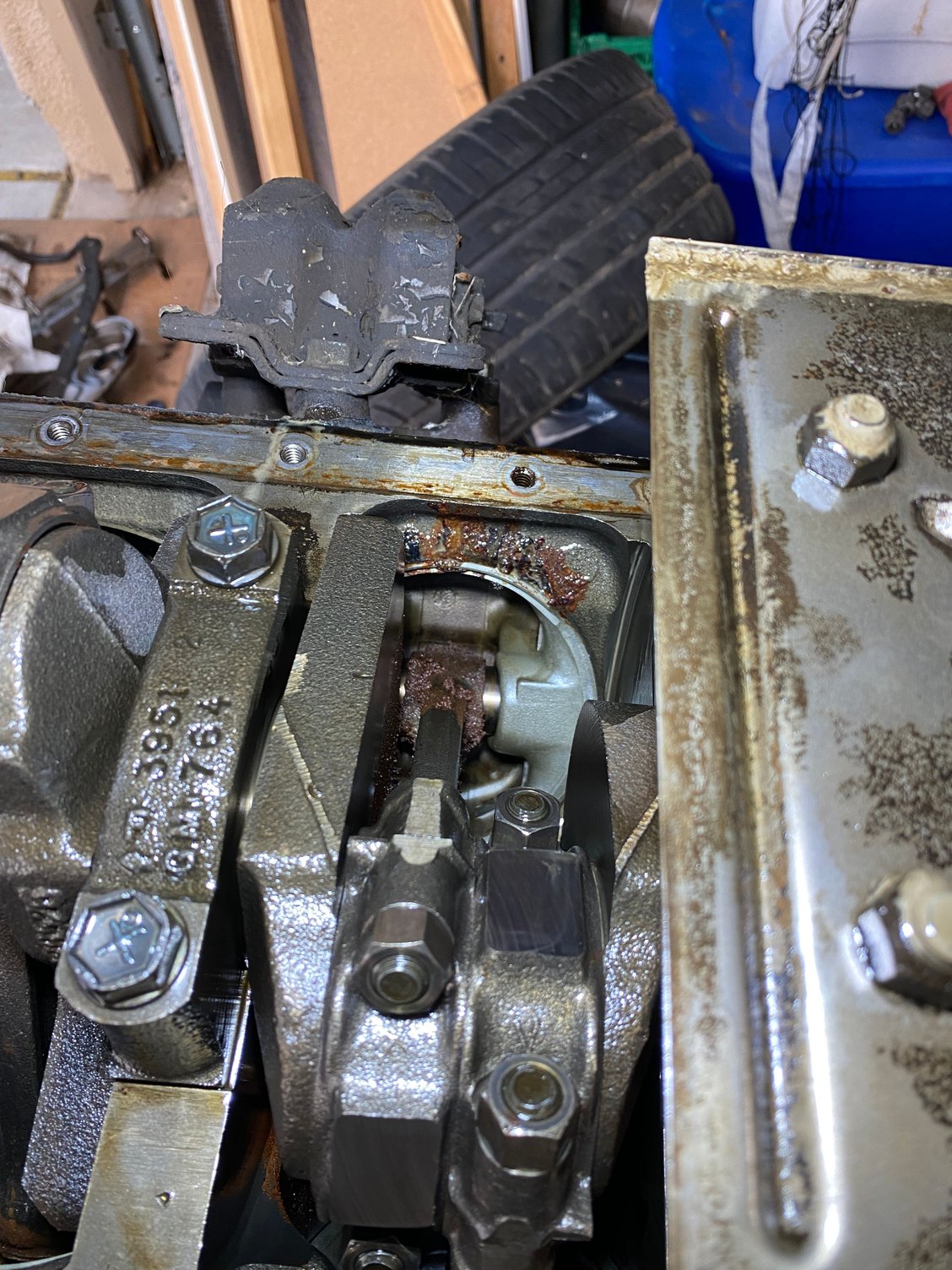

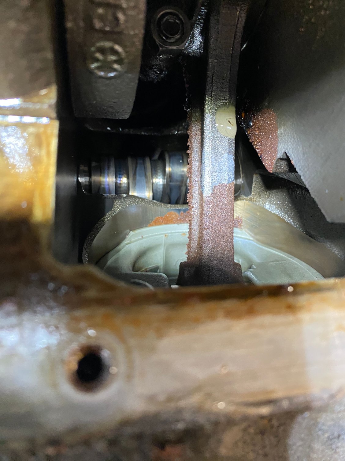

Rustbucket is out, and here is what it looks like underneath:
Cam looks interesting… not sure if that discoloration is just normal wear?
Rust on some of the rods, and some cylinder walls. The cam is definitely not stuck - I can move it just by pushing on the timing chain slack. Pretty sure the crank is also not stuck. Eventually I’ll disassemble further and we’ll see. For now I’m just getting off all the parts I need for the new block.

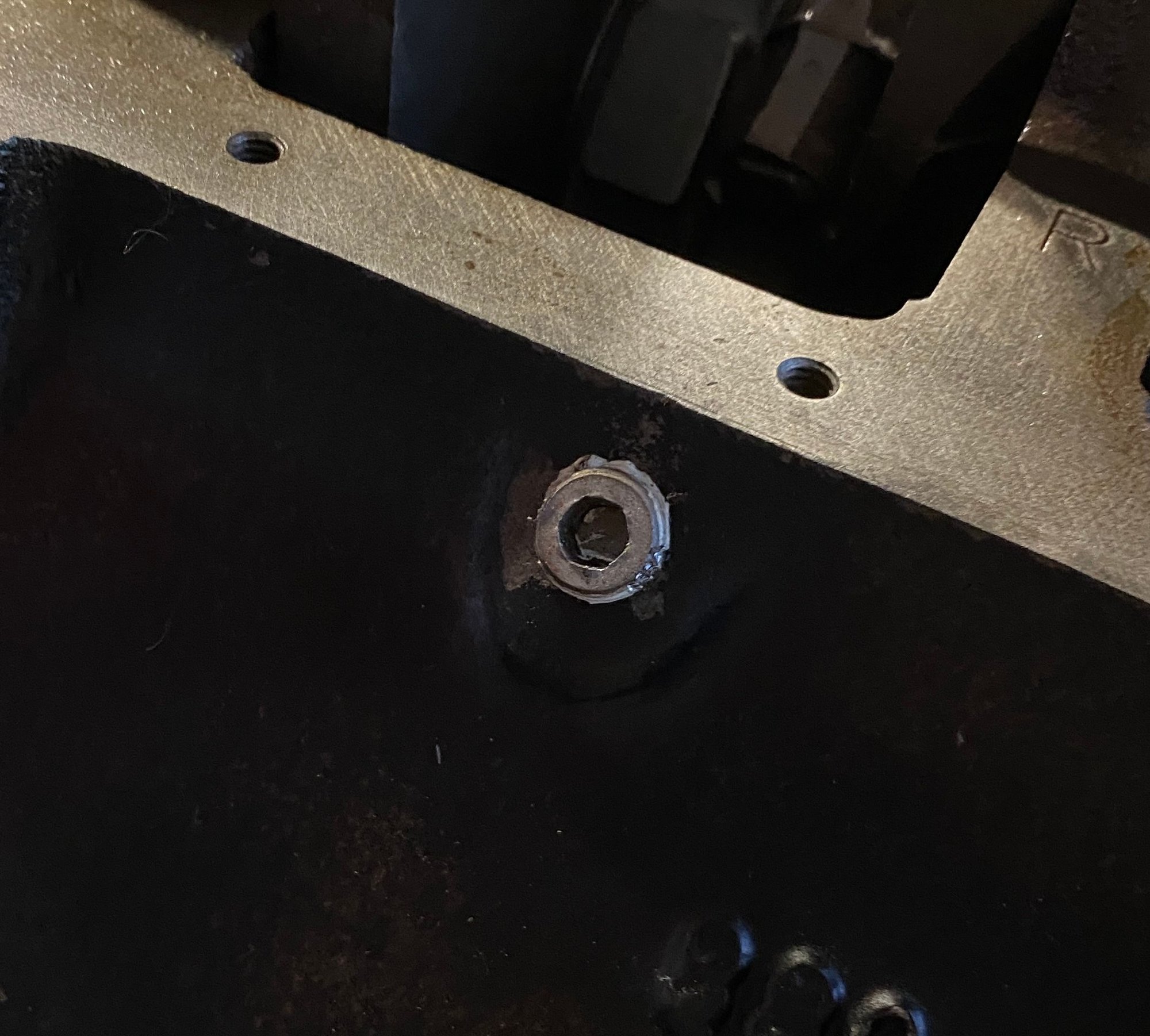

I think I found the answer to this question. The gasket intended for the filter adapter is the one with the thicker ring of material. However a few references online I found were folks recommending to skip the gasket, due to fears of gasket material making its way into oil passages. After sitting on the fence I decided to put the gasket on anyway. If GM originally intended for this I can't see it being a big risk.
Ran into a minor roadblock. The guy who rebuilt this small block put plugs in the two coolant passages on the bottom of the block, which are both used in my stock configuration - one side for the oil cooler hose connection and the other side for the knock sensor. Both of them are the kind you need a hex key to unscrew. And both were in so tight that the heads stripped. Fun.
I'll be drilling these out I guess. Not what I like to be doing to a freshly rebuilt block, but stuff happens I suppose.

Can you weld a nut on the plugs and turn them out. The heat should help loosen them up too.
That sounds like a great idea - I don't know how to weld though. Nor do I have the tools. I need to take a welding class at some point...
