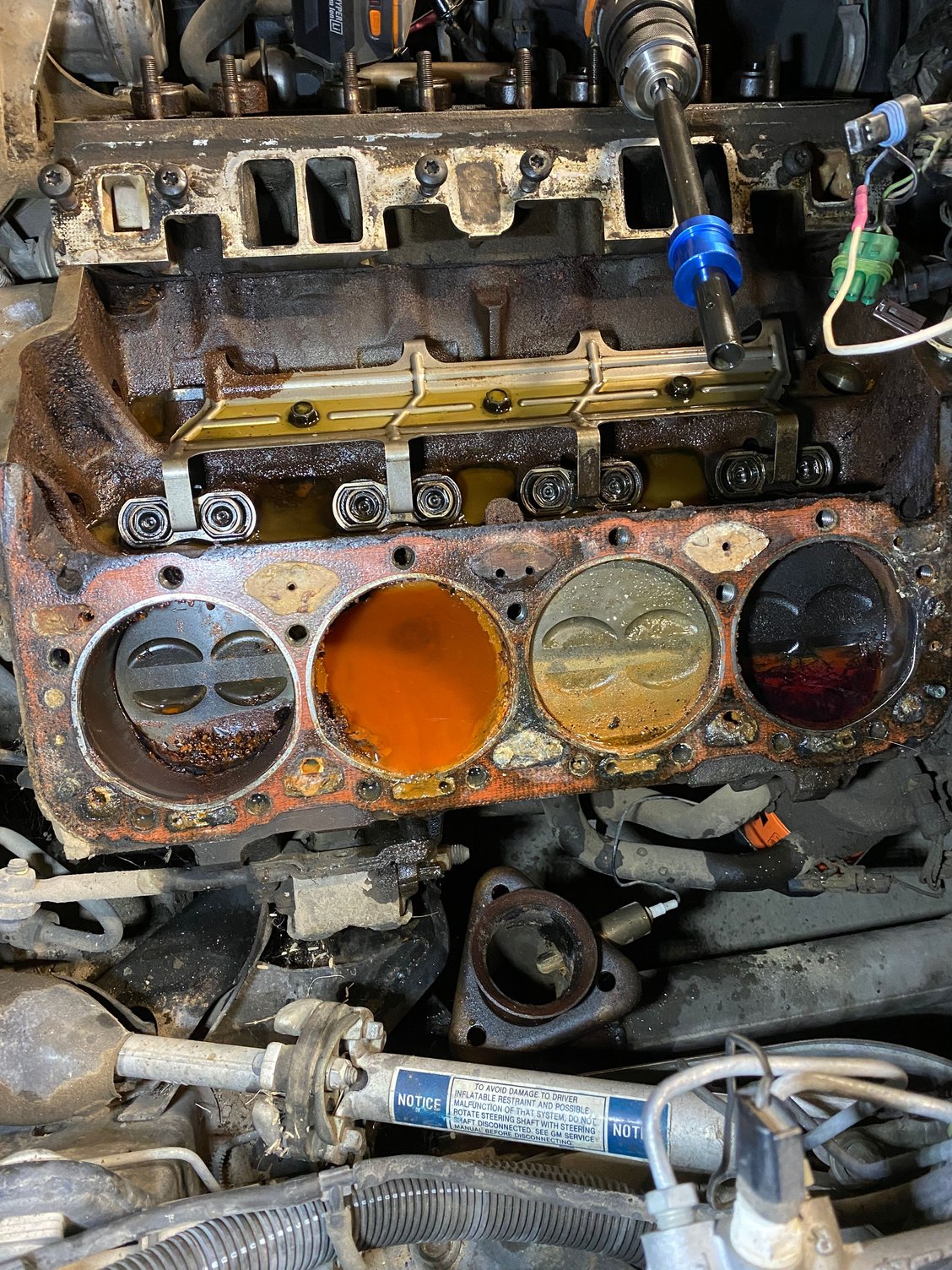

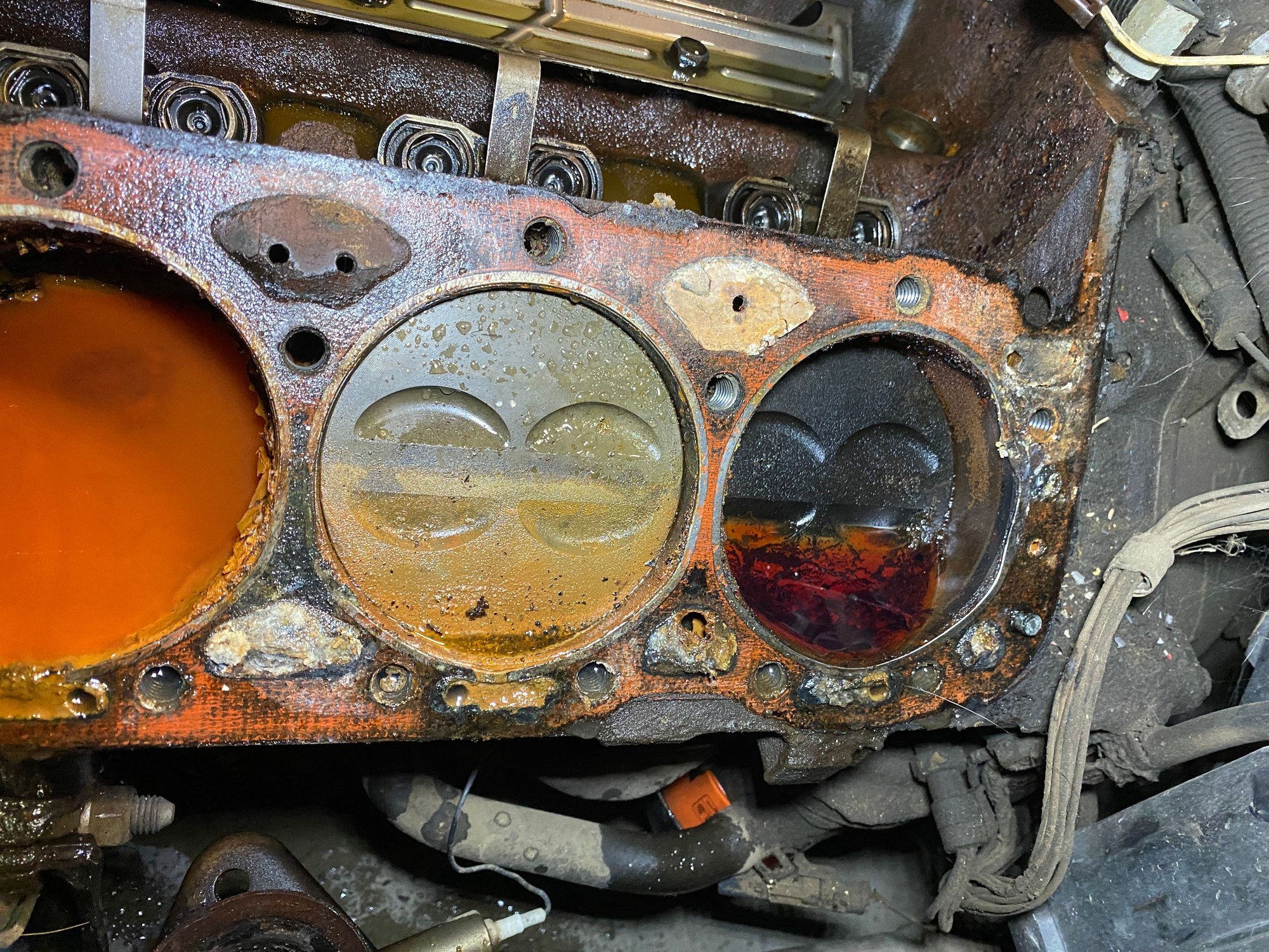

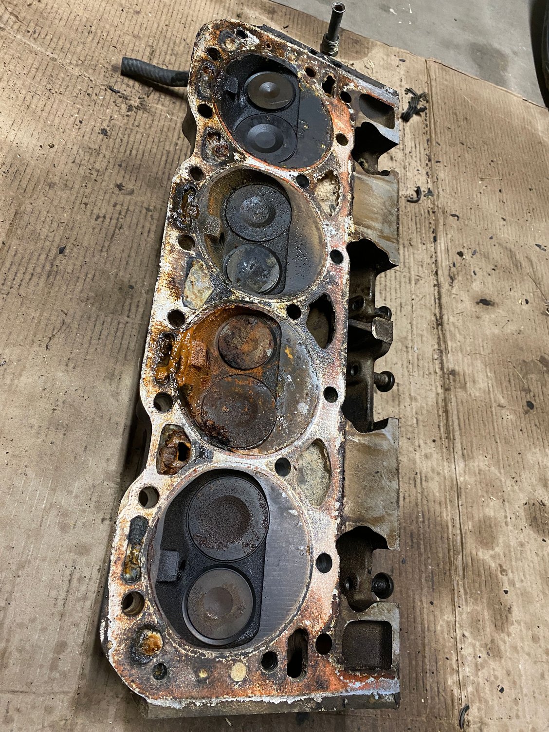

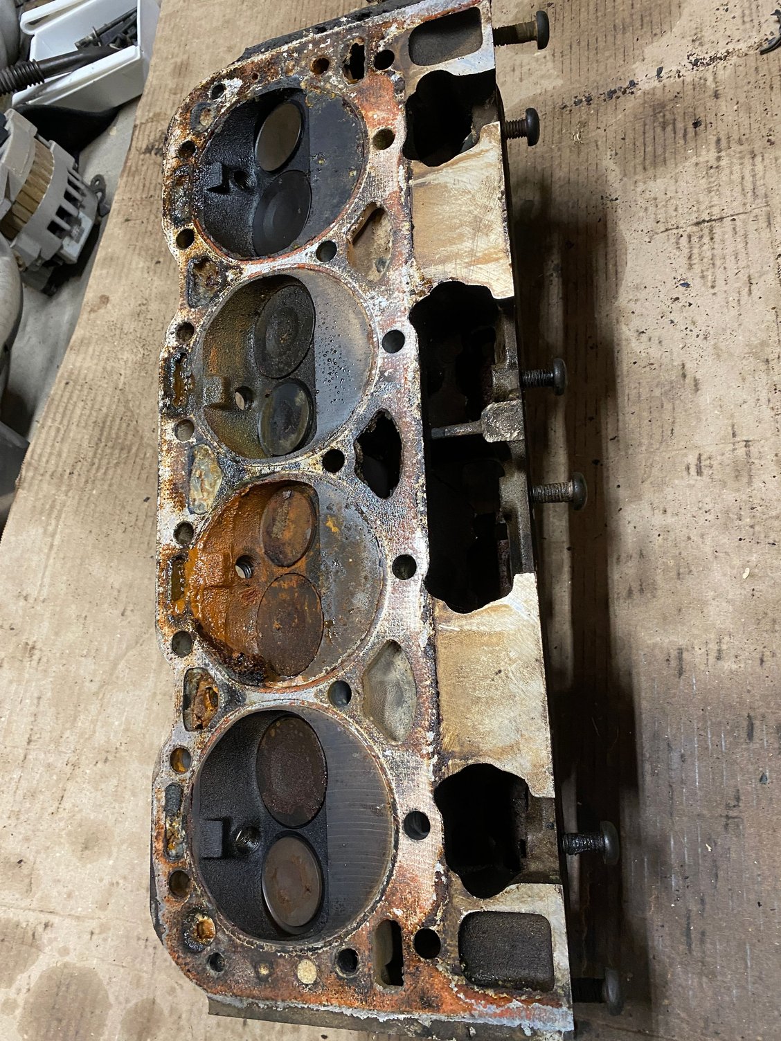

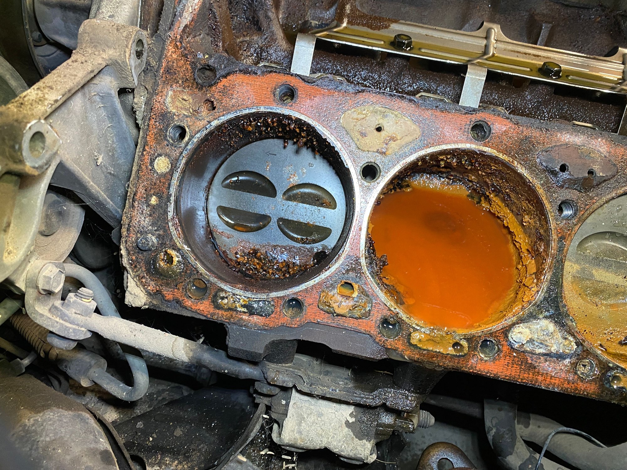

Weeell…. Couldn’t get it to budge so, left head is now off. Here’s what I’m dealing with:
Yuck!

clean it up and bang er free?

Was all that water in #3 when the head came off? I don't know if it's on its upstroke or its downstroke, but if upstroke, then that water could absolutely prevent you from turning the engine.

For sure it wouldn’t have helped. However I did have the plugs removed so it wouldn’t have stopped it completely.
It’s hard to see in the pics, but there’s a serious layer of rust on the cylinder walls and it’s really hard. I did bang with a mallet on all four pistons and they seem pretty solidly stuck.
If there’s any chance this thing will move I will need to remove the other head and do the same thing. But I’m starting to wonder if it’s a worthwhile exercise. I will try to clean up the accessible rust with some solvent and a nylon brush, and take a closer look at the cylinder walls. But if they are pitted badly, will it recover enough once it’s firing to last any significant amount of time?

definitely not looking good. not sure where you live but around me a tpi is worth about 1k

Originally Posted by IHBD
At this point I'd pull the engine and disassemble it. Ball-hone the cyls, remove the rings and clean the pistons. Evaluate the crankshaft bearing condition. Check the heads and decks for flatness. (Something caused the gaskets to let go again after the previous repair. ). Evaluate what you have. If this is going to be a patch-job, new rings, bearings, and a hand job valve lapping may get it running again with minimum expense.
Re #3: I think the water damage is going to be pretty deep and extensive. If the other 7 bores clean up satisfactorily, and the pistons clean up, are free on the pin, etc, consider having #3 sleeved to restore the bore to std size for the original piston.
Cheers.
This is good advice. Once you pull the other head you'll be only about 14 more bolts away from pulling the short block., and they're all pretty easy to reach with the heads off. There's a good chance you'll have to pull the torque converter out with the engine since you can't turn it, but not that huge of a deal either.
