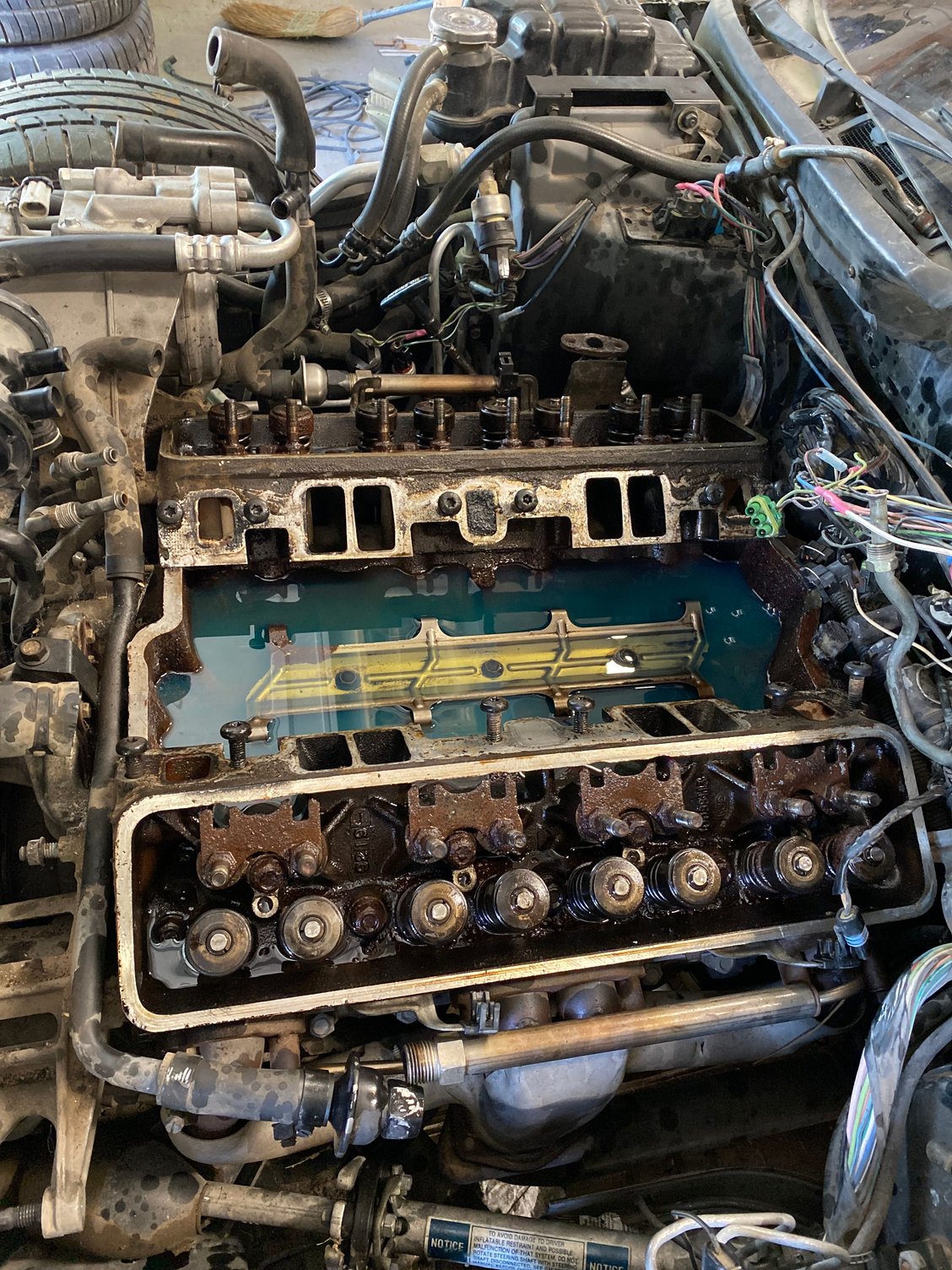

1st soak in progress, with 5 gal of diesel:
Man I thought 5 gallons would be more than enough to fill it to the brim!

There you go! I'm thinking that just about every rotating/ moving part is getting a good bath. This is turning out to be a very interesting thread. Can't wait to see what happens next. Who knows if it will ever run but if you can get it to rotate that will be a real accomplishment given what it looked like when you first opened it up. I've always been a sucker for trying to bring some neglected vehicle back from the dead. This qualifies for sure.

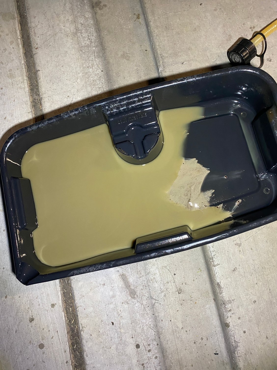

First drain of the diesel and this gray gunk is on the bottom of the pan, and some flakes of rust…
Old Apr 23, 2023 | 10:50 PM

It's working!
I'd probably start with the fly wheel, simply b/c you have better control and leverage than on the crank nut.
