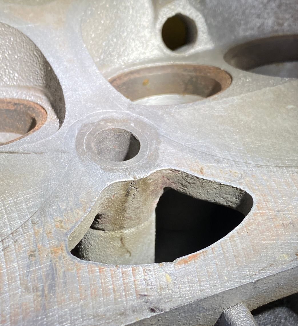

Bad news first. The heads I purchased came and at first glance looked great. But when I took them to the machine shop they found problems and suggested I return them and find others. Both had cracking at the middle most bolt area, and a steel sleeve had been inserted. One had some JB Weld applied:
(Black marks are just pen ink)
One of the original heads is repairable so I’m looking again for a single 113 or a matching pair. Posted in the parts wanted section.

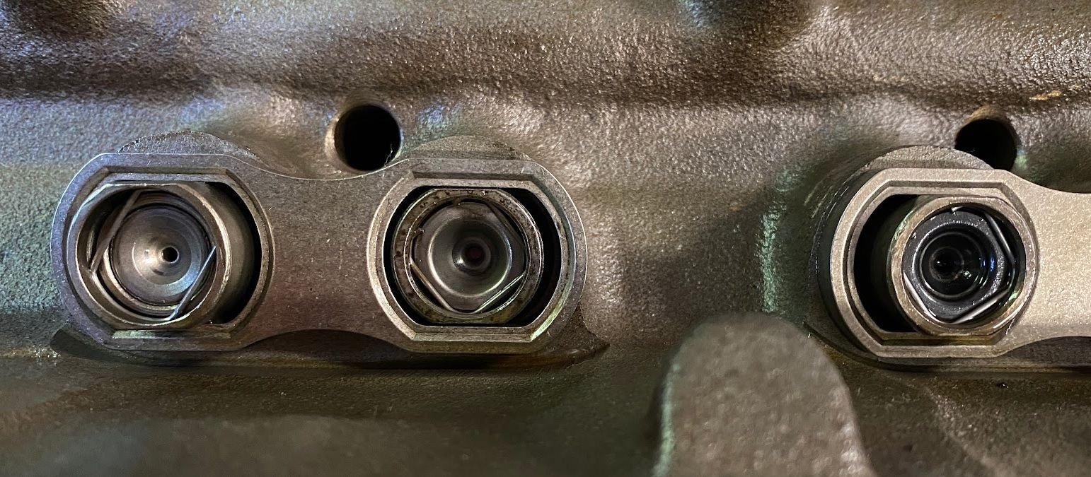

Question... The guy who sold me the block gave me lifters with it. I put them in place and then noticed they don't all match. One in particular looks to have a smaller oil hole:
In this pic you can see three different lifters. Is this OK?? I suppose I could use one (or all) of my old lifters in place but given the nasty oil that was in it and rusty pushrods I'm kind of leery. Is it a dumb idea to even reuse any of them?
Also, since this is the first time I'm putting lifters in, does orientation matter? I saw a note on one site about the side oil hole needing to be oriented toward the valley, but the FSM doesn't mention this detail at all.

IDK why the lifters have different hole sizes, but I'd guess that it doesn't matter for your type of build.
Lifter orientation doesn't matter.
Reusing old lifters ain't the BEST idea....but for this type of build I think it's fine. I'm putting together a junk 400 right now, for the Kart. I sourced my roller lifters from the junk yard.

I didn't notice if you noted but are those lifters roller type? If they are I don't think they will make any difference but if they are used flat lifters I don't think I would want to use them on a new cam. They would have some wear pattern and likely wouldn't have a good break in with the new cam.

Thanks for the feedback - they're roller lifters. I'll leave them and hopefully all will be good. All the rollers seemed fine.

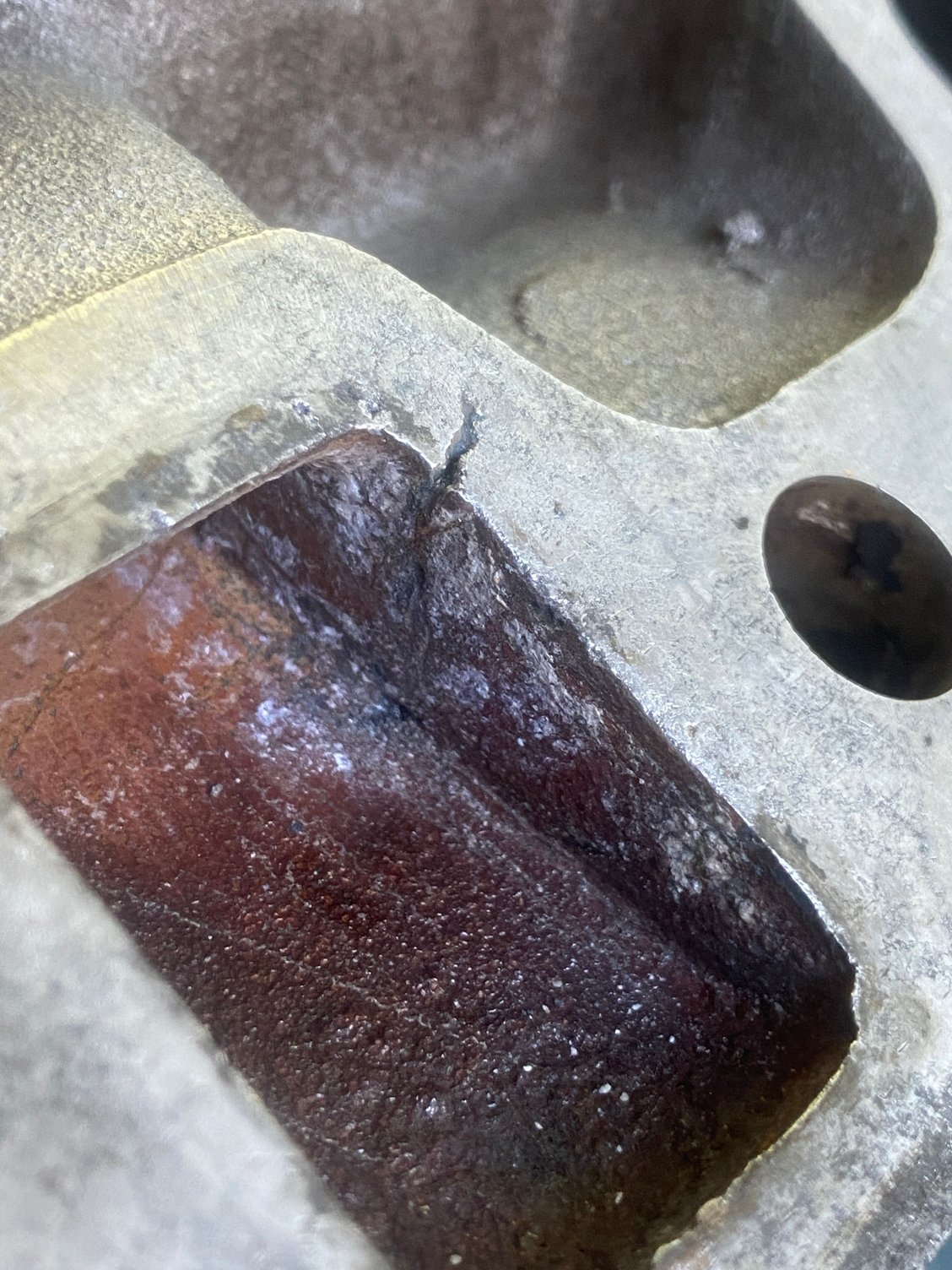

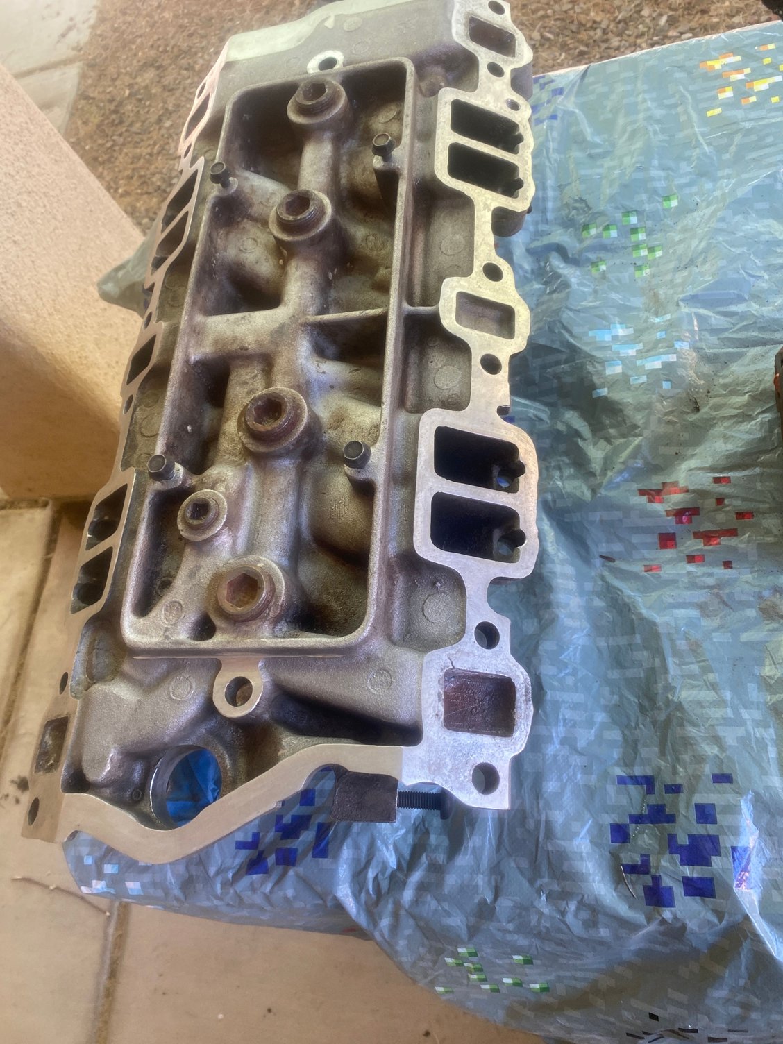

Getting to cleaning up parts that will be reinstalled soon. Intake manifold was looking good, until this got revealed:
Great. I guess I could have it repaired by the machine shop? It looks too big to ignore.

Is that a crack inside the runner to the left side of the picture also? I woulds say that the area at the gasket face could be filled but if the whole area has cracks then it might be better to find another one.

You may be right - I took as close of a look as I could, cleaned the area again, and it was hard to tell if that was a continuation of the crack or just a surface detail. But considering these intakes seem to be around $125 on EBay probably better to get a different one. The repair of the visible crack will probably be something around that cost anyway, I’m guessing.
I actually started down the path of “well, if I have to replace the intake…” but that could end up being too much of a $$ sink for this car and I’ve already gone way past my previous experience level on this project.

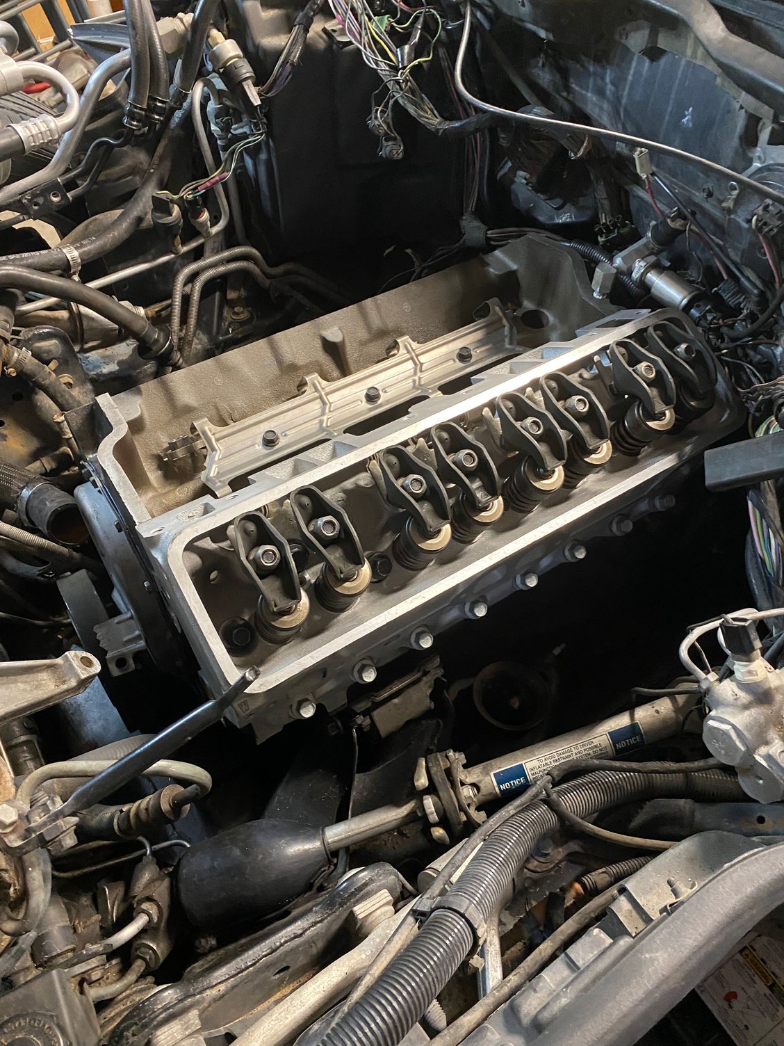

Potentially a minor snag today - got both heads on and torqued, which was great. But started preparing to place the pushrods and tighten rockers and came to the conclusion that my old pushrods are just too nasty, and I’m a bit worried that regardless stock ones will now be too short and/or weak to work the new springs etc. According to the machine shop tension is now about 330 lbs when open, which exceeds the rating of the stock pushrod replacements I’m seeing (for example Melling MPR373 which say max 300 lbs). I think I’ll do the Sharpie marker test with one of the old stock ones just to see how close it is with regard to length. But it might take a few days to get new ones if I need something special. Am I over thinking this?
