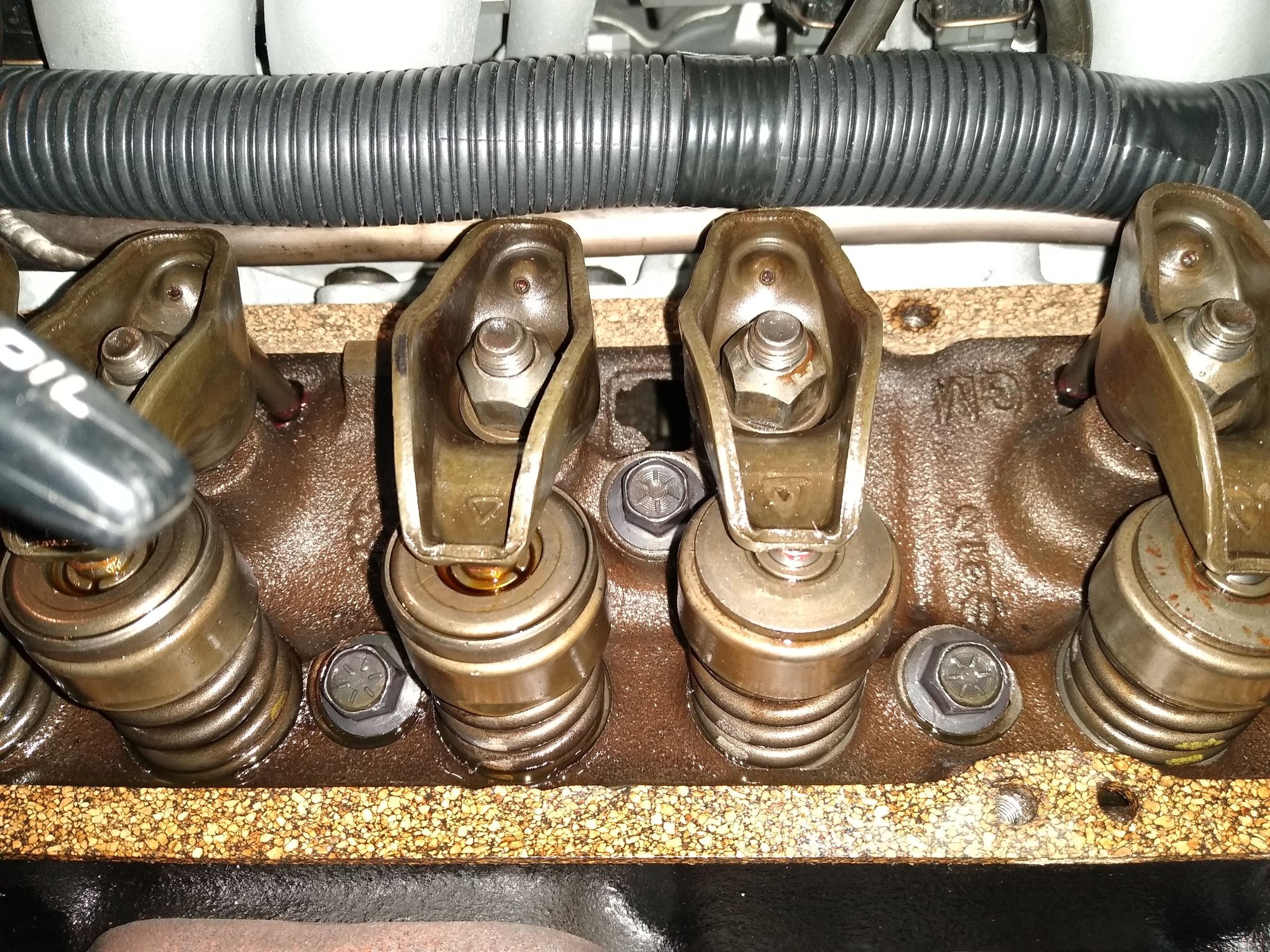

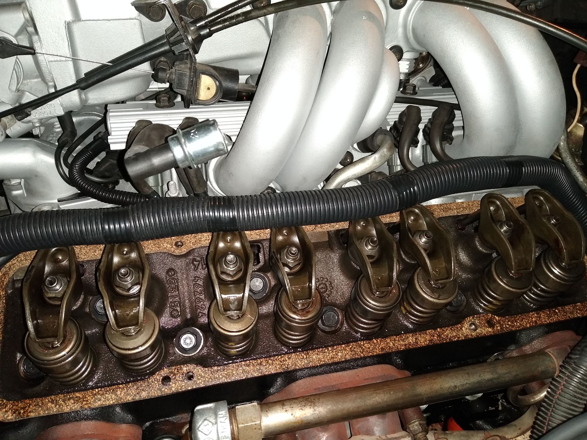

Did you happen to take any pictures of your repair process, specifically of the rocker-arms, after setting the lifters? #1 TDC occurs right after the #1 intake valve closes, this can be witnessed with the valve cover off....you could verify rotor orientation and timing marks this way, since it's hard to rotate the engine by hand and keep your finger over the #1 plug hole. If you in fact started adjusting lifters on #6 TDC, instead of #1 TDC, but thought you were on #1 TDC....that would certainly cause issues!!! I would take the valve covers off (post pictures of the rocker-arm studs on both heads), rotate engine to #1 TDC (watching the #1 intake valve as it closes and stopping when the damper lines up on zero degrees), back-off all the rocker-arm nuts and start over on lifter adjustment! Don't overthink it, rotate the push rods back and forth while slowly tightening the nut, when it's right there, you'll feel/see it stopping the spin, clock your wrench and tighten it 1/2 - 3/4 turn more (I like 1/2). It's ultra important that you set the correct valves on #1 & #6 TDC positions (exhaust valves line up with the exhaust manifold branches), use a Sharpie or dab of assembly lube to mark the rockers that have been set as you do them, triple check before rotating to #6 TDC, mark those and verify, then rotate to #1 TDC again (verifying timing is at zero) NOW drop your distributor in (put the cap on and mark the base with a vertical line exactly where the #1 plug tower is at) and verify rotor position...keep trying until it's lined up perfectly (you'll likely have to use a long screw driver to rotate the oil pump shaft to compensate for the "twist" of the distributor gear as it engages), I would get the distributor installed properly....by hand, not by "bumping" the engine to get the oil pump shaft to be properly seated! Anyway, I know you said you were very thorough on the lifter adjusting, but you don't have to tear everything apart again, just take the valve covers off do it one more time, it ran great before you worked on it, undo what you did and 100% verify it's right, if you still have issues, then I would focus on the new injectors/fuel delivery and possibly the timing chain...but if you were on #6 and thought it was #1, or you were setting exhaust valves and thought they were intake valves...I am in NO way trying to insult your intelligence or abilities, just trying to help and from your description of what it's doing now, the above suggestions are what I would do if I could get my hands on it!!! Good luck, don't despair, your engine/compression isn't suddenly bad, you'll figure it out and next time you'll be the one giving pointers👍
edit: I'm curious about rocker-arm studs pictures, because I wanted to see how much thread is above the nut on each stud.

This is great advice, thank you! I will try to post pictures either tonight or tomorrow, my work schedule is kinda hectic right now. I thought when I set the lash, all of the studs looked to have roughly the same amount of thread showing, but I'll give it another try with your process and make sure it's perfect.
