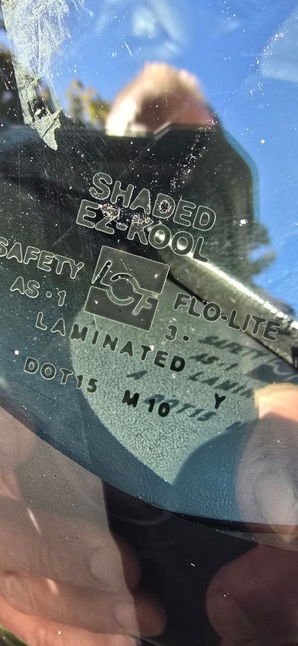

Hi, could anyone decode this windshield date?

Is that actually an A (then 1"+ gap) then Y?

3. y m 10

What is on the line with the Y? There should be only 2 letters on that line I believe.
I don't know what you used for a backer but it seems to have futzed what I would have expected. What year of car and what's the production date on the drivers door?

August of 1995. The A is not visible in your pic, only its shadow.

A is September. That's why I asked that he check production date on the door and confirm year. He could have any year and had a Sept '95 date coded windshield installed.

Ha you are correct sir! I mis-read my own link.

It's a 1996 that was built in September of 95. I missed the A

I'd say correct original for your build. You might check the doors to make sure they're a matched pair but likely won't match your windshield,

The door glass have august and September 95 on them so they all match
