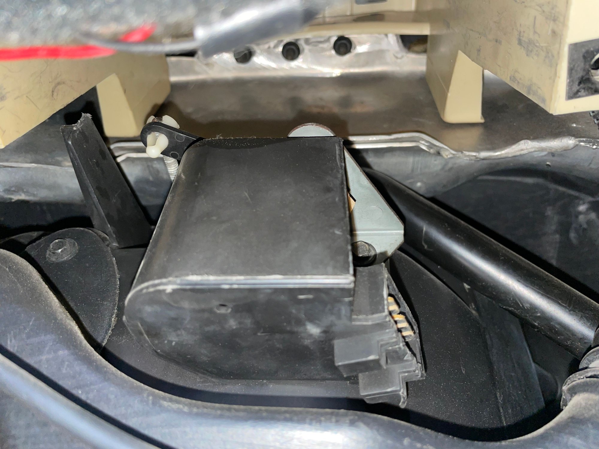

You can access the blend door motor after removing passenger side panel that has the courtesy light.
The ecm was unbolted and slid out to get this view.

It's possible it's an electrical problem but the most likely scenario is that the clip holding the blend door rod has become disconnected or broken. If it is broken there is a Dorman clip kit (75450), and the black clip will work on the setup.
Also clean up your electrical contacts on the connector while you're in there. Mine had an aftermarket stereo wiring jumbled in there so I had to remove quite a bit to access. It would be a tight fit with the ECM still bolted in there but Agent did it.
