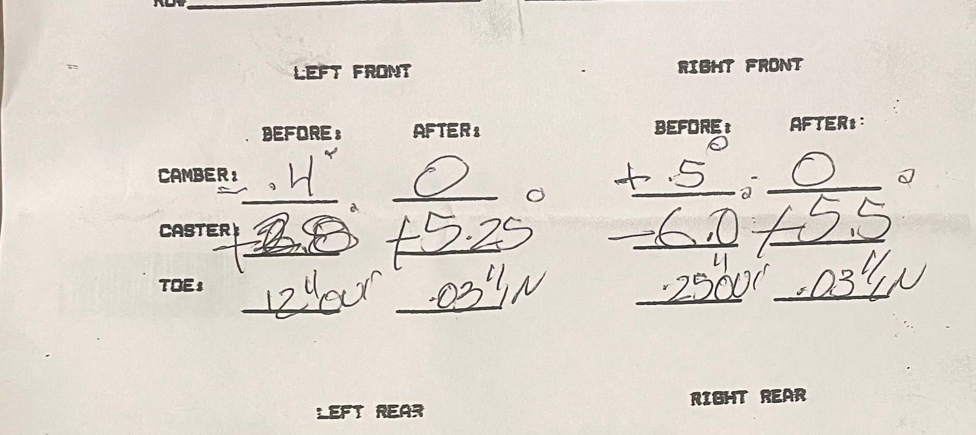

Got an alignment today and it took them two hours, they said the castor was way off but is now within spec according to them. I have the final numbers and I have to admit I'm not very verse as I should be on this topic. Do these numbers look acceptable and is this time frame consistent with other's experiences?
Thanks for your time and input!

I knew I kept this old bookmark around for something...
https://cartechstuff.blogspot.com/20...alignment.html
'88-96 Corvettes**
Left Front Right Front Left Rear Right Rear
Camber -1.0° -1.0° -1.2 ° -1.2°
Caster +5.5° +5.5°
Toe 0.00 0.00 -0.10 -0.10
Total Toe 0.00 - 0.20
​​​​​​'88 Corvette Challenge Specifications***
Camber -2.5° -2.5° -2.5° -2.5 °
Caster +5.5° to 6.0° +5.5° to 6.0°
Toe 0.0 0.0 3/16-inch 3/16-inch
Total Toe 0.0 3/8-inch

Thanks Natty! Ya come through every time!
Looks like it's close except for that left castor which is little off. I had changed both the inner / outer tie rods, shocks and lower ball joints. The article was right that it's tough finding someone to align it. The guy I use is pretty grumpy and sounds like he wishes he retired yesterday..

I can say whatever shop you used with today alignment rack they give you computer printed page with all spec. setting.
I would say they couple generation old, using paper they hand fill out.

Doesn't look like any of them are exactly right.

Do they use chickens to scratch out the sheets at this alignment place ?
5 degrees of positive castor is ok for the C4 (usually between 3 and 6 degrees depending on use)
0 degrees of camber is no good, you should really be aiming at .5 to 1 degree of negative camber (depending on use)

I'll have to look for the videos. I did see a couple of rough alignment videos using string to adjust toe just to drive it to the shop, and I was able to eyeball that good enough to steer. I don't believe I saw any computers in this shop, he's got a bunch of old porches around. The tech did ask if "do I drive it alot", which I didn't find encouraging..

It will be used as a weekend pleasure cruiser. Should I take it back to him to correct the camber? I may get a little spirited with it in the hills but no track likely..
