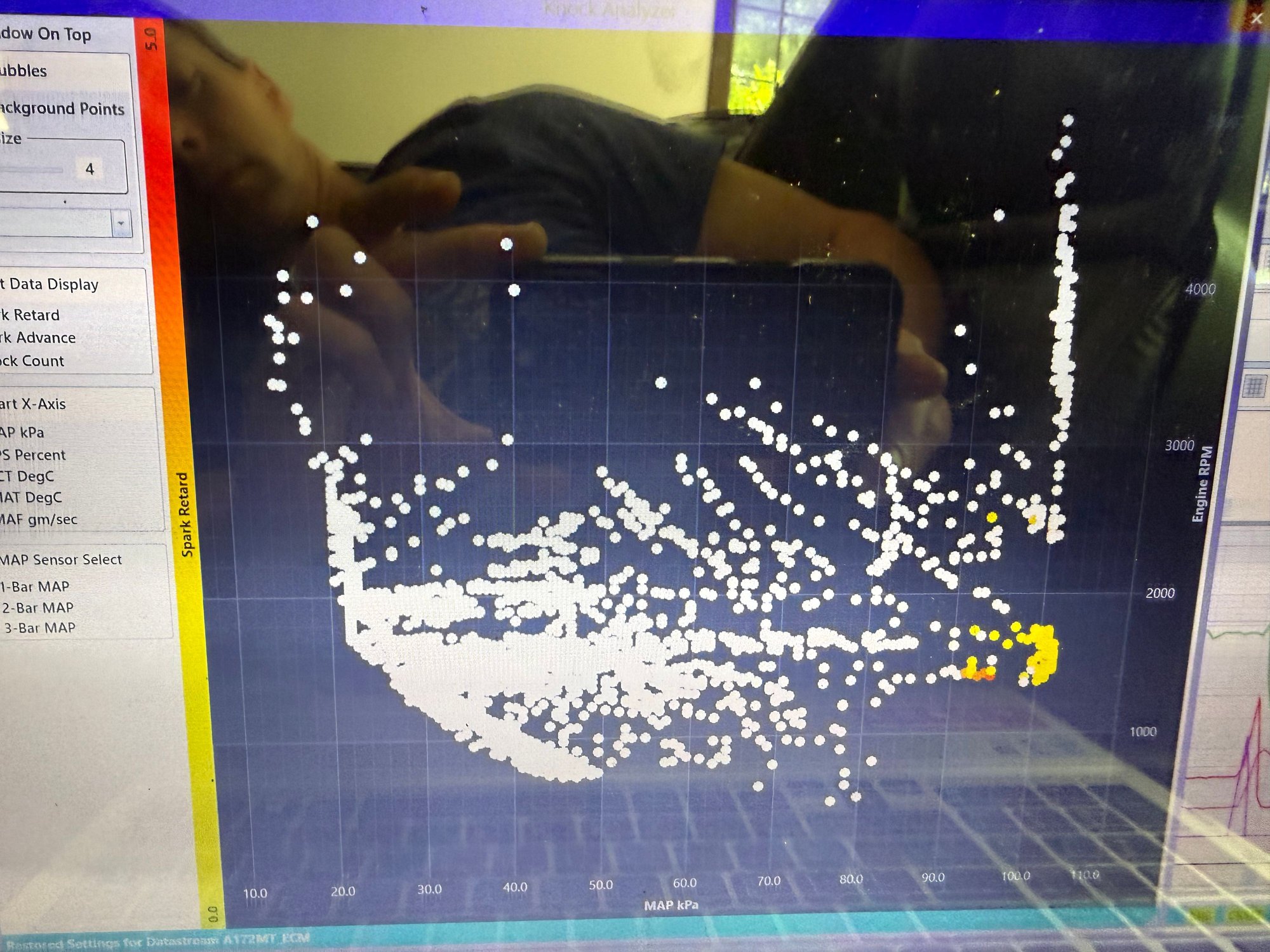

Ok i just added 8 more gallons of 87 octane so now i am likely at 87 octane
this drive had a lot of full throttle uphills, mashing the gas while lugging in 6th on the highway (which really seems to get some knock)
as you can see, i got knock.
note that at higher rpm, no issues
i need to reduce spark adv 2 deg in those areas
(forget my face in the photo, i tried to keep out of it)
Not sure if that laptop that you're doing tuning is also the device that you're posting on Corvette Forum from, but if you don't want to have to keep using your phone, you can always hit "CTRL-PRNT" (or Prt Sc). The "print screen" button is located just above the Insert button on the 101 key keyboard. It copies the focused window into the clipboard, and then you go into paint and hit CTRL-V. You can then save it as a JPG and upload it instead of a cell phone screen shot.
If you knew all this and I'm missing something, then ignore me... but it's probably easier. I think Windows has had a newer clipping tool already built in since Windows 8, but I've never used it, so someone more up to speed on that can help. I'm of the generation that used to set the time on the VCR.
