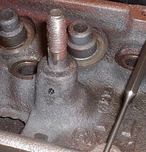

Your going to want to stay under .490 I've seen even stock cams pop the stud out. I would have the heads drilled and tapped for studs or pin the studs with a 3/32 dowel pin.

Summit sells a tool for removing the pressed in studs and is also a guide for drilling and tapping for screw in studs.

I used the tool-pretty easy, I did this because a couple of the pressed ins actually backed out-but the heads were tired-I don't think cam lift has alot to do with it as much as what you're doing with the car-drag etc.-for a DD, and occassional run or so I think your fine.

I'd like to point out its not really a matter of how much total lift the camshaft has that causes pressed in studes to come out of the head. Its a matter of valve spring pressure and the opening/closing rates on the cam.
As a general rule on our limited class oval track engines, if an engine has over 120lbs (seat) and 350lbs of spring pressure (open) we at least use the Mr Gasket "stock apearing" screw in studs. If the rules allow we use conventional screw in studs and guide plates but that cost more money as you have to machine down the rocker stud pad and many tracks forbid it in a attempt to cut the cost of engines in the class and limit HP potentional.
This does not mean every set of heads in the world with pressed in rocker studs will start popping them out once you reach/exceed 120/350lbs of valve spring pressure. Some will go much more before failure and some will never make it that far. I do not pin stock rocker studs, nor would I recommend anyone doing it anymore. Its far to easy and inexpensive to pull the press in studs out and tap the holes and install the Mr Gasket stock apearing screw in studs. Yes it helps to have a mill or Seat and Guide machine so that you tap them all perfectly strait but if your really cheap and don't want to pay a machinest (or just like doing things yourself)... take your time, pay a little attention to detail and you can accomplish it tapping by hand.
