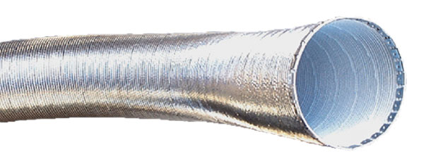

You could use the same type of heat shielding they put on fuel lines
http://www.pegasusautoracing.com/pro...p?Product=1831
Actually not a bad idea to wrap the fuel lines and the intake track.
