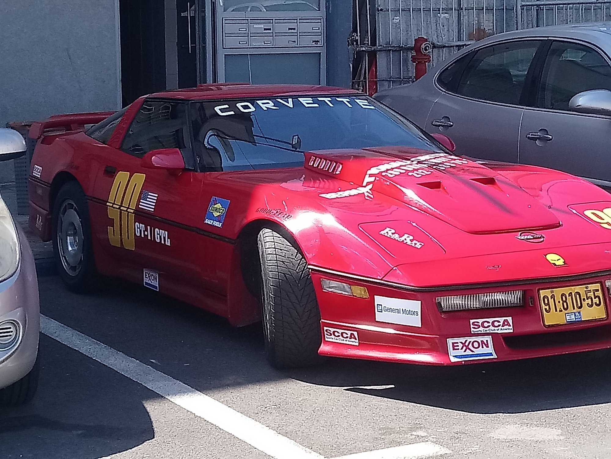

Hallo guys, I own a 1986 Chevrolet Corvette and I had the same problem with the maf sensor, I went to a really good macanic and what he did is disconecting the maf sensor plug and while the car switched off and then after you turn on the engine and everything works fine, I drive all the time since then and the car works clean.
