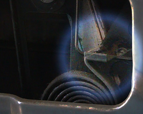

I think I have a different problem now. Driver's side window stopped working and never goes down. Motor is working ok, but the window is always in top position. It seems lost connection between the motor gear and the regulator rod? Any idea what is wrong with it before I take it apart... Thanks!

Same thing happened to me. Motor made all the right noises, but no action. It's the window regulator. I highly recommend having the FSM or Factory Service Manual before attemping this. You'll need to scribe the locations of all the bolts on the window bumpers and guides, as well as the bolts on the regulator, to ensure a good fit and function when you're done replacing the regulator. Take a lot of photo's as well, believe me, I needed to refer to them, while reassembling the door. Not an easy job, but doable with patience.

Thanks for your advices! I thought it won't be easy... I have the FSM and I am going to disassemble the door soon and probably I will need an other regulator, will see. Thanks again.
