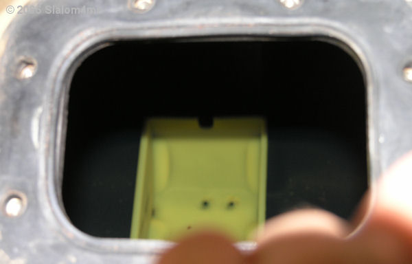

Originally Posted by ride250s
Anyone have any idea what the problem could be?
The filter sock on the end of the fuel pump is uncovered and the
pump is drawing air instead of fuel.
It is possible that the fuel pump assembly is not extending as far
downward as it might. Two tubes run down from the filler plate,
the pump is on the end of one and the sock is intended to sit
within the walls of a shallow tray that runs fore/aft slightly above
the tank bottom. Bends in the tubes can be manipulated to lower
or raise the elevation of the sock, relative to the tray.
Caution: fuel vapours are highly flammable. Flash photography
in the vicinity of the fuel tank may cause ignition of fuel vapours.
The simple solution is to ensure that the fuel level is sufficiently
high so as to prevent starvation while cornering.
