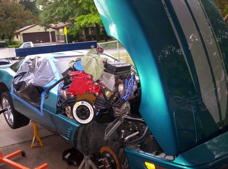

I've pulled C4 engines - both L98s and LT1s, half a dozen times. Each time:
Hood IN PLACE
Trans/Converter IN PLACE
Radiator and fans IN PLACE
Water Pump ON ENGINE
Exhaust Manifolds ON ENGINE
Heads, intake, valve covers, Opti, Balancer ON ENGINE
Lifter Pre-Load Set
Spark Plugs INSTALLED
Plug Wires INSTALLED
Two Nuts at Motor Mounts REMOVED
Exhaust system REMOVED
388 going in:
About 6 hours working alone. More than one way to skin a cat.
Jake

Jake, sounds good. where did you hook the chain to, to pull it.
