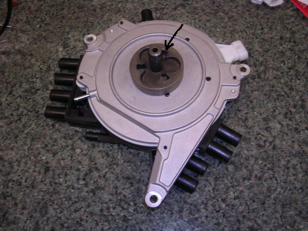

I removed the new opti and re-installed the old one and it fired up. Is there only one possible position for the opti? I mean, could I installed it incorrectly? and how do you know the proper position for it? I noticed that there is a pin and I made sure that the squared slot and the pin are aligned. It appeared to be ok but I seemed a little bit cricked. Thanks. 96 Lt4

The opti and the shaft alignment can only go on one correct way. There is always the chance the new opti is bad.
I would add a pix to the post of the shaft but only have pictures for 92-94 opti which is a different opti. Perhaps someone might chime in with a pix but it think it sound like you understand the basics of aligning the shaft.
What was your original problem which led you to change the opti?

This is the slot you should use. It's the one with the little square on the top. My arrow got in the way...

The GenII Opti ('95 and '96) has a better interface design than the GenI design. It is virtually impossible to mount a GenII incorrectly. Try as you might, you cannot get a GenII to mount FLUSH to the front of the timing cover if the cam dowel pin is not positioned correctly with the indexed groove in the Opti. That's what the dowel pin was designed to do, only allow Opti to fit one way. So I think you installed the new one correctly if you got it lined up and the Opti popped on FLUSH.
