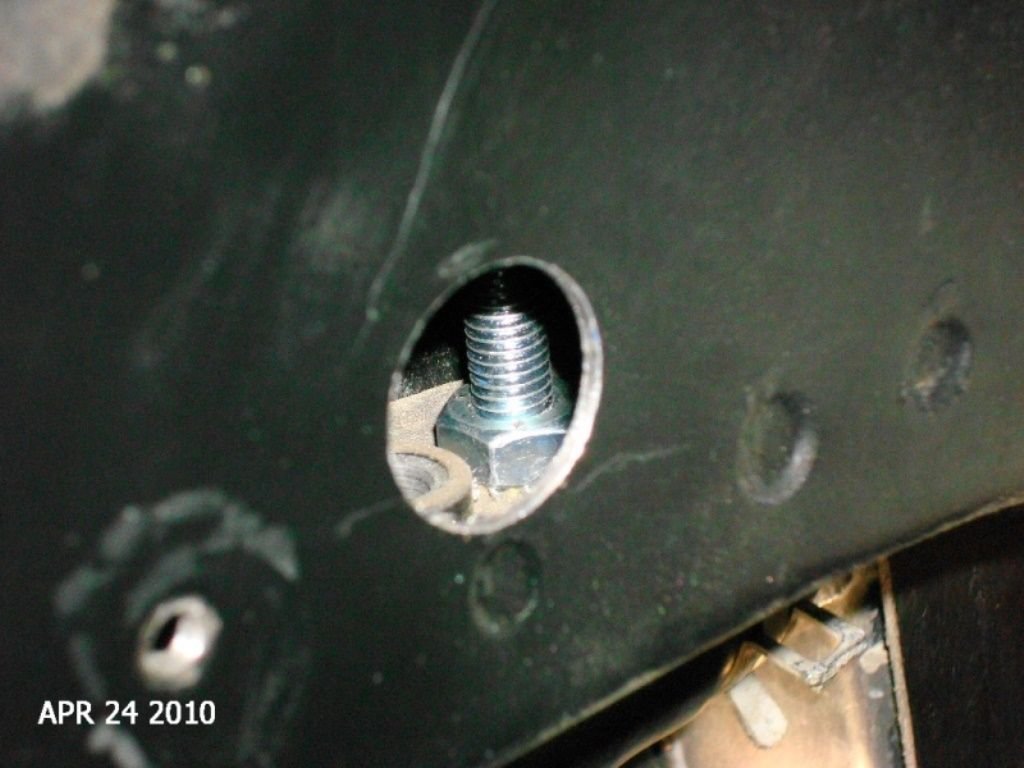

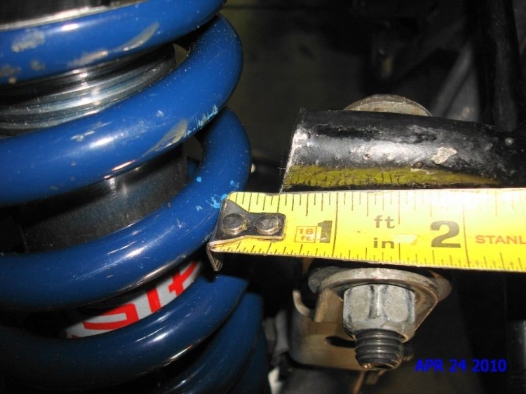

The sway bar needs to be relocated 3/4" forward.
drilled out a hole big enough to reach the new hardware.
Plenty of space

I like your idea for the swap bar relocation. I talked to a few guys that have done their own blend of parts (for a coil over setup) and just ended up going with Exotic Muscle end-links. which are very narrow bodied and seem to clear the coil overs completely. Avoiding the dreaded swap bar relocation.
Although I would prefer this method, because it's clean and causes the least amount of alteration to the frame.
Thanks, I wanted to go that route but the sway bar was touching the coilover and it needed to be relocated.

You were shopping in the "wrong" store for the hardware you needed. You should have been attempting to "match" the balance of the hardware used in the asssembly of the suspension components. I was actually going to suggest last evening that you replace the hardware with the "right stuff". You need the correct DIN and 10.9 property class and NOT CAD plated hardware. The bolts & nuts should be washer faced and the nuts should be "prevailing torque" the "right stuff" by part number should be easier to find than "off the shelf" at NAPA, HD. Fastenall yes but they will be a special order and maybe minimum quanities.
The nut for the attatching point in your snapshot will likely require a "hit" with a grinder to clear the original factory weld nut inside.
Your "hole saw cut" is actually a good move and if you made it a popular bore you could likely go behind your self and snap in a "cap plug"! It would finish the install nicely. There are several different styles of "cap plugs" and I won't bother mentioning a type.
If you know the dimensions of the bolts you used I'l supply a GM number for you for the "right stuff"! They will match the balance of the hardware on the car!

Here I go. Got the right hardware from a store about 30 minutes from home.
Believe it or not all these for $2.94
Coat of paint-
Dave suggested a cap but I could not find one and it will be covered by the inner fender.
