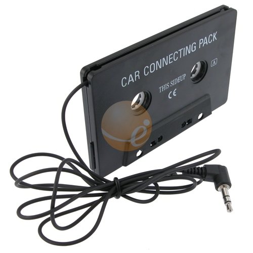

I personally would put your CDs on a MP3 player. Then use this and plug it in your tape deck! They are cheap (under $10).
I have a CD player and tape deck and I dont even use the CD player

This is what I do, too. But if the OP really wants to play CDs, he could use the same adapter connected to a Discman-type of portable CD player, instead of an Ipod.

What am I doing wrong?
I've purchased 2 of these MP3/CD cassette adapters (different Mfg's) and neither works in my 87, although both work in my portable cassette player.
After inserting in car cassette player, the player switches from forward to reverse to foward...then immediately pops out. Sometimes I will hear the MP3 play...but that lasts for no more than 2 seconds...then pops out.
I would appreciate your opinions.
Thanks,
JT
PS...regular cassette tapes play ok in the car player.

A lot of players have a sensor that detects drag on the capstan and/or take-up spindle. If the adapter presents too much drag on the take-up spindles, the deck will be fooled into thinking that the "tape" has reached its end, and it will auto-reverse. If it tries that, and still sees a lot of drag, it'll presume there's something wrong with the "tape", and will puke it back at you.
If you don't mind experimenting, remove the gears that connect the wheels in the adapter, and see if that makes it work. Might work, might not.
