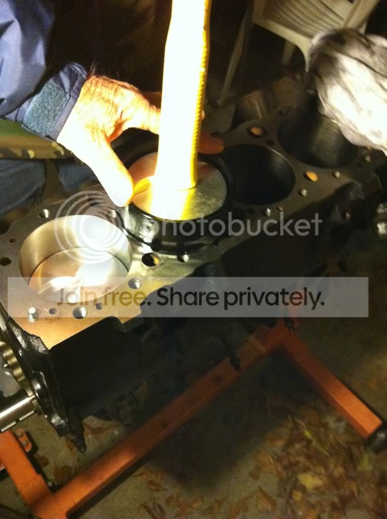

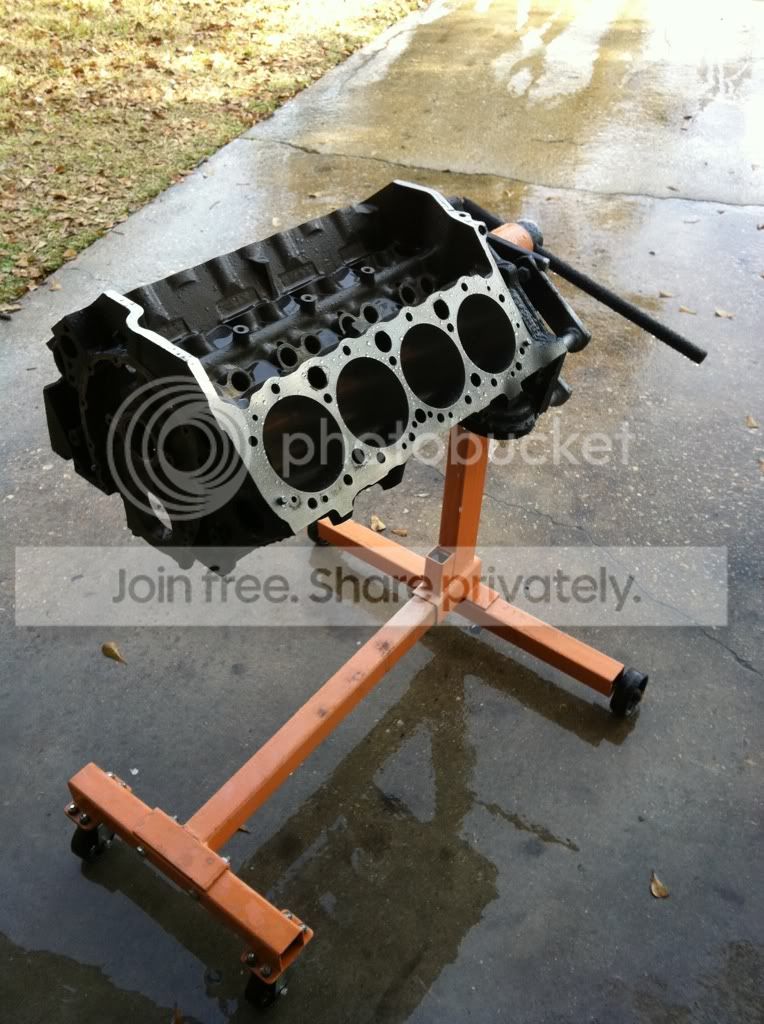

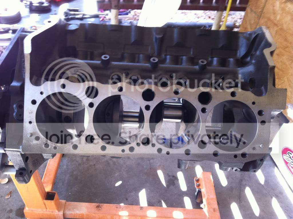

Block was bored .040 to clean up the damage. Scrubbed it down and blew out all the passages:
Put in the Scat cast stroker crank and Plastiguaged all the journals. Checked the thrust clearance:

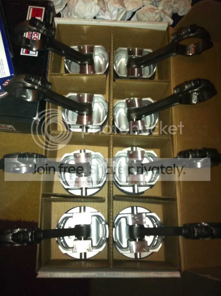

Checked all ring gaps and piston to bore clearances:
Assembled the forged flat top pistons and fought the damn wrist pin retainer spiral locks - those were a bitch and then realized that each side gets two of them:

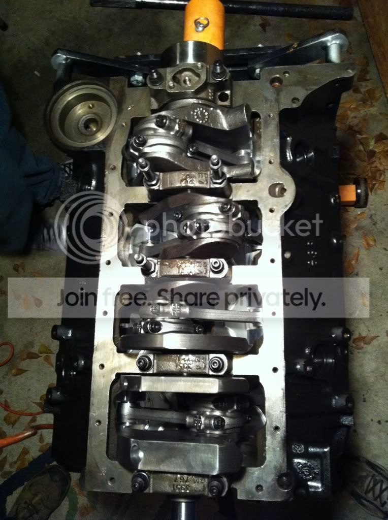

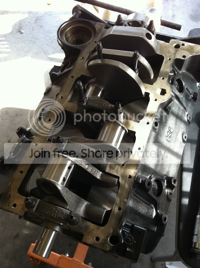

Got the pistons in and the rod caps plastiguaged and torqued .:
Checked for rotation clearance - the machine shop did a good job.

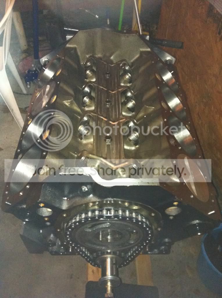

Put in the cam and timing chain and again checked for clearance:

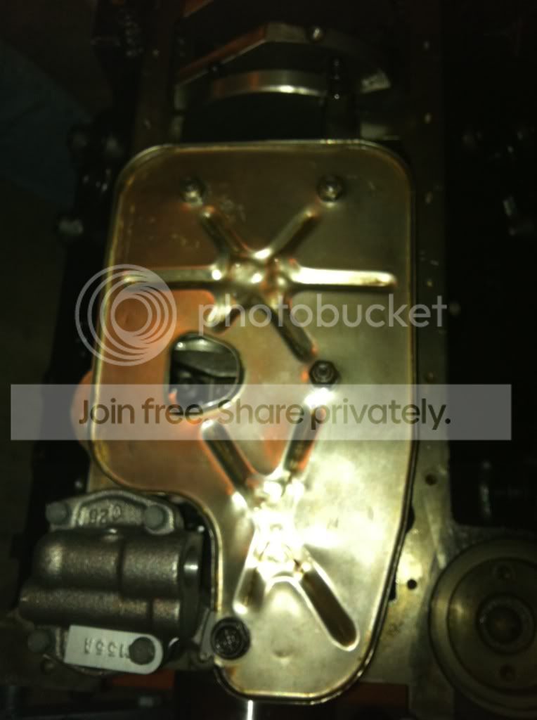

Had to "massage" the windage tray due to the rod caps hitting:

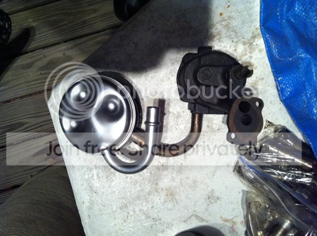

The only real issue that I encountered so far is that I will have to reuse the oil pickup tube. The Melling oil pump kit's tube is too short:
I think that I am going to make a metal strip to hold the pump pickup to the oil pump. It possibly falling off scares the hell out of me.
Did you buy the right one? I bought the Melling 55-S3 and it is exactly the same as the stock one from my '86.
The oil pickup should be identical to the old one - if the new pump is correct just order a new pickup (~$10).

Spoke to the supplier earlier (they called me) about the pickup. I'm just going to find one locally or reuse (it's clean - why not). I purchased the Melling M55a (his recommendation). No big deal.

Speedway (among other places) sells a bolt-on oil pump retainer - cheap insurance if you're not going to weld it...
If I am using a stock pan and pick up tube, I tack weld it good. But most of the motors I do end up using something like a Canton oil pan and pick tube that is designed to bolt to the pump. You want to make sure there is no way the pick up tube can fall out. I have seen it happen before... not a good thing!

Thanks guys - didn't know they made a bracket - sweet. $15.00 shipped - just found one online.
