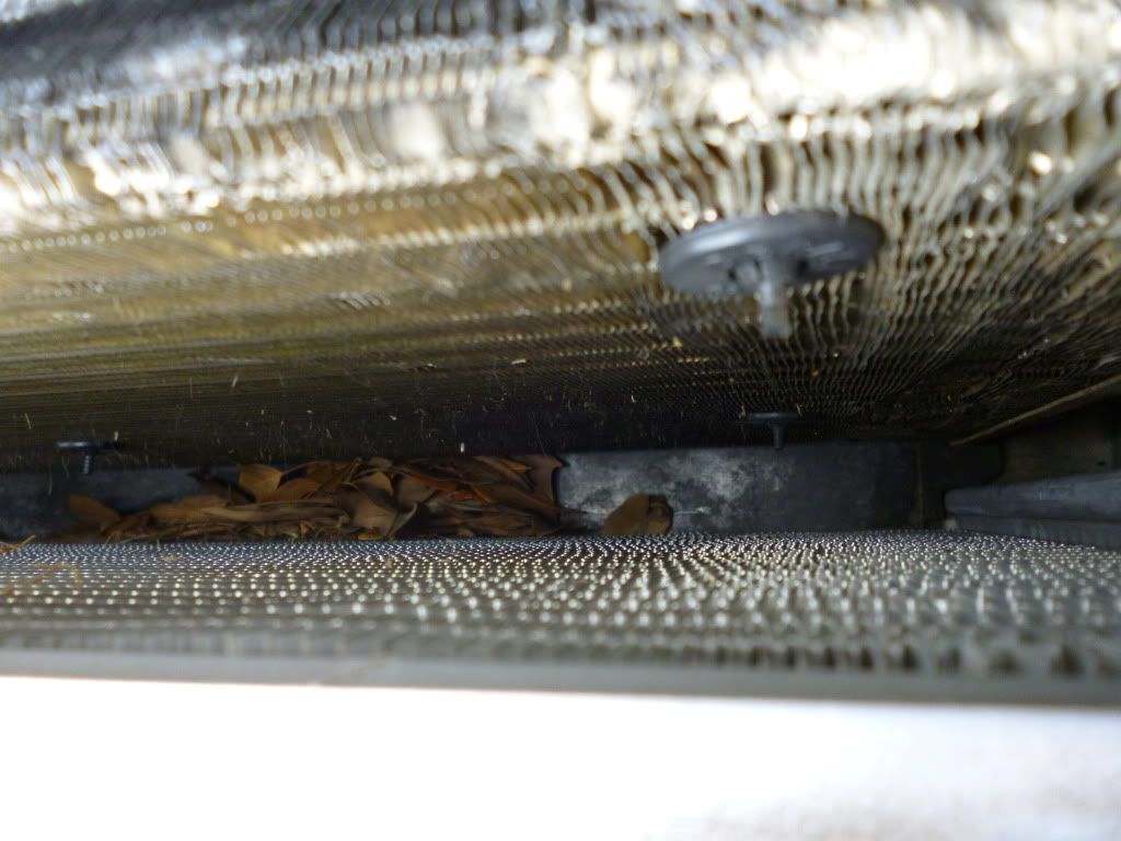

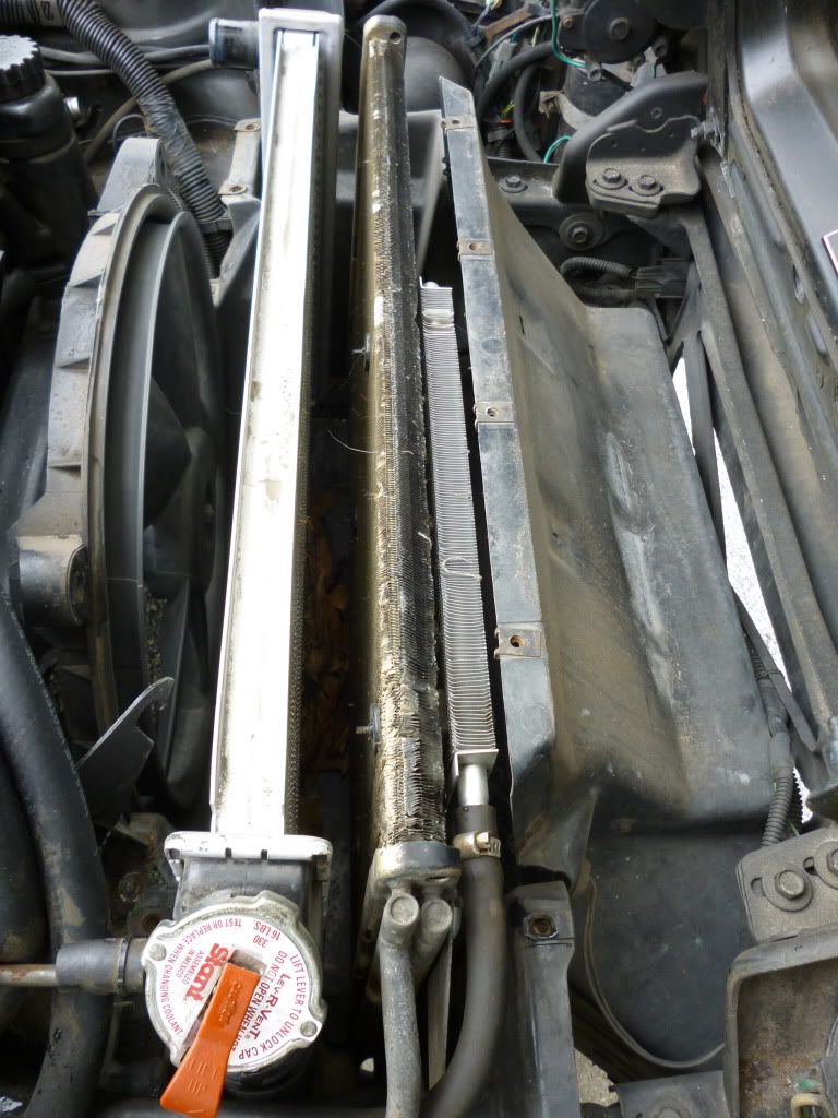

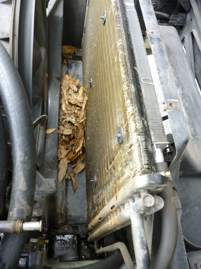

Originally Posted by surfer93
I am now sure my car is possessed and what is possessing it, hates me.
Went to check the fluid and it was full, but car is still overheating, which has never done till I had the coolant loss problem.
Front of radiator is clean and it has new coolant and thermostat, so I am down to the WP going out AGAIN or whatever is possessing my car is trying to drive me to the lunny bin.
Ahhhh..... but have you cleaned in-between the radiator and the condensor lately. The pics below are debris that collected after ~2 years (~10K miles) of drive time.
