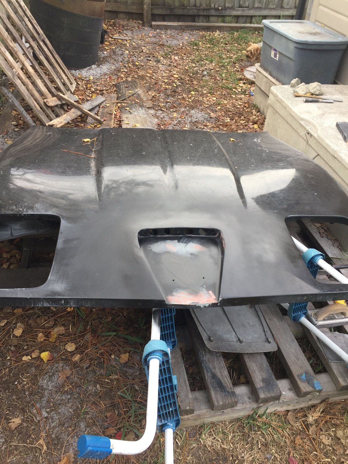

Old May 15, 2017 | 08:53 PM
  #43
gman35's Avatar
gman35
Joined: Nov 2008
Posts: 1,159
Likes: 31
From: Orange Park Florida
Hey, the hood is finished and still in my backyard. When I layed it out and cut the hole it came out right where it needs to be to fab a piece so air would go in front of the maf sensor. I have a breatless performance ram air system that would be easy to pipe this into the top of this hood. The faux trim is removable which turns it into ram air... or stops rain from going into it if needed. What do you think.. thanks, gary
